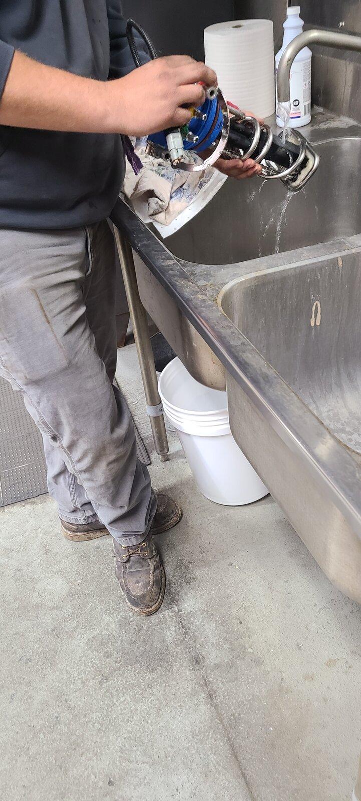

I don't know, but would guess it may be a little longer than that. Most DEF modules do not have electric heaters working immediately to thaw out frozen DEF. Many have coolant lines circulating through, like this module off of a QSB6.7 and would probably take a little longer than an electric heater. The SS lines wrapped around the module are coolant lines.
