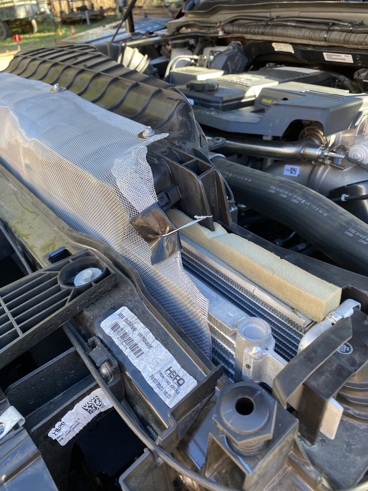

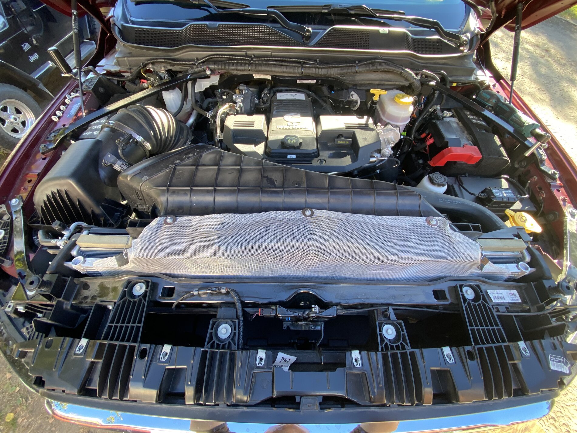

My 23 had lots of bugs and bigger debris in the air box compared to previous trucks so I started investigating. I always add an aluminum screen over the from if the rads coolers and on this truck, I pulled the air intake cover off and covered it too. Solved the garbage in the air box issue. Just have to check it occasionally to make sure the screen doesn’t have to be cleaned off as well.
Oh, also saw mouse tracks under that cover in the entrance of the intake scoop!!!

View attachment 141367 View attachment 141368
Good idea
I wonder if you’ll have regen issues with that considering how sensitive the CGI motors are to air filters and flow.
Good idea
It’s been on since October last year, no issues yet and I do heavy towing drawing allot of air/boost. My average fuel economy yesterday was 6.3mpg/37L-100km driving for 3 hours straight into a harsh headwind at 30,000 lbs with the boat on top of the truck and 33’ toyhauler behind.
That scoop is very wide and about 3” tall, so that’s a massive area to draw from compared to the 5”ish pipe feeding the air box.
