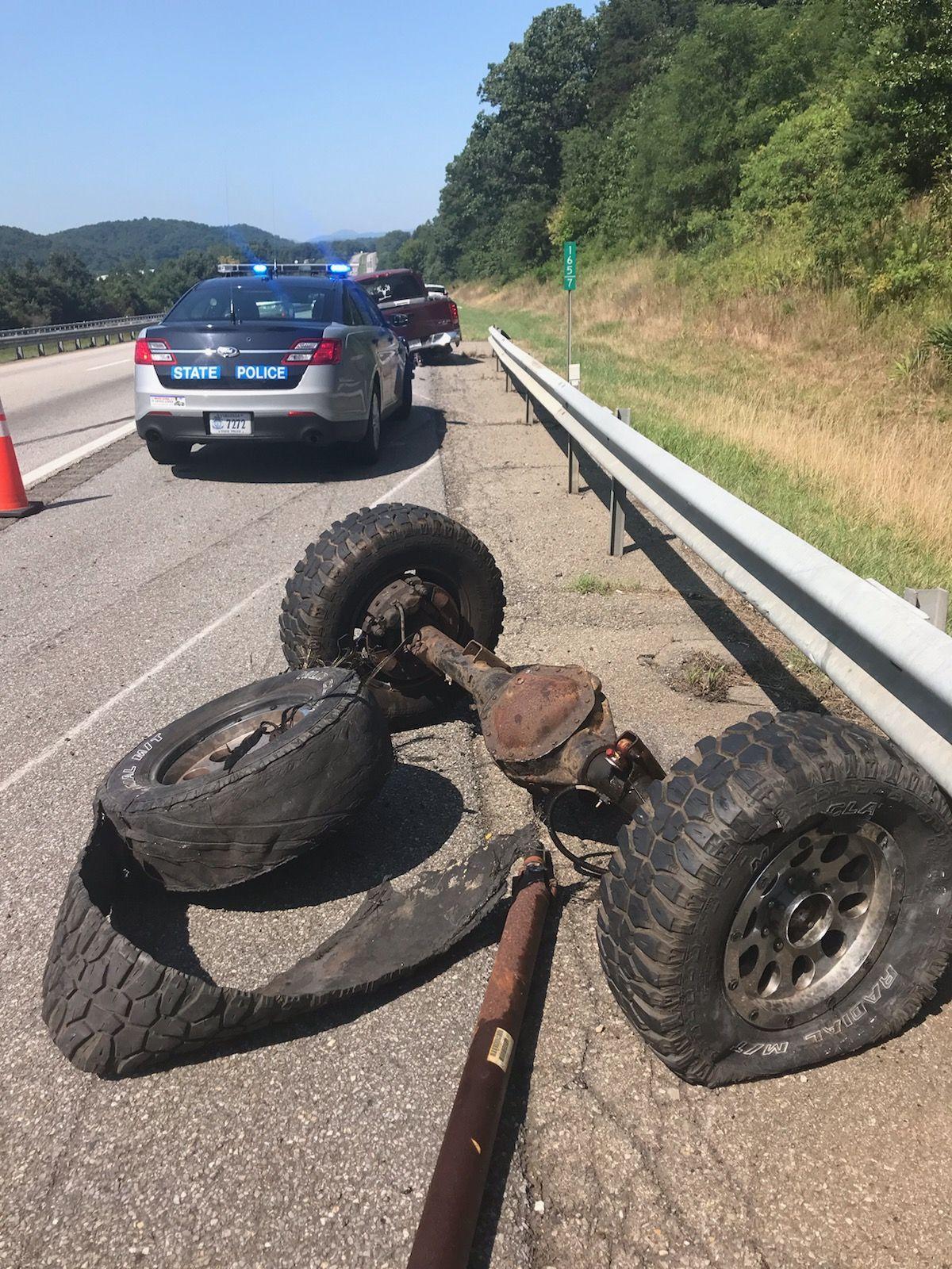

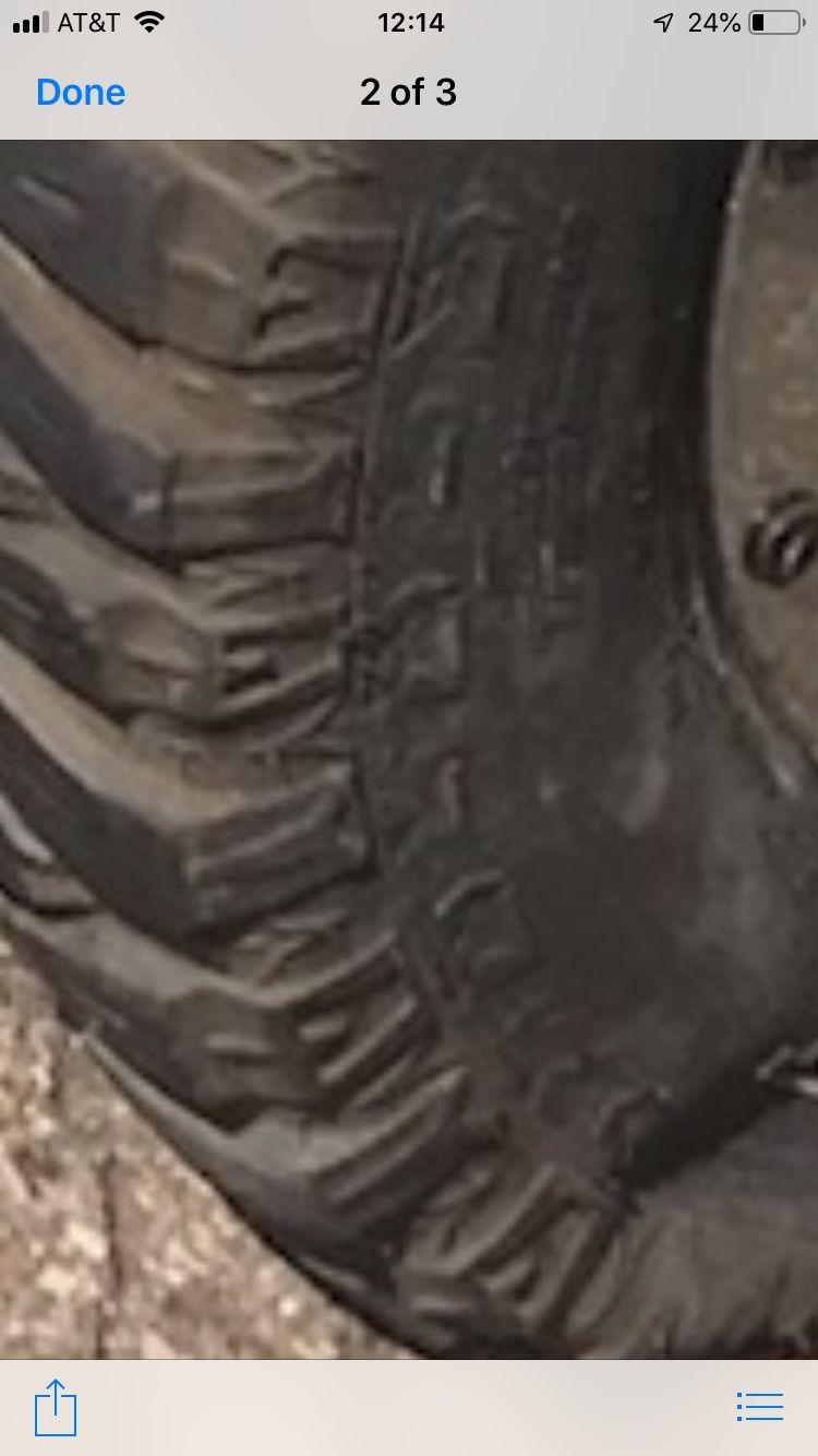

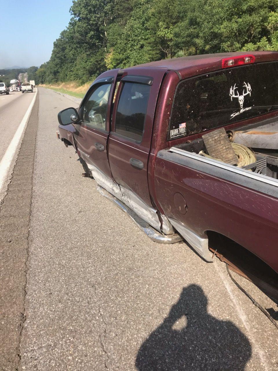

My buddy sent me this yesterday. I have no info other than what can be gleaned from the pictures.
It appears to me that he was running recaps (I’ve been seeing these pop up on the inter web as “reconditioned” tires) all around, and let loose a road gater on the steer.
Thoughts?
Retreads don't explain the front wheel AND the entire rear axle coming off.
Either that truck should have been condemned long ago or someones shade tree mechanics license needs revoked :D
Wonder if there was a simultaneous front blowout and a catastrophic cardan joint failure at the transfer case causing this? Wayne M. did not mention any trailer accompanying the truck.
My guess is the left tire lost the tread, that tossed him into the left guard rail and ripped the wheel off. The same guard rail then ripped the axle off after blowing out the tire. The pieces and parts were probably placed where they are, to clear the roadway.
I reached out to my friend to see if the location is available.
It’s pretty obvious that the front tire unraveled, got jammed up, tore the whole wheel/ hub off, possibly the rear tire running over the gater, etc. the body damage is quite telling!
I don’t know about the vehicle inspection laws in VA, but I can guarantee that recaps are illegal on the steer.

It was 81 in VA.
Might want to recheck your laws.
They are illegal on the steers of busses, and not recommended for anything else with a rating per tire of 4920lbs or less. Not recommended does not make it illegal.
You’ll want to refresh with 49 CFR 393.75.
State laws may vary, so really only federal laws apply as a blanket statement.
