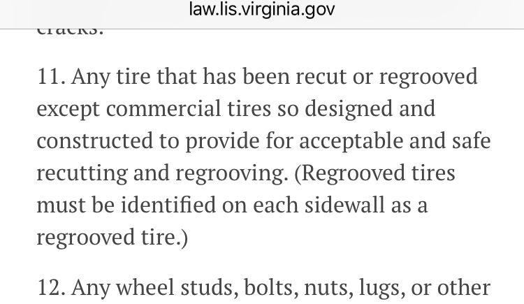

I don’t know how accurate that is. I’m sure the state you’re operating in has jurisdiction, and those laws probably apply. In Virginia, no recaps at all, ever, unless the tire is commercial and says regroovable, and the tire is ID as recapped. Commercial truck tires are, and would be.
I don’t think a commercial tire exists that’s smaller than 19.5.
Do you have a link to that? The screen shot doesn't say enough to have any context to the law.
I've also looked thru NYS laws and so far cannot find anything prohibiting retreads on a steer axle. Not saying it's not there, just can't find it. Do you have a link?
I do know of commercial tires smaller than 19.5's that come in 17.5, 16, and 17" treads.. but they are not common, nor do I recall if they have regrooveable written on them.
I know the 19.5's I had were stamped with re-grooveable, and if re-grooved would be legal for steer axle use... which goes back to your original guarantee... it just isn't so.
EDIT: Found that verbiage in VA laws.... yes, any standard tire cannot be regrooved, but that's not your original statement. You guaranteed us that it was illegal for a regrooved tire to be on the steer axle, which is not true... even in VA laws. If the tire can be regrooved it can be ran on the steer axle if it's not a bus or over 4920 lbs/tire rated.

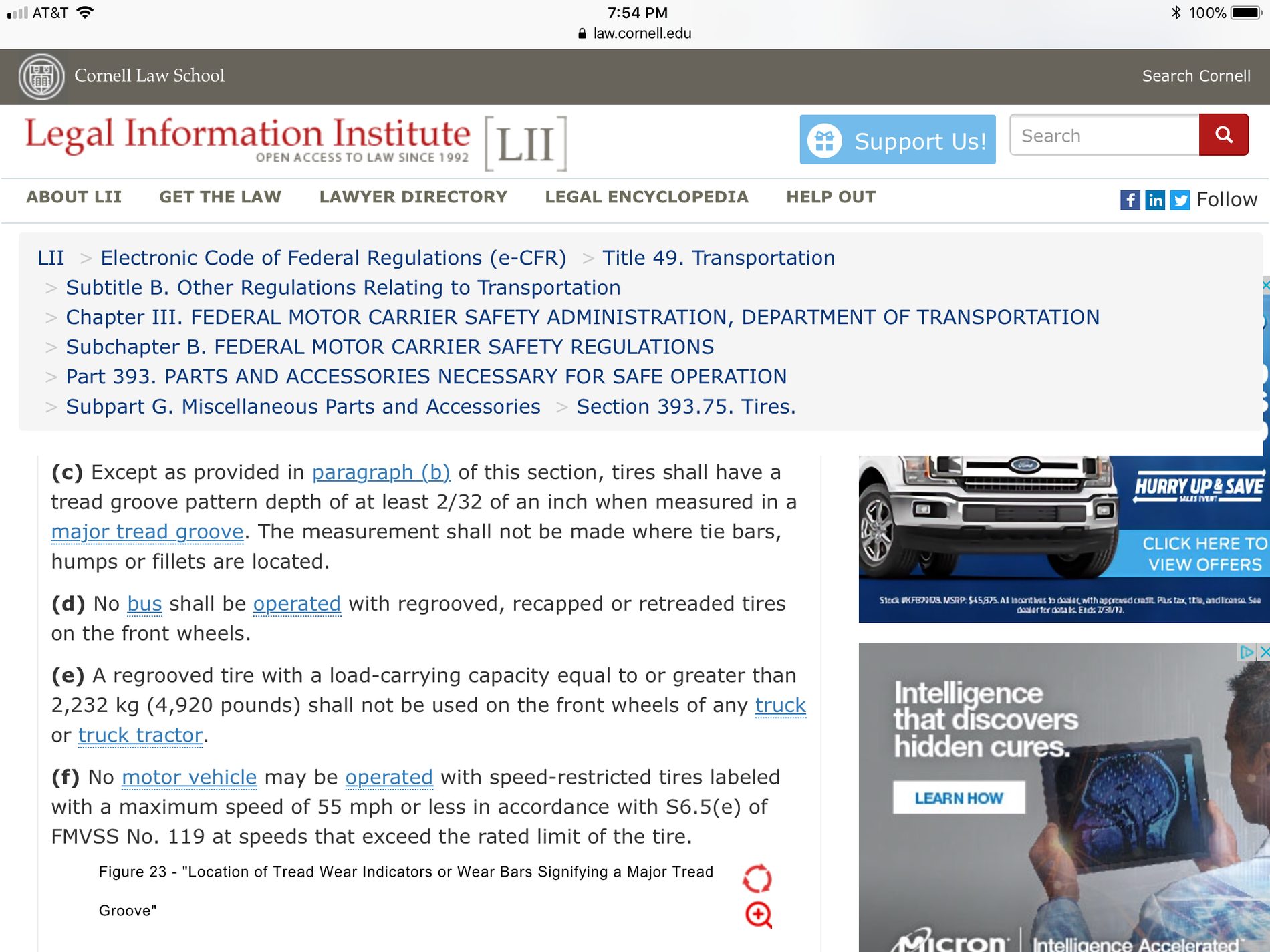

Might want to recheck your laws.
They are illegal on the steers of busses, and not recommended for anything else with a rating per tire of 4920lbs or less. Not recommended does not make it illegal.
You’ll want to refresh with 49 CFR 393.75.

Well it seems that they’ve walked back recaps on the front. And it must have been recently. The regs I have at work call for a rejection, and I do still check. It’s been a dog’s life since I’ve seen a recap on a steer on any vehicle, and you really have to be insane to let it happen. Therefore, I haven’t needed to reject one.
