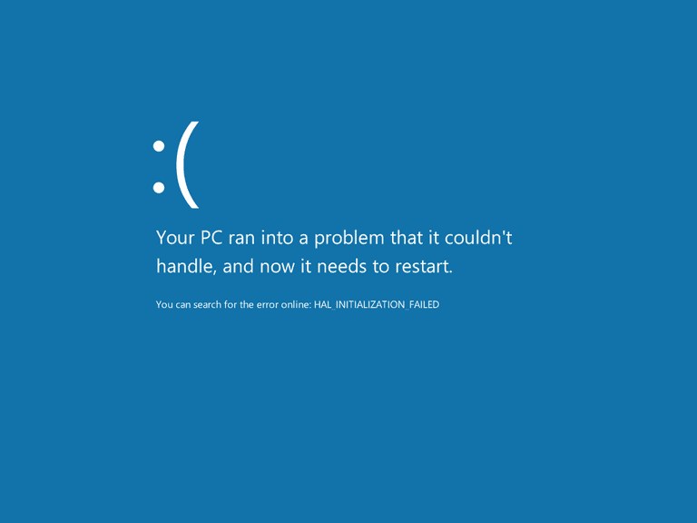

Went through several wacky scenarios, and is basically locked up. I knew the tech stuff was a gamble going in. As long as the AC keeps working, it's just a bump in the road. I was going to schedule a visit anyway, as the "soft opening" tailgate just crashes down, and the right cable is much shorter than the left, so it takes all the load if you place weight on the gate.
On the CF forum, 2019 general discussion section, there is a thread about your situation that has interesting info......
sam
especially the BSOD.
These new radios run on Windows? :) :)
