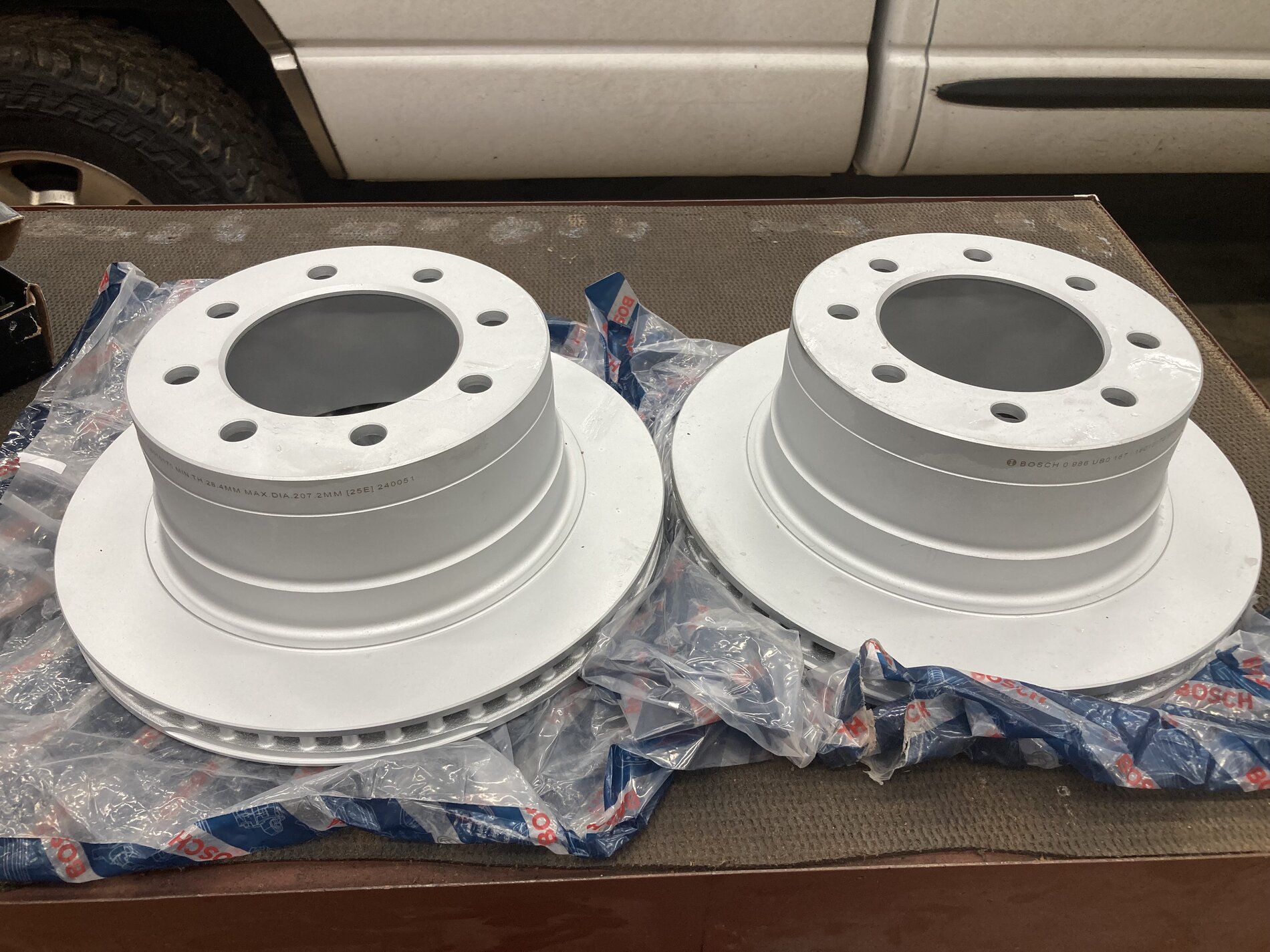

That said, I got home and the Bosch Quiet Cast rotors were waiting for me outside.
They are REALLY nice looking and of course heavy...with some sort of coating to keep them from rusting before install and likely to also slow rust on the non used surfaces....which is nice, cause the boxes were completely soaked from the rains and the rotors still look great.

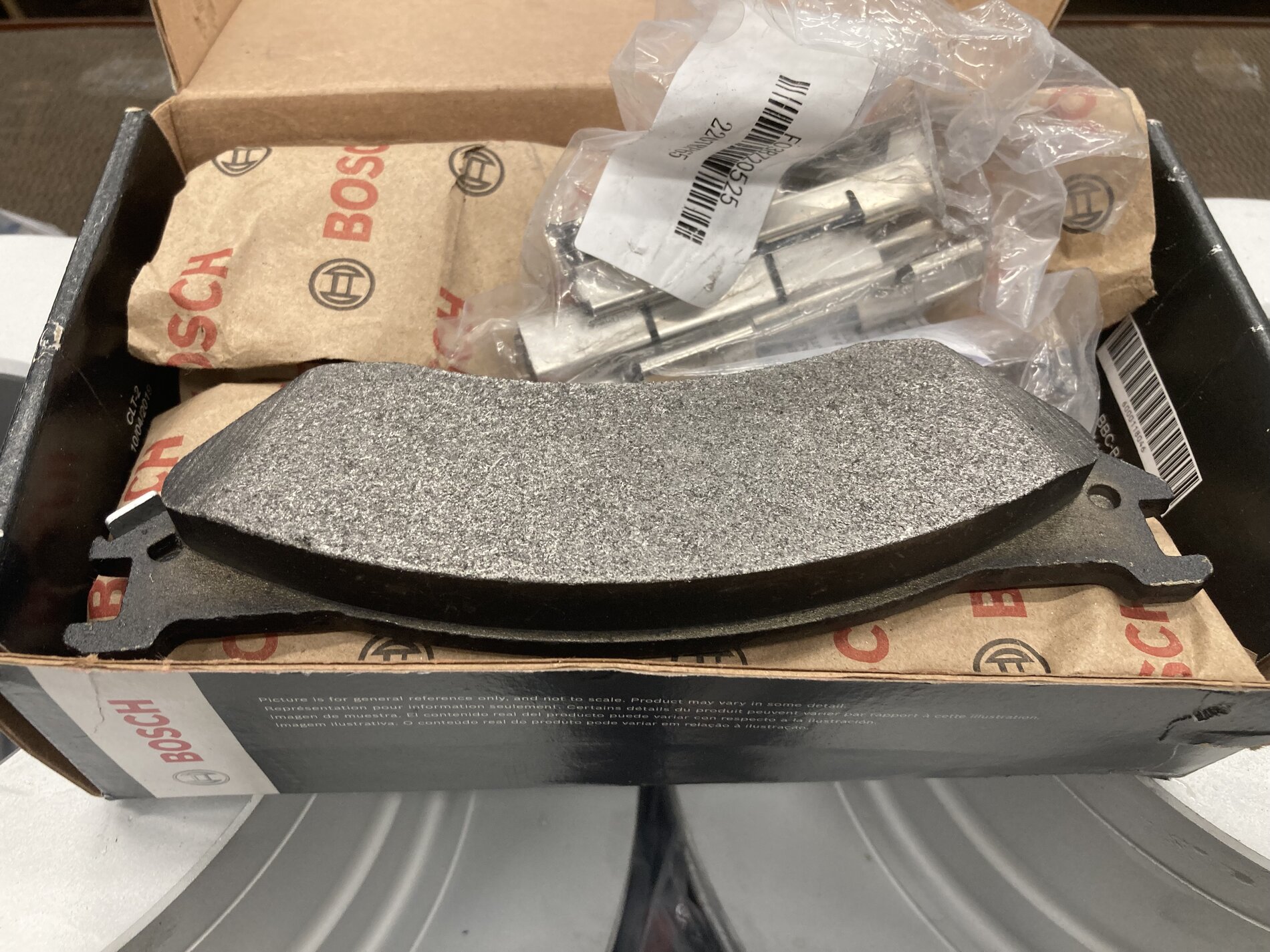

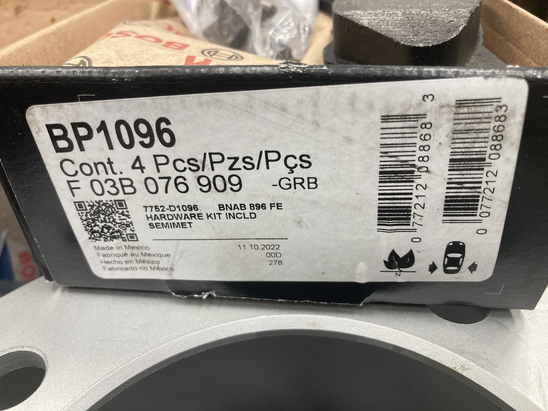

The pads certainly look fine, though obviously looks have nothing to do with a brake pad...like I said, I went with them simply hoping that Bosch did a good job engineering the pad material to work well with their rotors. The Bosch pads were only $45 for the full axle including new hardware and some silicone grease, so as long as they work quietly wit minimal dusting and good stopping, that price really cannot be beat.

Phew...FINALLY had time to get the rear brakes done this weekend.
Took about 10 hours total working time but that includes replacement of the rotors and pads, caliper mainatenmnce as well as replacement and adjustment of the parking brake shoes, as well as 1 or 2 mistakes. ;)
There are DEFINITELY some important details to tell you guys about, so as I have time I'll start a new thread with a write up and pics.
In the meantime, here are some pics of the rotors and pads I used, part numbers listed above

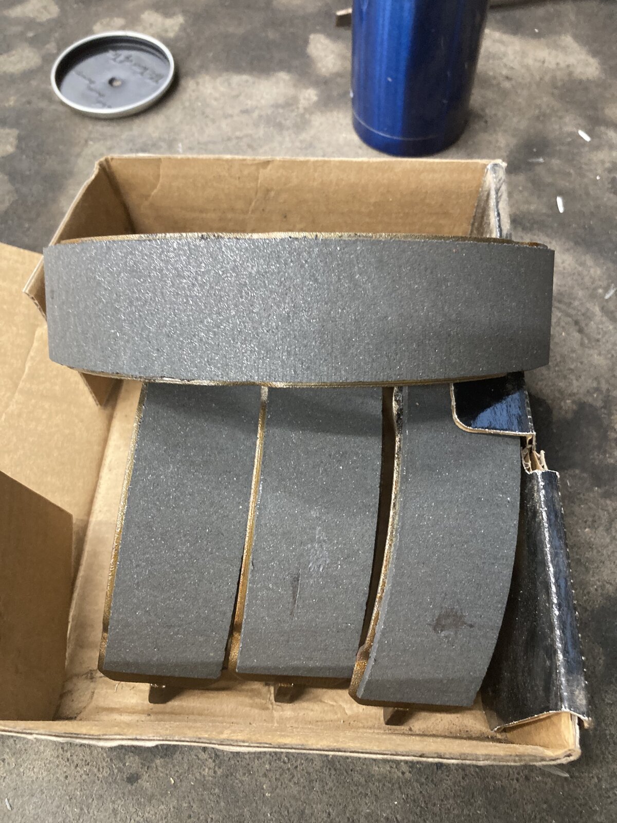

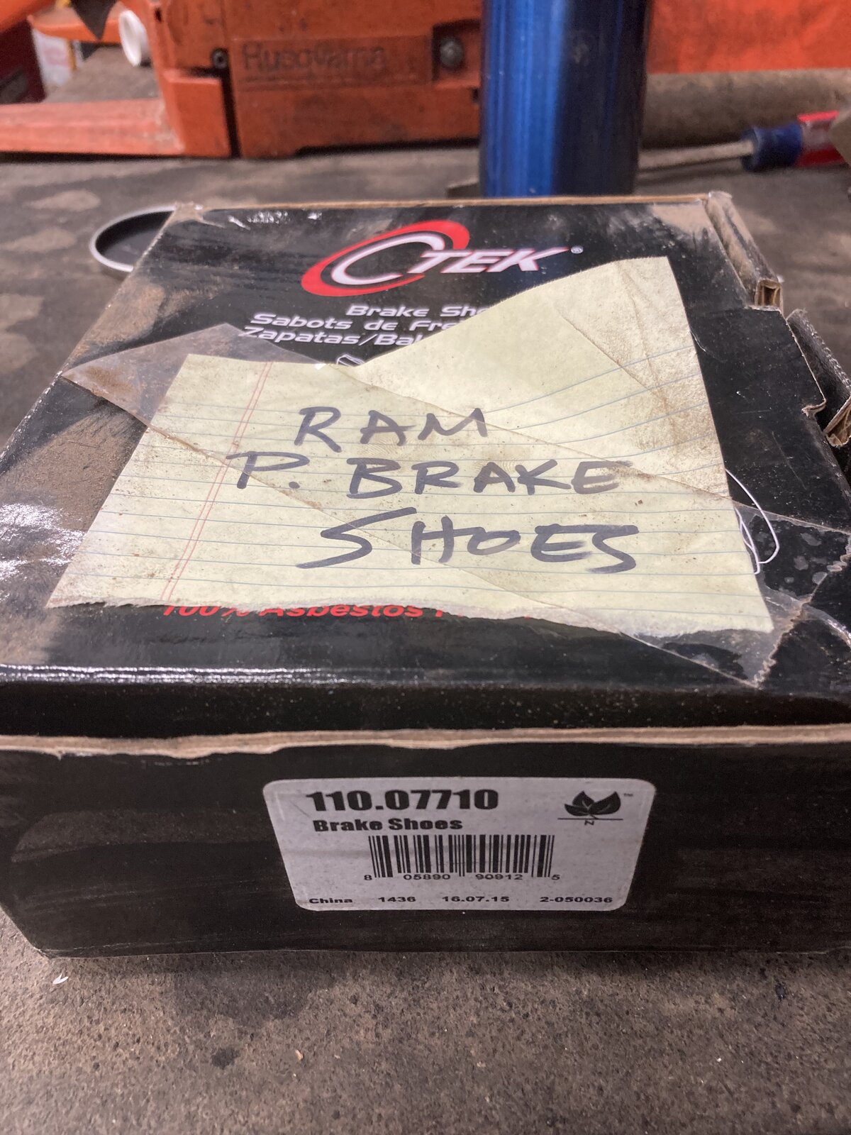

And here is the parking brake shoe kit that I used because I already had it laying around, having been giben it by another member some years ago.
That said, and NOT that it matters, Bosch ALSO makes parking brake shoes for our trucks == Bosch #BS771
NOTE -- My kit, and the Bosch kit, do NOT include ANY hardware with it... which was fine since I live in a moderate climate with no salted roads and all of my oem hardwrae was easily reused.
However rockauto sells parking brake hardware kits, as well as other parking brake parts, for our trucks, as needed.
