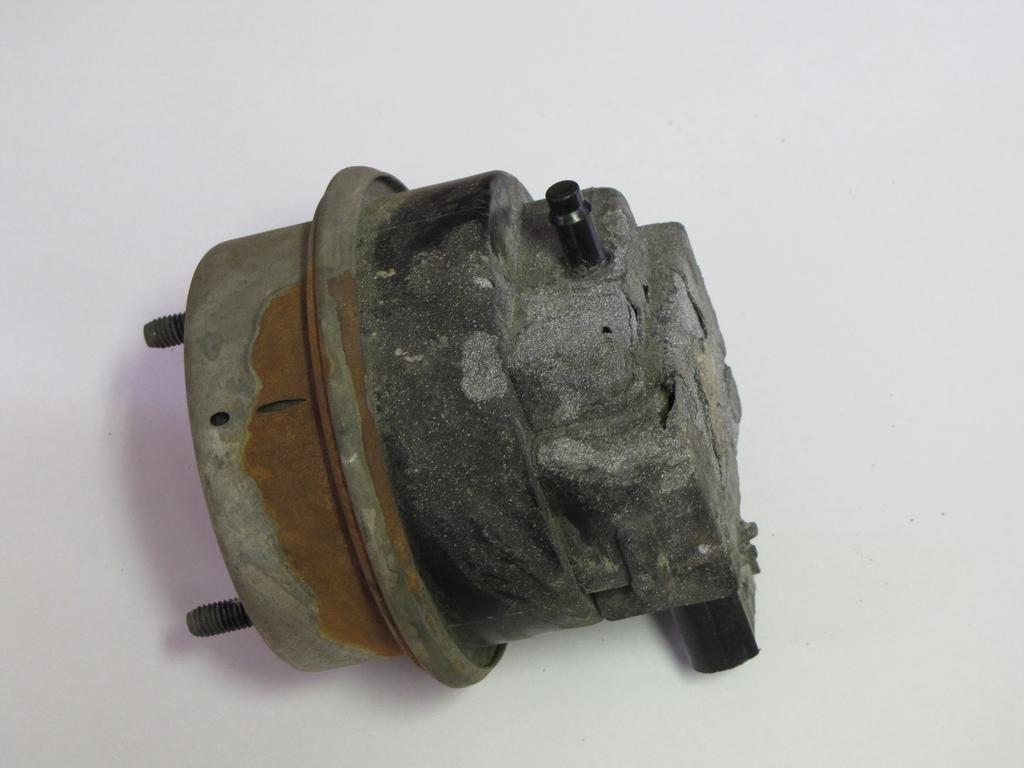

I got it fxed. Followed threads from way past and ordered a new servo fromMac Haik, $91+. When it came I went thru the ordeal of pulling the riverside battery and tray to get at things. The hardest part was disconnecting the electoral feed. The vac line was good, already fixed that a long time ago. Found the serve badly corroded. The plastic parts eaten away with a largo hole. Replaced the serve, after cleaning and painting everything that needed it. Let dry overt nite and reassembled it today. Test run good. If I can figure out how to post pictured of the old servo
i will.

Lessons learned. After driving with the new servo I noticed something. It respond like it did when new. So if your cruise control starts to respond erratically, come on quicker, stumble or require tweaking, it might be the servo starting to leak. It will only get worse so it is time to bite the bullet and replace the servo/
