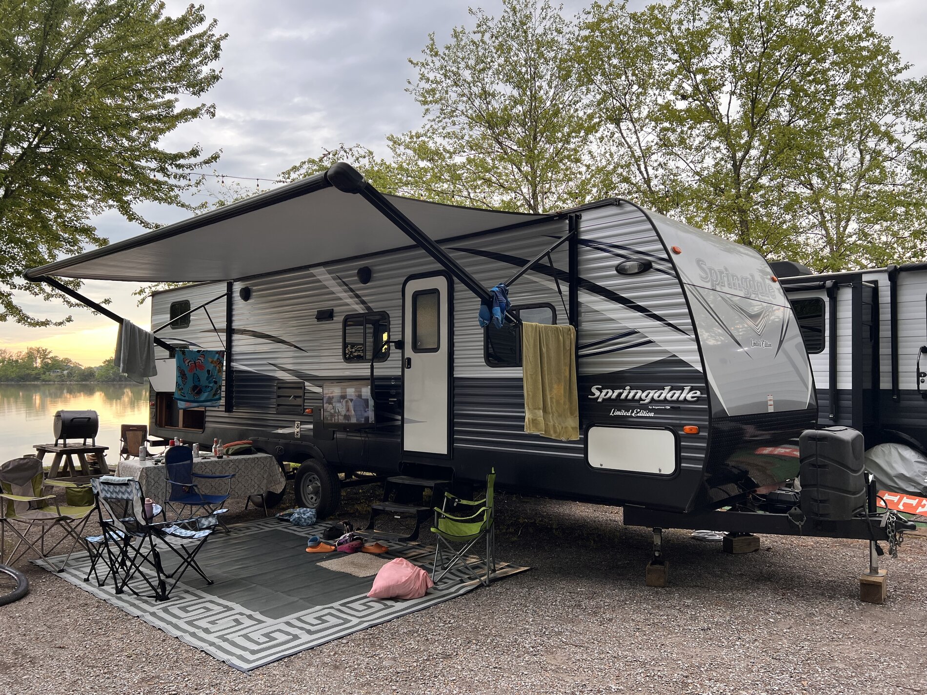

Just to give a little update.
We took our first trip this past weekend. It was about an hour and a half away. With the weight distribution the truck seemed to handle the weight pretty good and I had no problems slowing down. I took it easy getting up to speed. The truck would hold in 5th gear at about 2500rpm at 60-65mph on flat ground. Any hill would drop it to 4th at about 3200. Bigger hills was down to 3rd and running about 4000. We averaged 7.5mpg. Overall it wasn’t terrible, but not very relaxing lol.
Sunday on the way home was pretty bad. We had a 20-30mph crosswind. It really slowed me down and I couldn’t use 5th gear on the flat parts. We got 6.3mpg on the return trip.

We had a really good time with the actual camping part. It took me about 30 minutes to set up once we got there. I have used my parents camper some in the past and had a little experience with getting everything connected so it wasn’t too big of a deal. We’re looking forward to the next trip here in a few weeks.
