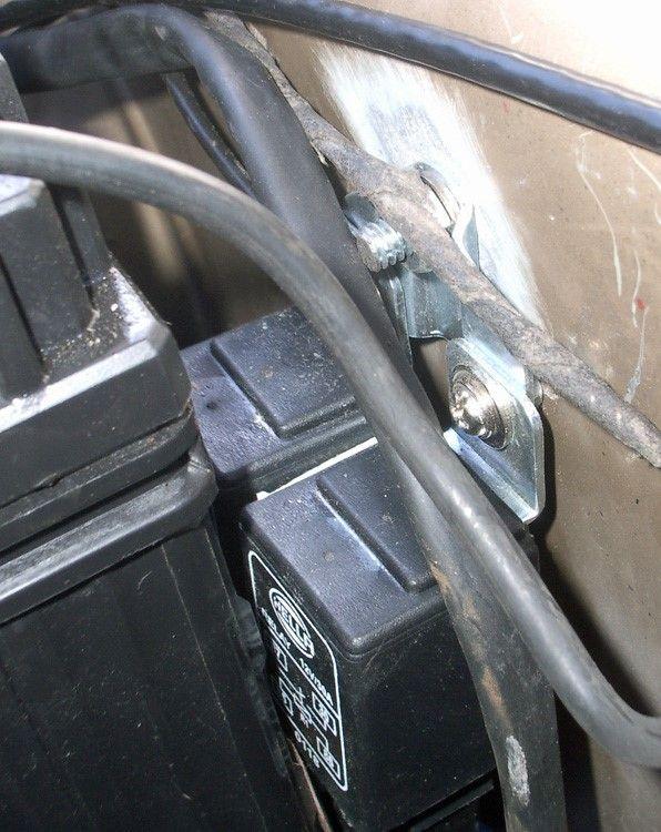

Well, I installed a headlight relay system in the truck the other day... that made a big difference there. The lights were plenty bright before, but now there brighter still.

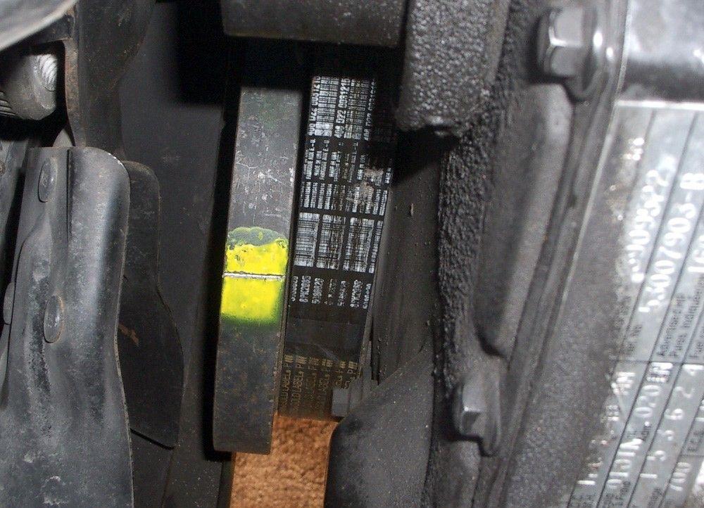

This morning I laid out some timing marks on the damper, in preparation for my next job... I'm replacing the original valve springs with slightly stronger ones, and replacing the stem seals while I'm there of course. Once that's done I'll do the valve lash adjustments.
I made (1) Bright Orange dot for TDC on cylinders 1 & 6, and (2) Bright Yellow dots spaced 120 degrees apart for the remaining cylinders.

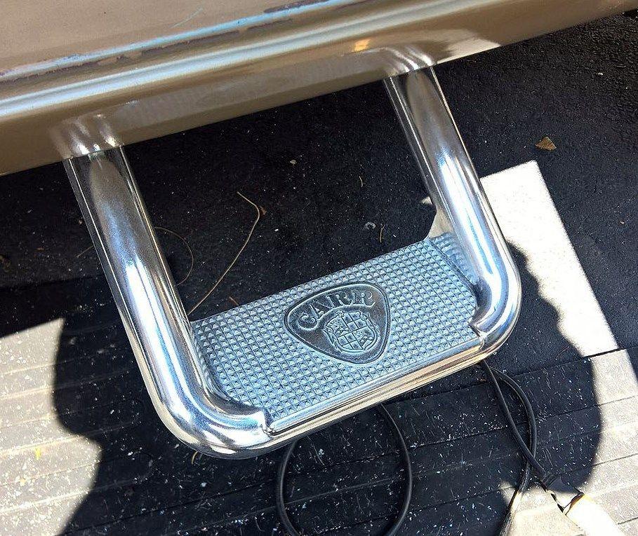

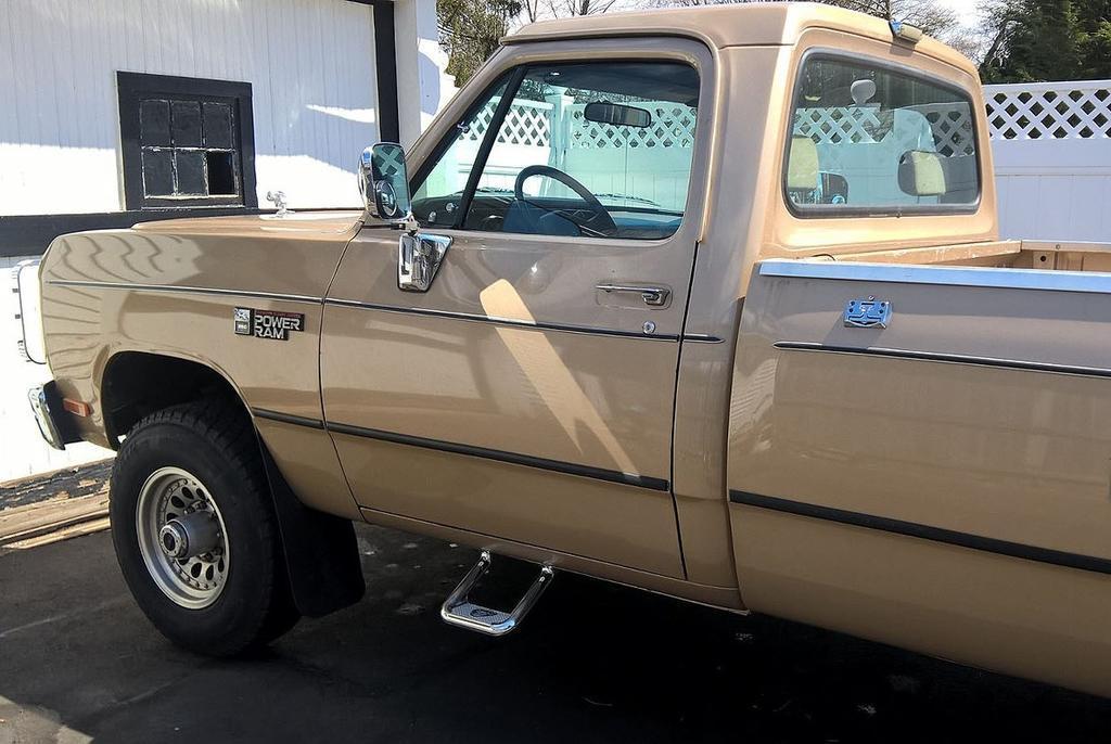

I added a set of side steps to the truck this morning. Wife has trouble getting in on the passenger side so... happy wife, happy life... At least that's what they keep telling you. :p

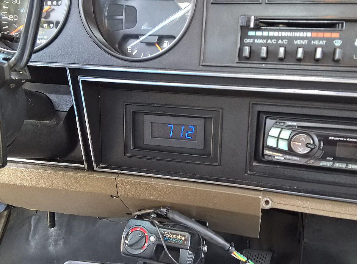

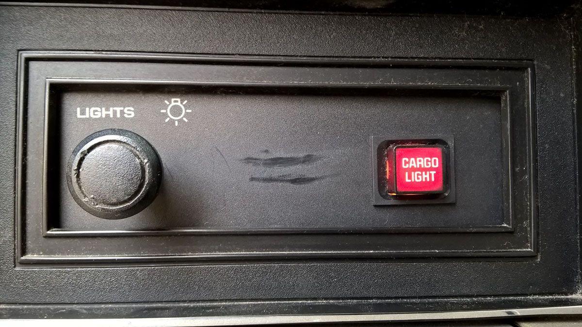

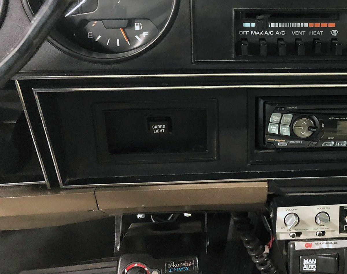

I installed a Tach in the dash yesterday.
I removed the Cargo Light Switch from it's location on the right hand side of the steering column, and put the Tach there in it's place. Then I relocated the Cargo Light Switch over to the left hand side of the steering column next to the Headlight Switch.
The Tach is a very useful addition. It's already telling me that it's time to tune up the transmission.

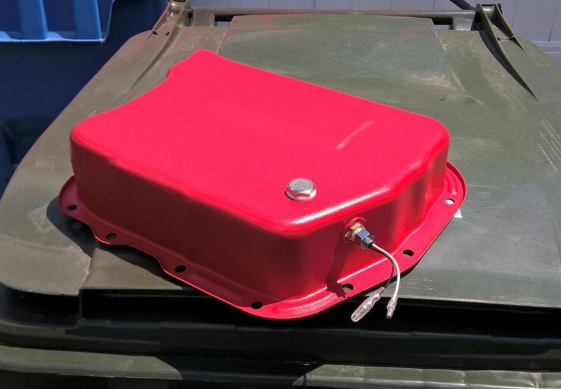

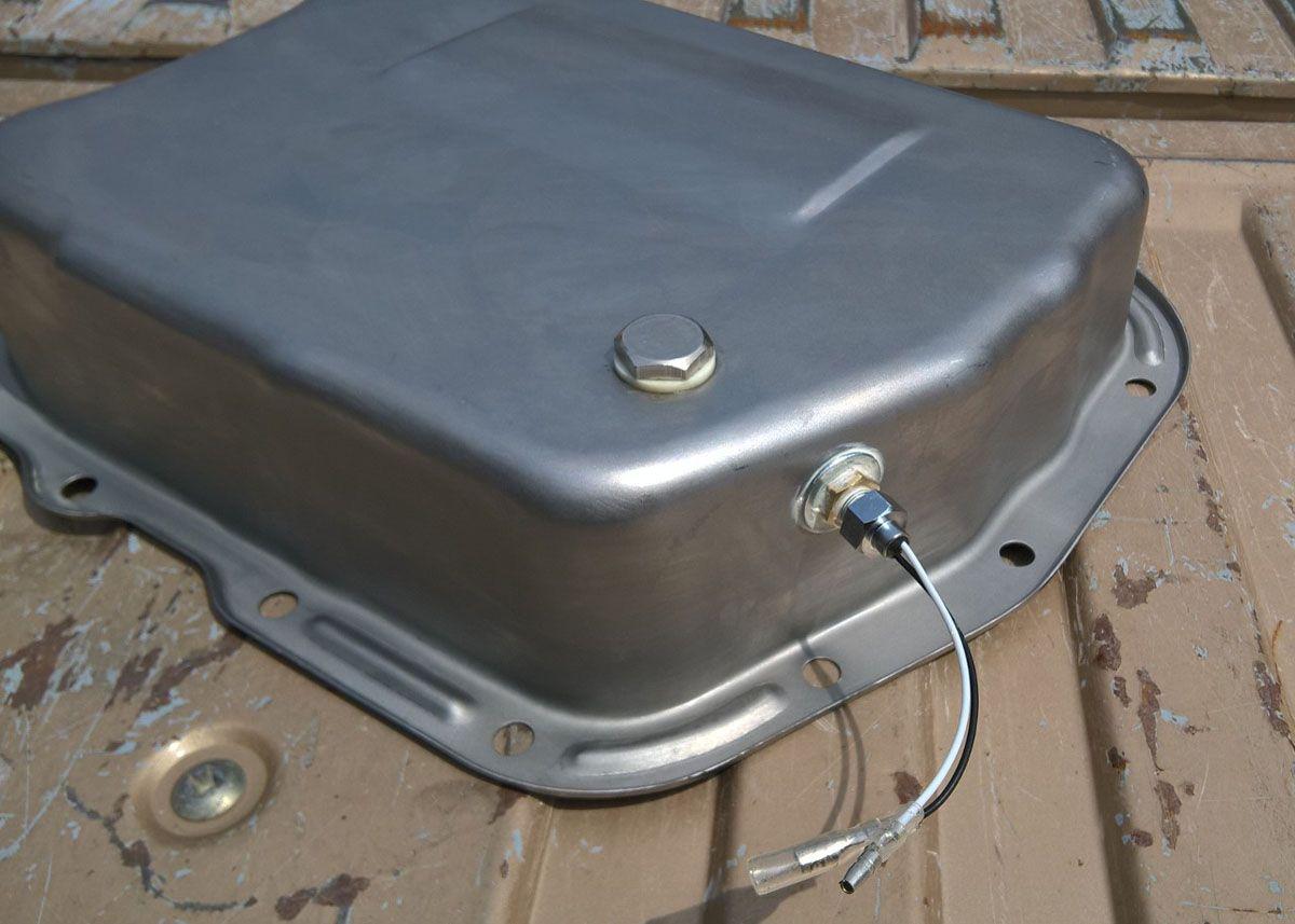

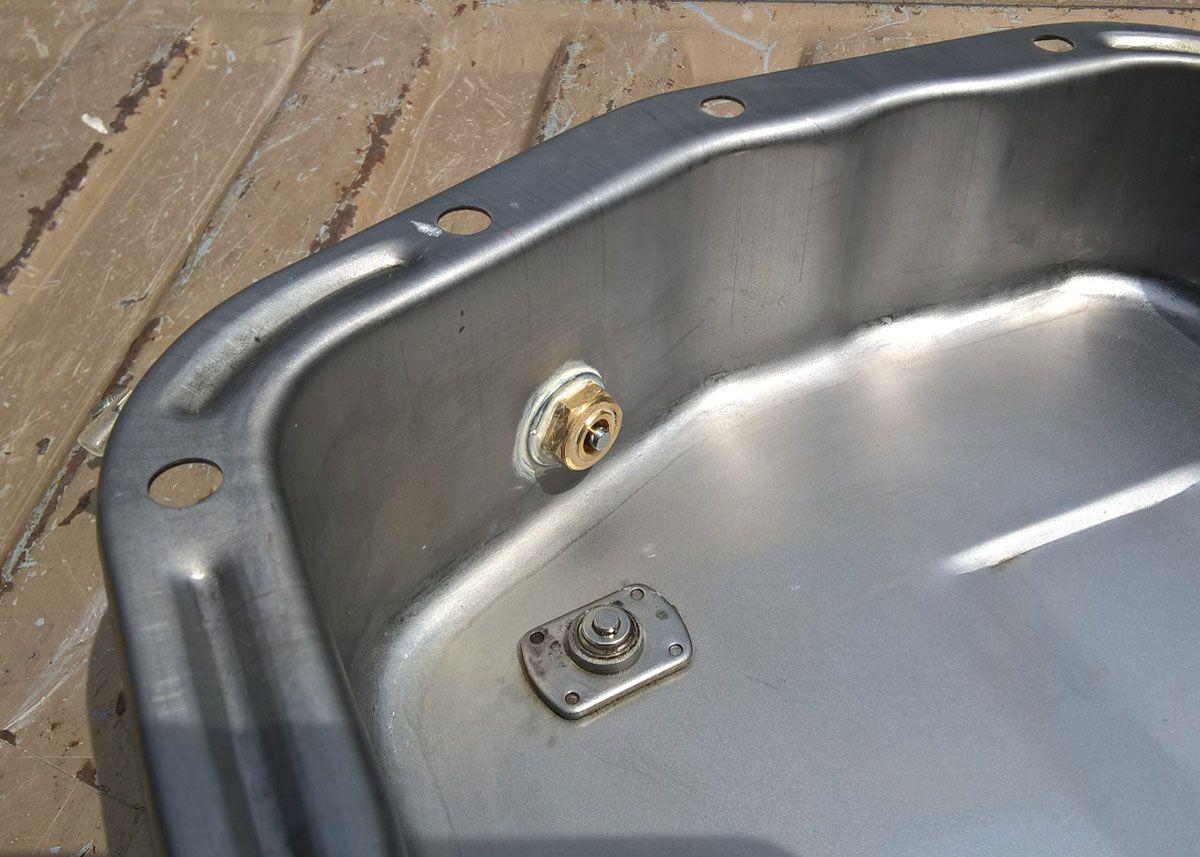

I picked up a basic 727 replacement pan from Mancini Racing the other day. I wanted something with a drain plug, but I didn't need anything to fancy. I added a Temp Sensor to the pan this morning, so thats ready to go now. I'm hitting the transmission pretty soon, so it should be installed shortly... I hope.

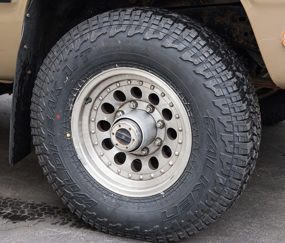

The tires that were on the truck still had some miles left on them, but one of tires had a defective sidewall. Needless to say, it wasn't a great deal of fun on the highway, so this morning I had a set of 4 new tires mounted and balanced. Glides down the highway on owls wings now.:D
Falken Wildpeak A/T 3W

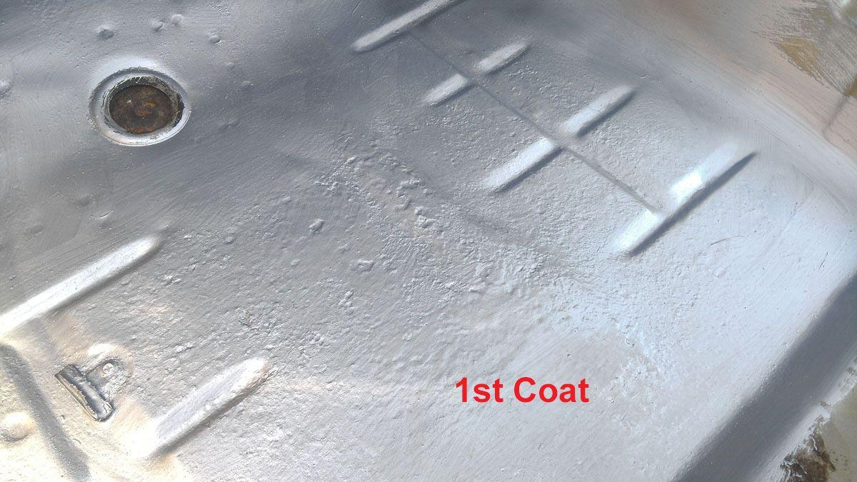

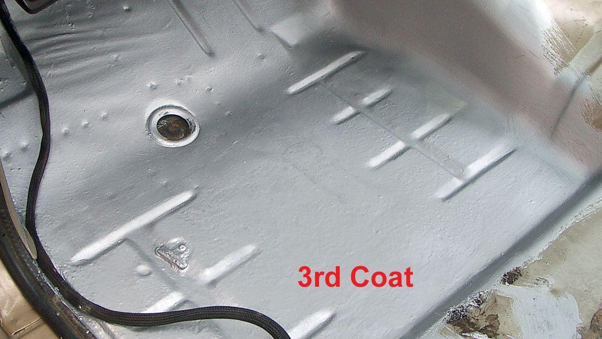

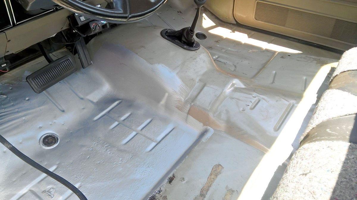

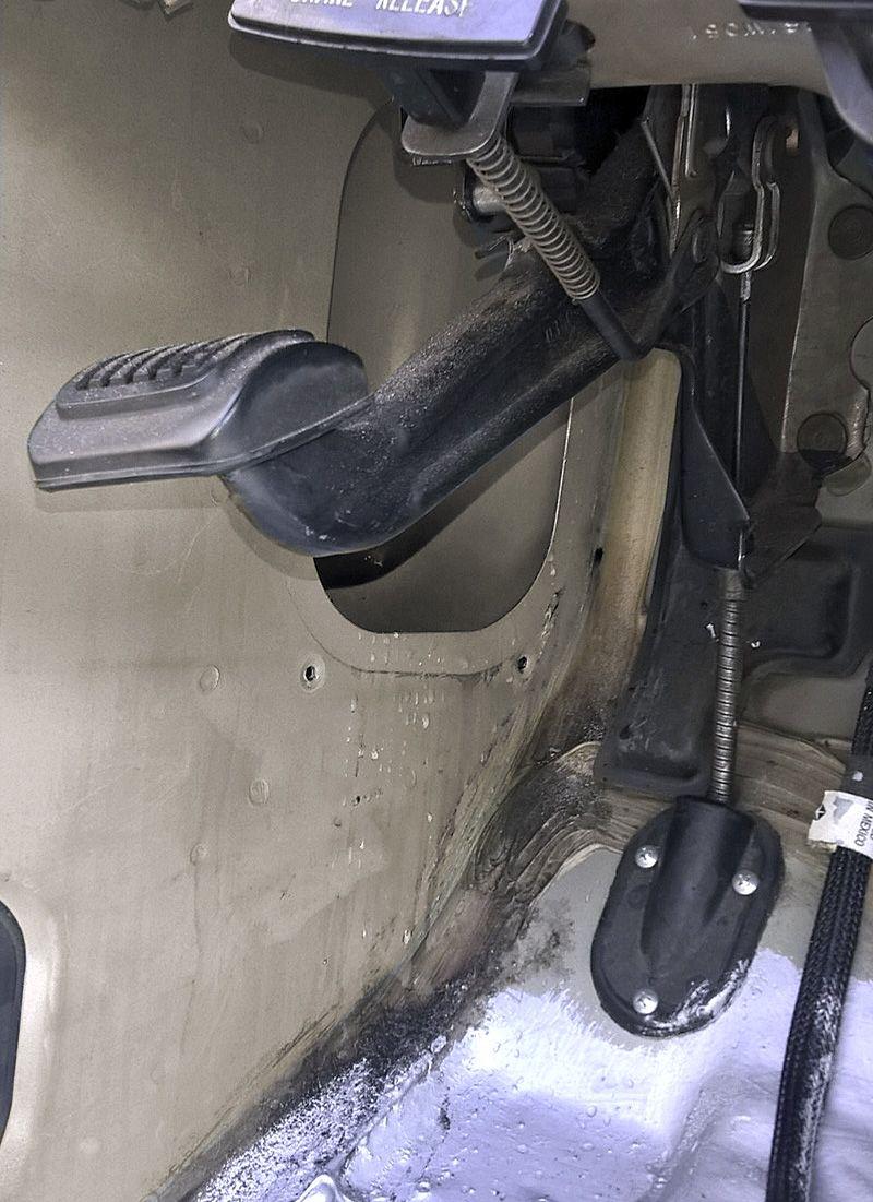

A little over a week ago, I noticed some moisture coming from underneath the rubber floor mat on the drivers side of the truck. I popped the 4 screws for the sill plate, and lifted the mat. Sure enough, the Jute Padding under the mat was soaking wet, and beneath that was a good deal of rust. I still have to locate the source of the leak, but I'm assuming its somewhere at the cowling, since it's only on the drivers side.
Either way... I pulled the bench seat, and all of the matting out this morning, so I could get to the flooring underneath. The passenger side looks like it just rolled off the assembly line, but the drivers side was pretty rough. I knocked off all the loose stuff with a coarse wire wheel on a 4.5" angle grinder. After that I cleaned it up and hit it with a good heavy coat of Rust Bullet. Tomorrow I'll add a couple of more coats of Rust Bullet just to lock it in good and strong. I'll never have to worry about it again after that... but I do still have to locate and repair the source of the leak however, before putting it all back together. Maybe I'll add some sound deadening while I have it open.
I added two more coats this morning. It's all set now!
Rust Bullet is more than 70% Aluminum, so it's probably stronger now than it was to begin with... LOL
OK... I did the flood test this morning, and the only sign of leakage was the vent opening behind the Kick Panel... it poured right in..., so that's that!

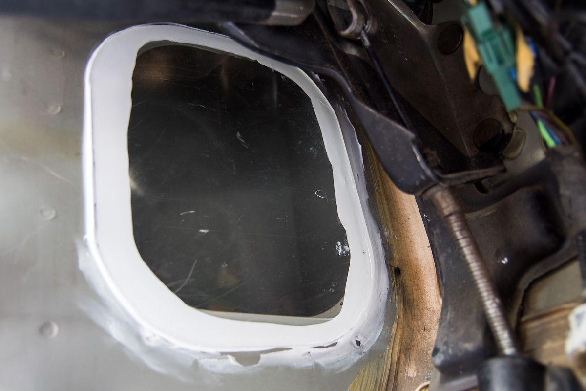

So lets see... First off... I put a temp fix on that kick panel vent leak. I cut a piece of thin plexiglass that I had laying around and stuck it over the hole. I mounted it there with 100% Silicone RTV, so it's good to go until such time, if any, that I decide to go back in and reengineer the vent so I can use it again. It would be an easy fix, I just don't have time at the moment. Since I could do that anytime in the future without having to dismantle the entire truck, I decided to just cover like so for now. I have A/C in the truck anywho...

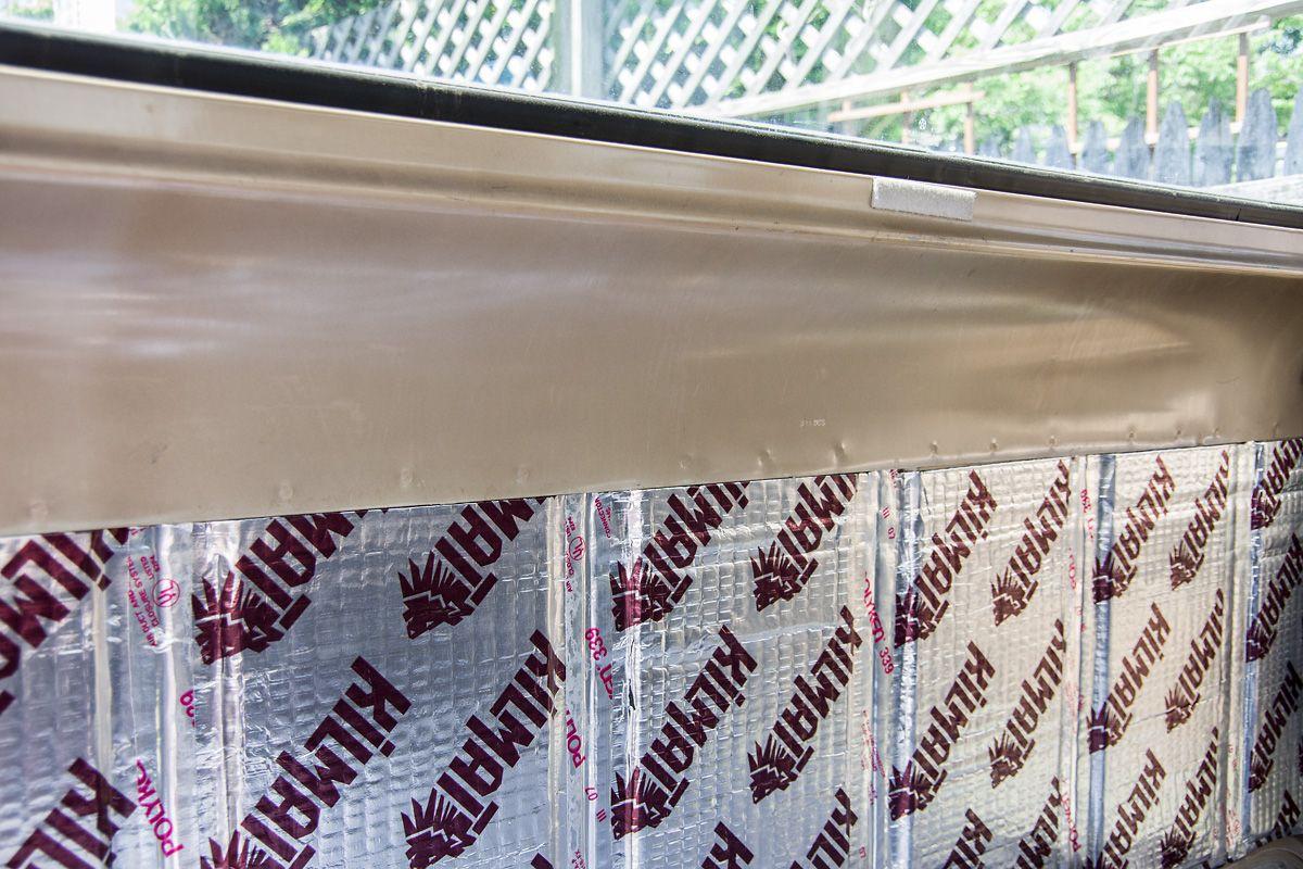

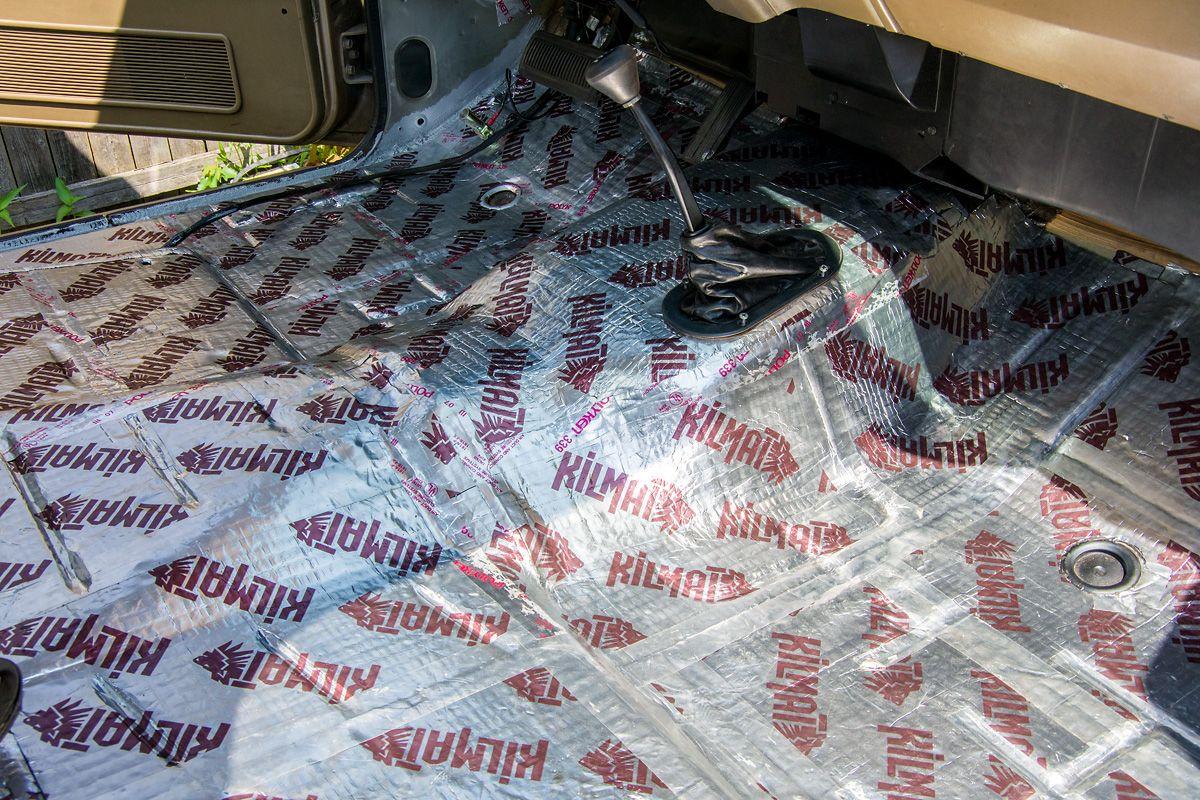

I also did a little sound dampening while I had everything in the cab out and the floor exposed. I picked up a cheap kit of 80 Mil pads that said it was large enough to cover the floor of the truck, and they were right. I still had half a box of material left over when I got done with the floor... so I did the back wall too. I still have enough material to do the roof, so maybe I'll tackle that and the doors at a later date.... but right now it's time to just put everything back together again so I can drive it again.
Big difference though, I can tell ya that! The floor pan and the back wall no longer sound like big kettle drums when you hit them. It more of a thud now, which is a good thing.

Sound dampening worked out very nicely by the way. Quite a noticeable difference, even with the windows rolled down. Oddly enough, the first thing I noticed was how much quitter the back wall was. Never really gave it much thought until now, but there were a lot of annoying sounds reverberating off that wall behind the seat. I always assumed it was the bed of the truck causing all the racket.
