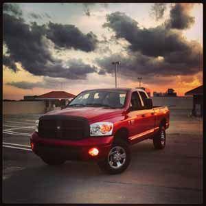

My truck is a 2007. 5 6. 7 4x4 without any lift.
Anyone ever used this combo and do you think it will clear ok?
