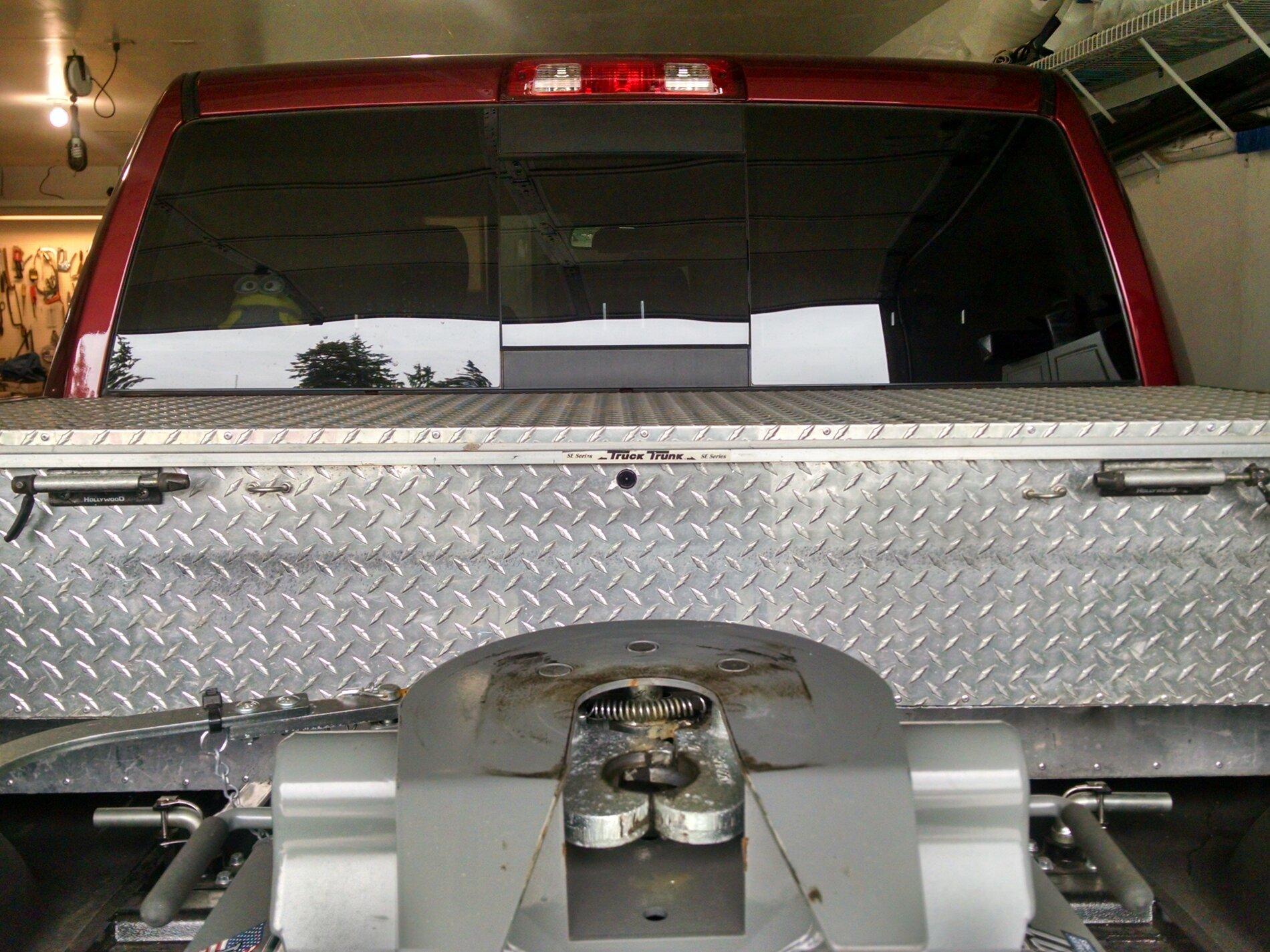

I was playing with new truck today put the B W 5th hitch in . and found I forgot to order the cargo camera . Now I can't see the hitch to line up the pin. Can the dealer install one ?? all advice welcome

I did pull out the head rest the rear window must be different the hitch cannot be seen no trouble seeing the hitch in my 14

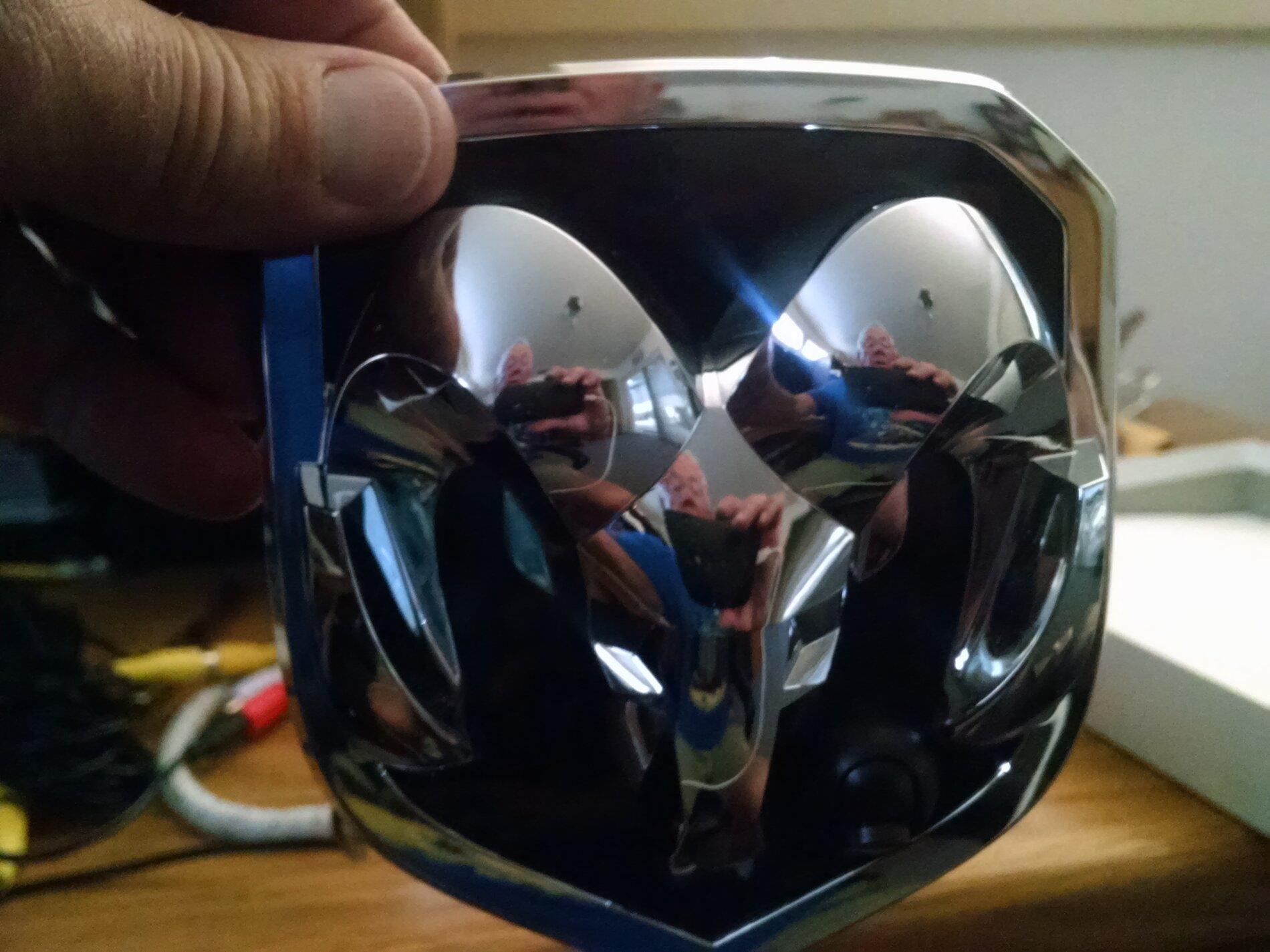

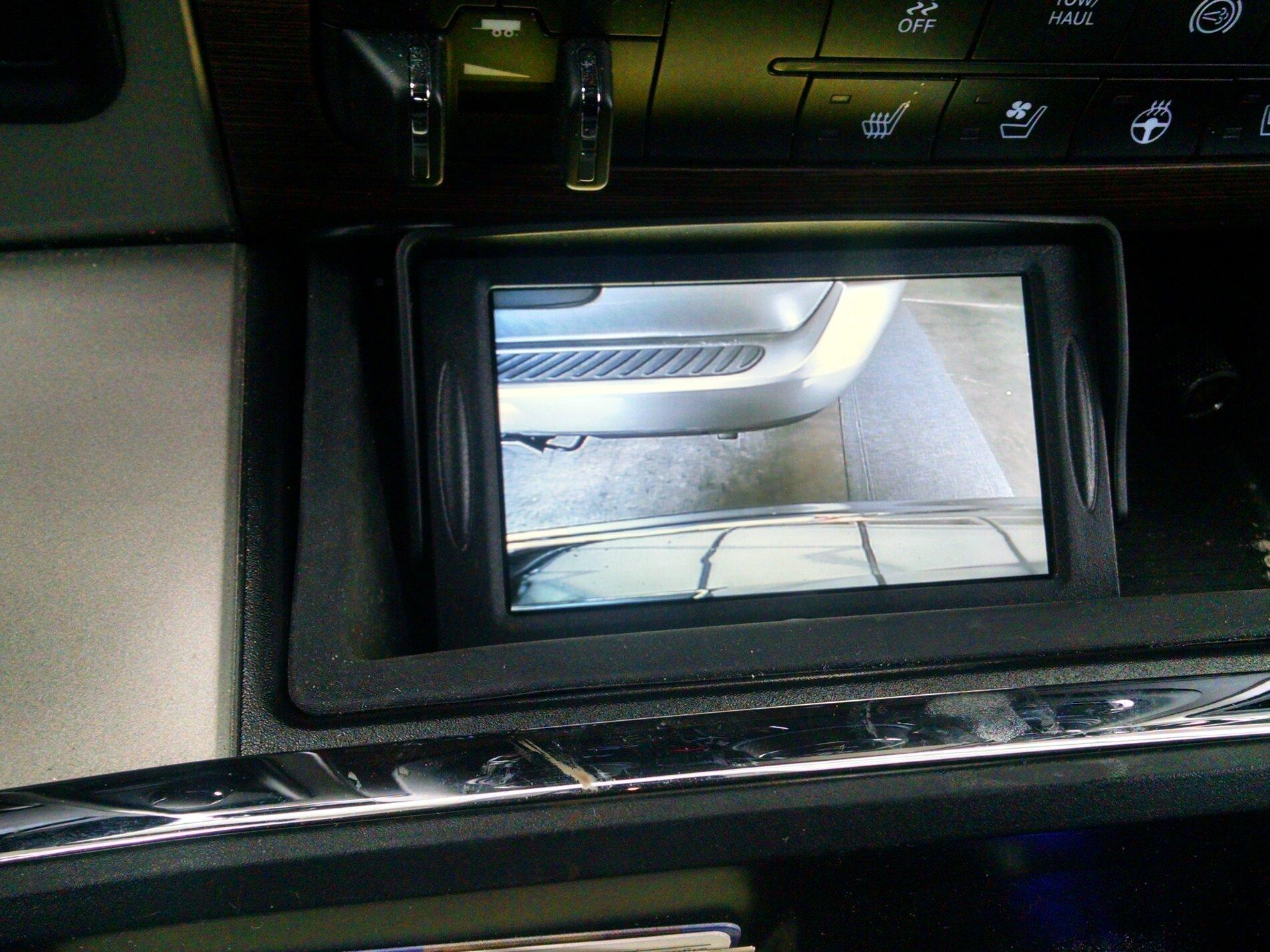

See the black dot in the center of the front box. It looked right at the hitch and displayed on the 4.3" display in the cab. Cheap to do. Worked great, and much better than the RAM OEM camera from the reports I have seen.
What is it an after market camera give me more info please
Similar to this. I have a second camera on a switch that looks down at front bumper. The way is works is both camera have separate inputs. First switch provides power to rear camera and second switch provides power to the front grill camera, we it powers on the display auotmagically switches to the input.
