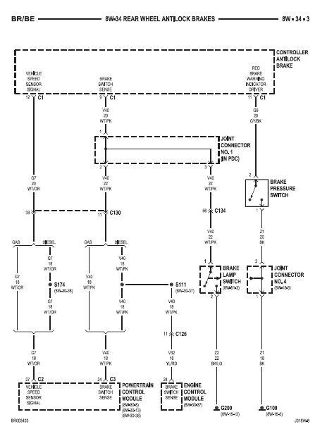

GAmes and DavidC, thanks. I never thought to check the 4 wheel. Will do so and see if all works. Also never tried the cruise control. I will check the PCM for any corrosion. Guys all this helps. Will keep trying.I'm also still trying to find the wires that go from Power Train Controler (WT/OR) to the Anti Lock Module.

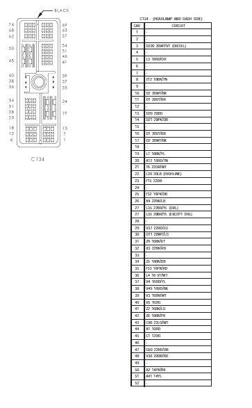

Shows from ABS to connector 134
Pins 10 and 16

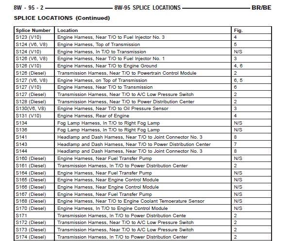

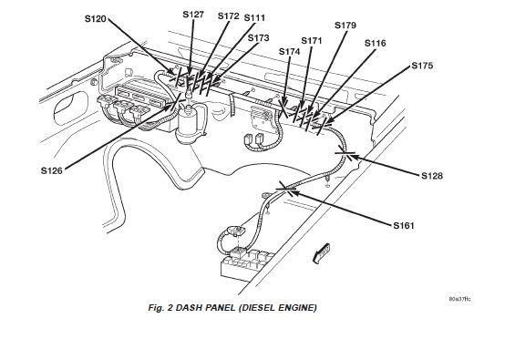

Looked for splice related to abs and saw none. Should I check the 161 for engine to pcm

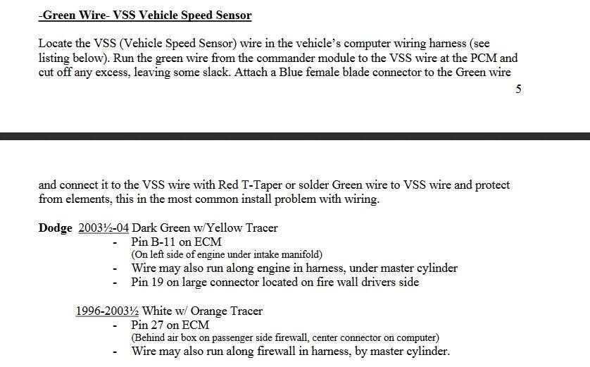

I know nothing about the ATS Commander but Could it be messing with the system since I would imagine it has something to do with speed.
Dave
Keep thinking. That was the first thing I disabled along with pacbreak. I thought the same thing so have left it disabled until speedometer issue is solved. Also commander won't work unless the speedo reaches mph set is reached.
Well I am out of ideas. If the sensor and tone wheel are good, Harness from sensor to ABS checks good, Harness from ABS to PCM checks ok and commander is disconnected that is basically all there is besides ABS and PCM.
