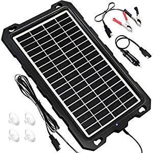

The new truck 2013+ are loaded with battery detection software, In order to save the Batteries and possible corruption of the system it shuts down until the Batteries are healthy and adequately charged. if you decide to jump start make sure you have both batteries safely jumped or charged. My 2013 sits during the winter Months ,I Purchased this
solar charger , its 7.5 watts I had 4watts and it was NOT enough, I also made my own battery connection and quick dis-connect, It sits on the dash and Problem solved, as mentioned the
parasitic drain
will kill the batteries. and the system will protect itself at low voltage.
On Edit: 12w to 7.5w I have the 12w that charges the Trailer batteries.. Opps
solar charger , its 12watts I had 7watts and it was NOT enough, I also made my own battery connection and quick dis-connect, It sits on the dash and Problem solved, as mentioned the
thank you! I will look into doing that.
