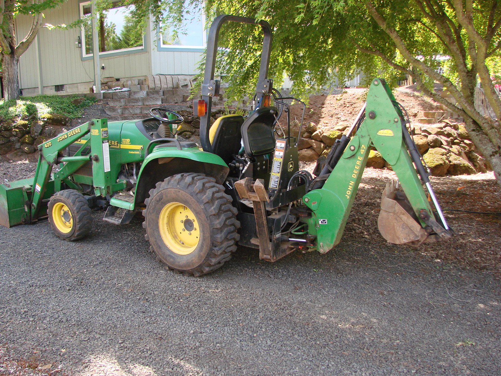

I have a John Deere tractor with an Optima battery ($99.00 at the time) installed in February of 2006. That battery is still working fine today after 18 years and 10 months, and over 2,400 hours of operation. No trickle chargers, no blankets, no jump-starts, and the battery has never been removed. Only the alternator has ever charged the battery.
The tractor gets used year-around and is stored in an open equipment shed. I live in Eastern Oregon - so, lots of cold winter morning starts.
I know - apples and oranges - but, still...,
- John
- John
