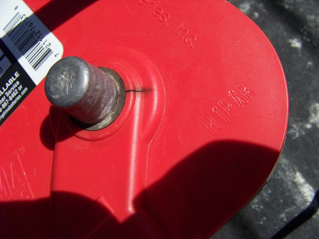

"Supposed" to last longer and not suffer from electrolyte boiling and acid leaking past the post seals
Mmmm K. Non-spillable doesn't mean Leak proof! Heat gets em. Using the GM side terminals so no reason for this to crack and leak. Had five suffer this and require special approval (PIA) for warranty.
Consumer Reports tests even showed the Deka East Penn AGM's couldn't take the heat. Yep. Very short life cranking an 6.5 IDI.
