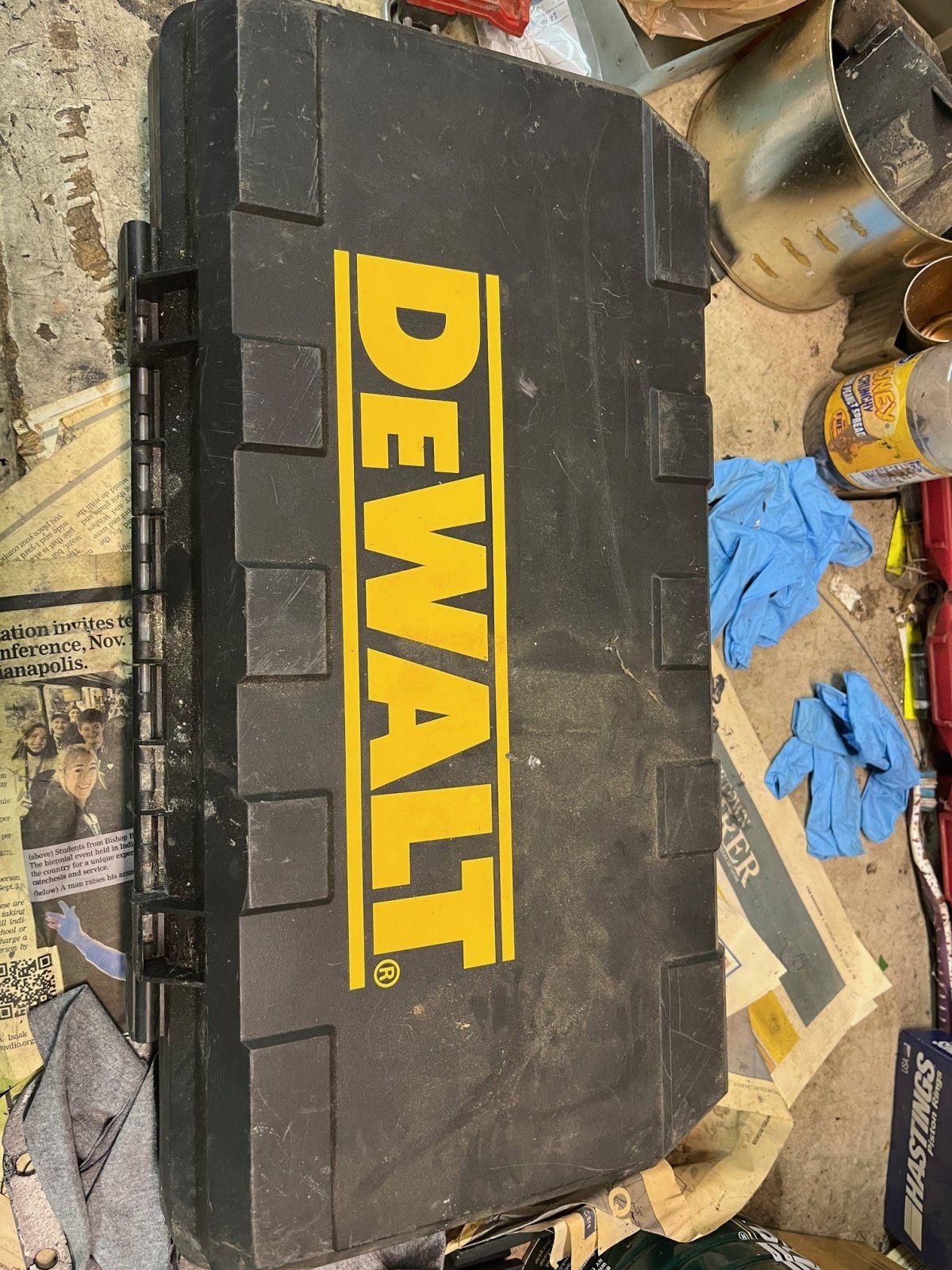

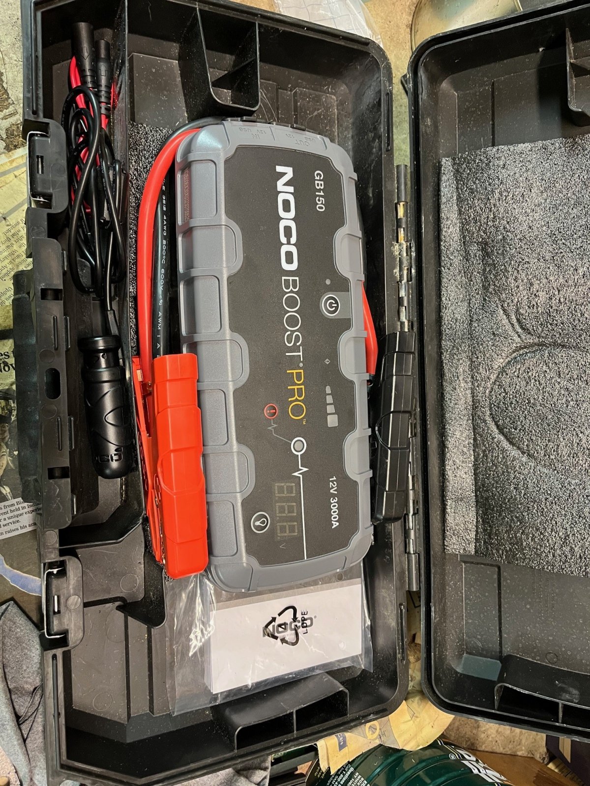

I bought a Noco GB150 boost last year to carry in the truck. I would rather use a jump box than hook my truck up to someone else's vehicle with a questionable electrical system. I used the Noco at a campground to jump start a guy with an old Ford 7.3 diesel engine. He had recently installed a new alternator before this trip. As typical big box auto parts the new alternator didn't make it through the his first trip. The Noco struggled and took several attempts before the truck finally fired up. It did work though.
On a recent trip to see my in-laws I found an unused tool box in his garage. Apparently the tool was long gone so I repurposed the box for the Noco charger. The original Noco cardboard box was starting to get torn up.
View attachment 142643 View attachment 142644
I use my leftover DeWalt boxes for stuff like that! We think alike! :D
