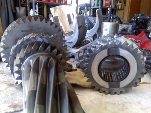

Does it look like this:) Boosted launch in 3rd 4x4, I advised the customer not to do that:D You might try Standard Transmision in Ft. Worth.
Standard Transmission is my go to. Remember there is a HD and LD version of the NV4500. GMs and Dodge gassers had the light duty version.
