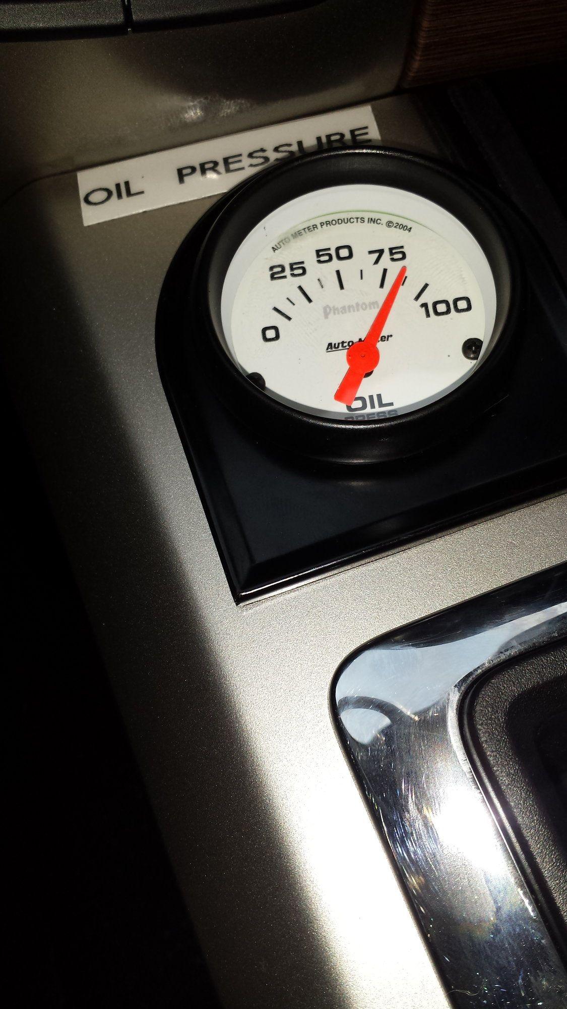

The 6.7 / 5.9 do NOT have the Sensor for live oil PSI, its a switch thats trigger at 10PSI.
You would need to install live gauge for actual OIL PSI.

Well mine does watch it every single day. You need to do a little more due diligence.
Due diligences? I went back looked at your posting No mention of live gauge, I pictured mine. that one is My ED, I can provide the exact Gauge in My Cummins.
For members not familiar with Most OEM oil PSI readings are programed conditional readings AKA (LOM) Lie-O-Meters.

I thought the oil pressure readings were legit and the oil temp was a guesstimate.
