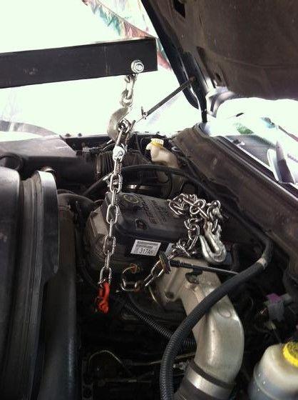

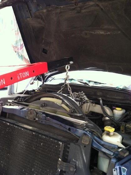

DZ ink24, we didn't use the shipping hook on the driver side of the engine. We lifted the motor using the front shipping hook left on the engine at the passenger side, and actually wrapped a chain around the engine mount itself on the driver side. The lifting point was almost at the center of the engine. We did measure before we lifted and had about 4. 75" of cherry picker travel before it hit the hood. Considering we had to lift it 3. 5", we had just over an inch. It wasn't close enough that it bothered me, and we were mindful of it.
Pan was not heavy, and no where near 4' long. I removed the old and put in the new by myself, on my back, working around the cherry picker, two jack stands, and hoist arms on both sides. It is very manageable. My estimate on a length would be 30" As jhenderson mentioned, start up was like any other normal oil change, no CEL, oil pressure jumped above 40lbs instantly at start up, and after two days of driving, no leaks around the pan (knock on wood).

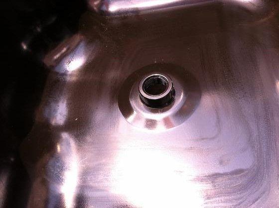

One observation. The bung of the pan is quite thick. We never really drain ALL of the oil in the pan.

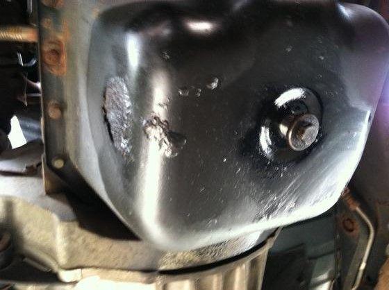

My pan has very little rust. Just a few tiny spots where the part number is stamped in.
-Ryan
Ryan, not too sure what it is. Seems like the Ecoat you see on sheetmetal. I wasn't taking another chance, so I did what POR15 recommends with a scuffing with steel wool, their phosphate wash and then their paint. There's still spots of it in my Dad's driveway from when I did the Duster's floors in the '80's.
