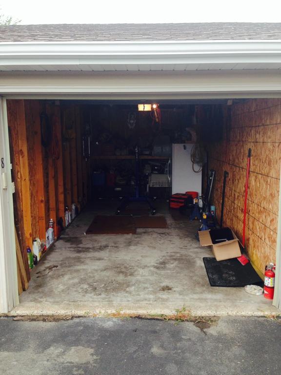

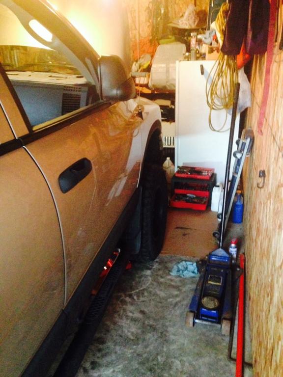

I tackled this job today, took about 7 hours with my union mandated break. Was pretty easy, just time consuming due to my limited work space.
Here's my shop.

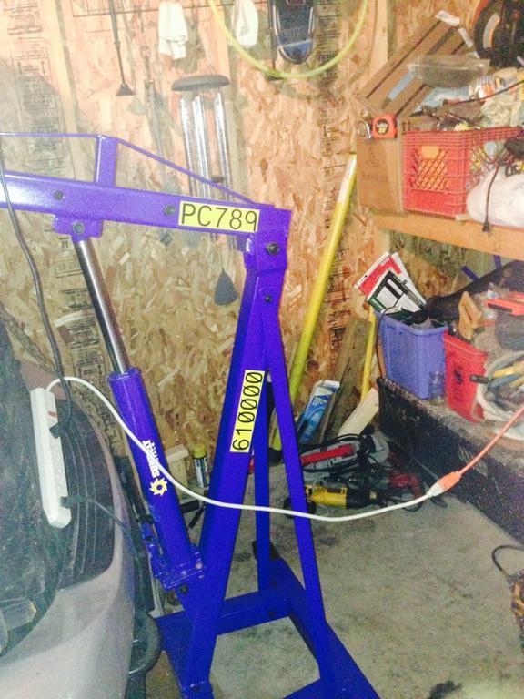

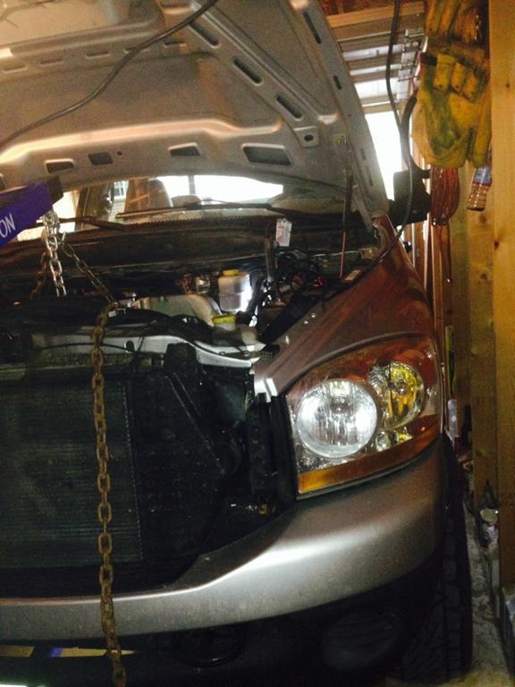

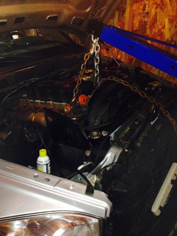

Getting the pan off wasn't too difficult. I followed a lot of the suggestions given from other members. I jacked the truck up by the frame so the tires were just touching the floor and put jack stands under the frame rails. I disconnected the batteries, the tube between the turbo and filter and the air horn. I loosened the four bolts from the cross member to the transfer case and loosened both motor mount bolts. I rented an engine hoist and rigged on the front eye on the passenger side and wrapped a chain around the driver side motor mount. It lifted the motor perfectly straight. I jacked it up till the valve cover touched. When jacked all the way up, the head of the hoist was about 2 feet away from the hood.

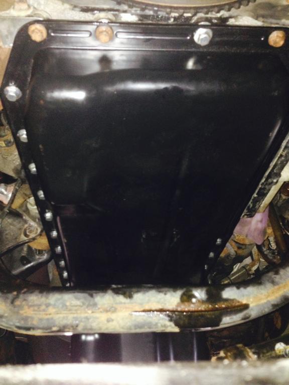

The outcome from todays struggles.
This really wasn't too bad of a job. I would definitely do it again if someone needed help. The only part that gave me trouble was when I lowered the motor back down into the mounts. The drivers side went right in, not so much the passengers side. That side took me about an hour. There wasn't enough bolt sticking out the front of the mount to slide over the flange of the mount. I had to put a chain hoist on the mount and pull the motor forward to get the bolt over the mount flange.
This was a Spectra pan I ordered from O'Reillys. Holding the two pans side by side it's pretty hard to tell them apart. The Spectra pan was a lot cheaper than the factory pan and it came with a drain plug, unlike the factory pan.
My war wounds from todays event include four banged and bloody knuckles, two goose eggs on my head and countless scrapes on my arms. I ended up throwing my shirt and pants away. I actually washed my hair with Fast Orange after bathing in oil all afternoon. I don't think I've ever been this dirty after working on a vehicle before.

Only thing I had to remove was the motor mount bolts, nothing else. Lifted the engine a little better than 3" to get the pan out between the cross member and the oil pick up tube.
I would recommend lifting it like TRAMPLINEMAN did, and not like I did which was using the shipping hook, on the pass side, and wrapping around the engine mount on the driver side. Lifting like he did at the front of the motor would improve leverage and make it a little easier.
