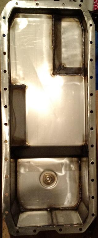

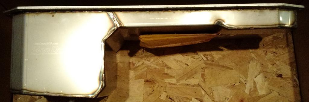

Just got my new pan from SnoDepot since I never want to do this or pay for it again. Not sure how it compares to the factory pan, but it looks like a heavy, well constructed unit. A lot of welding vs a stamped/drawn unit.
No good place nearby to work on the truck... and don't want to risk the pan failing driving more than across town (it starts dripping pretty steady when the oil warms up a little), so having a local mechanic, who's willing to use some of your helpful hints, swap the new one in later this week.

The stainless pan is nice. I would etch it and paint it, chlorine eats stainless steel. We see it a lot here, heat treat factories use in house water treated with chlorine to cool their furnaces and it deteriorates the walls, carbon vessels far outlast them.
