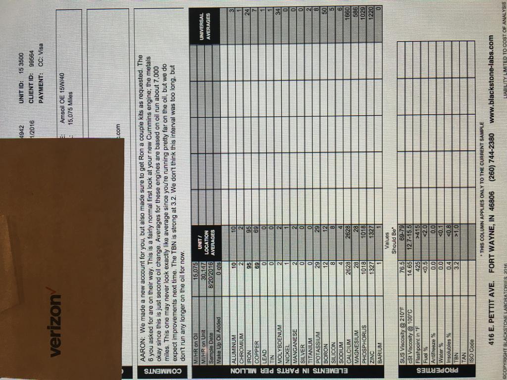

They said their comparisons are on results of around 7,000 miles.
AMZ/OIL OE 15-40 ran 15K changed at 30K on my Sons 3500 SRW, he tows a 14K dump quite often.
I did a resample and am waiting for the results, but by comparing my numbers to yours, My potassium is way high with very similar miles (30,250) on the truck. The trace of water has me slightly nervous.
EGR cooler, maybe? I haven't noticed any antifreeze loss, or milky antifreeze in the overfull bottle. I cant find the email from the dealer with the allowable specs from Cummins, but I do remember that
Cummins allowance for Potassium was quite high, its the water that really bothers me.
