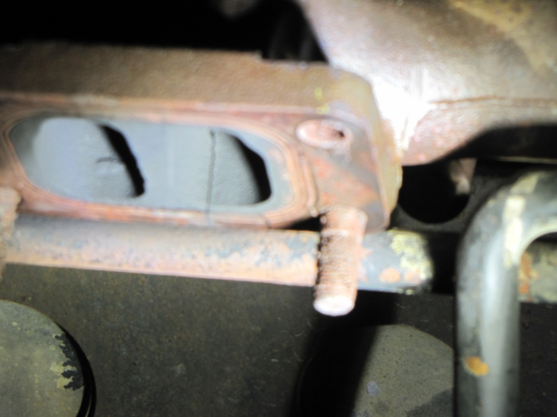

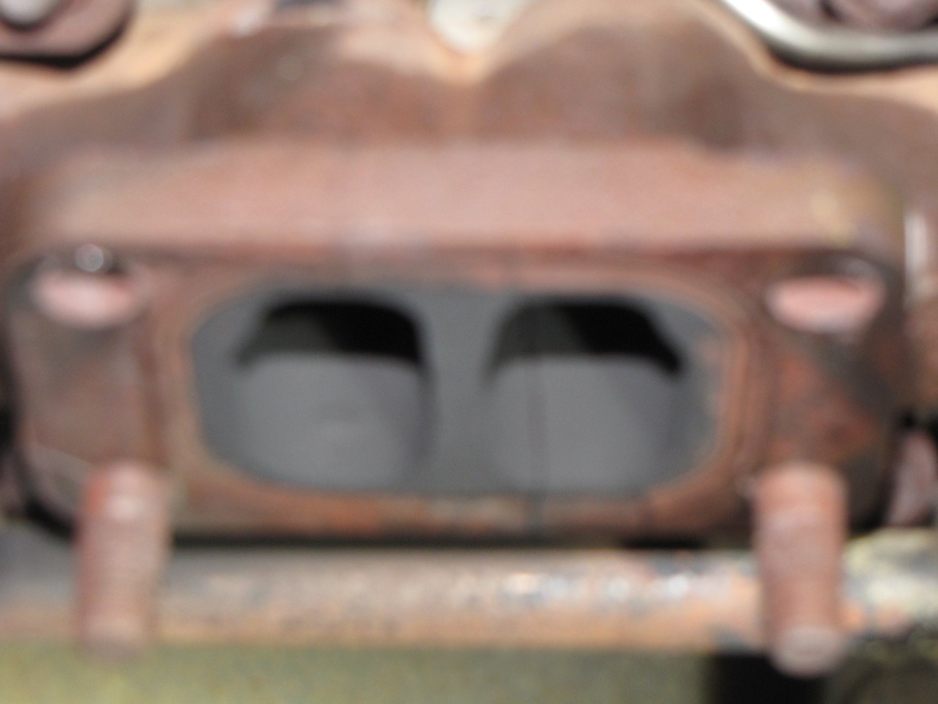

I have been working to install a Pacbrake on my truck and nothing seems to be going my way. First a bolt snaps when removing the down pipe to the exhaust, then I remove the turbo and now find a hair line crack on the right side exhaust port of the manifold. Not sure if I can get away running it like this till winter comes and I can swap out the exhaust manifold or if I have to do it now. Any one have any suggestions. I really am not sure about replacing the manifold as I think it will be a difficult fix dealing with the stock bolt removal. The frustration level just keeps rising !!!
There is a big crack in the floor of the right side turbo port as the manifold appears in the picture. I would bet that crack goes back to where the two sides of the manifold come together and goes up toward the top of the manifold. Mine cracked in a similar fashion just before the engine warranty ran out.
I am glad you were able to see it and yes I have the manifold off now and it is cracked the way you said it was. Never would of seen that if I did not pull the turbo to drill out the broken bolt. Now I have a broken manifold bolt to deal with slightly inside the head almost flush. Seems the previous owner did that and tried to remove it as I can see a hole drilled in the broken bolt.
The crack in mine was just barely visible from the top of the engine, but when I crawled underneath to get a better look it was pretty obvious. When I took it to the dealer they said “ oh those never crack.” I said you look at it and tell me what you think that funny line is. “oh yeah it is cracked . . . “
