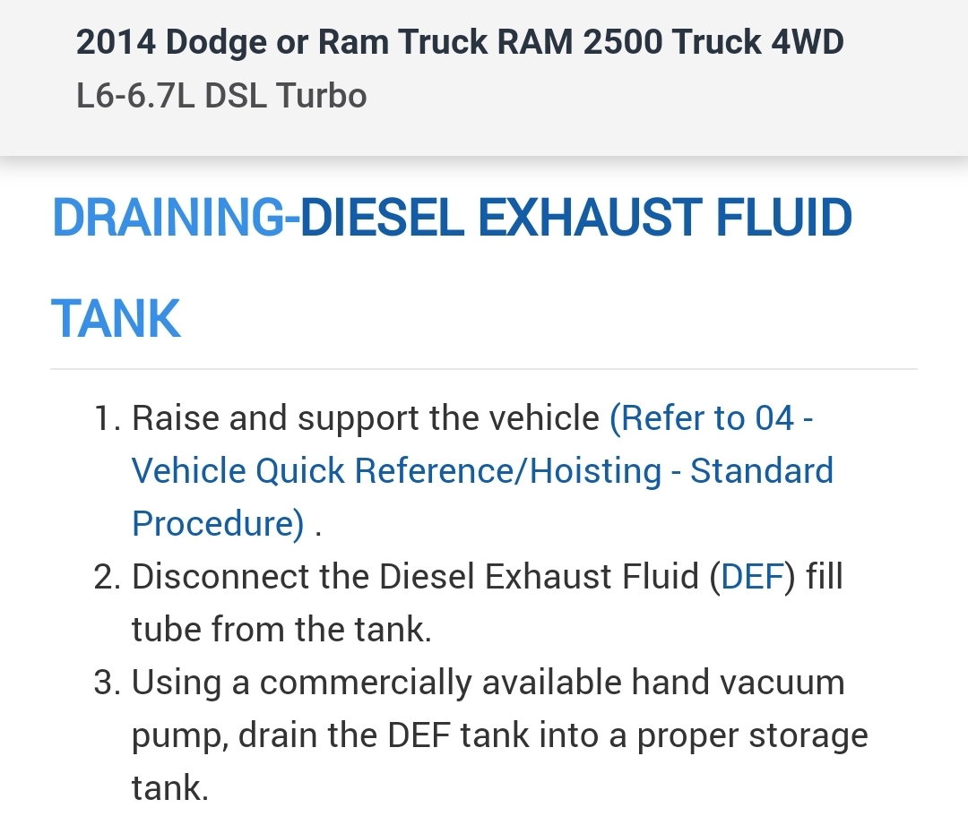

I would first try dumping the DEF and refilling it with known quality DEF, reset the code, and then try driving again.
Alternatively, if you want, you can buy a DEF refractometer off Amazon for cheap and take a sample of the DEF inside the tank. See if it's in the neighborhood 32.5% UREA.

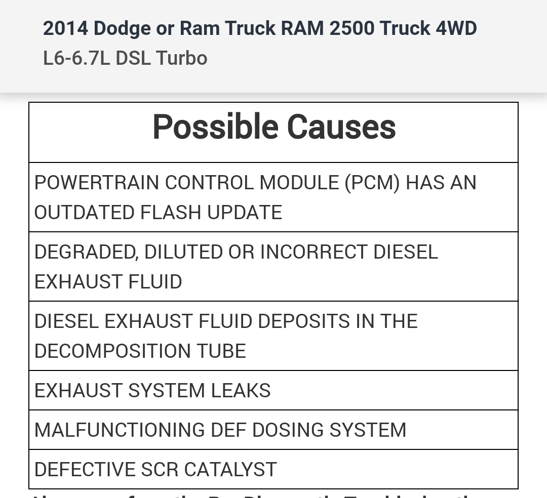

If all you have is a P20EE you need to be on a current software level, there are multiple TSB that I see related to this one, top of the list is latest update.
If you have other codes address them first.
But in general I would be checking the VIN for notices and see about having a local shop check the software levels.

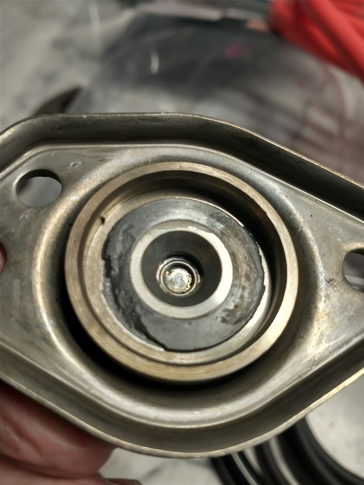

Well I drained the def tank and checked it and it was at 32.5 but I replaced it anyway. Then on to the injector. I had trouble getting it out, the little white plastic ring was tricky until I watched on U tube how to get it off. I cleaned it and noticed a little damage to the seal (I think that is a seal) please see photo. def injector.jpg . So I ordered one from Geno's and noticed a gasket for it, I didn't see a gasket on mine. Do they all have a gasket? When I get it put on I will post result's.
I can't remember, but I think you're seeing the gasket. I keep several gaskets in stock, for when and if I need one. Plan on pulling mine at least every 2 years if not sooner! Just one of those things that you add to the list to do with maintenance!

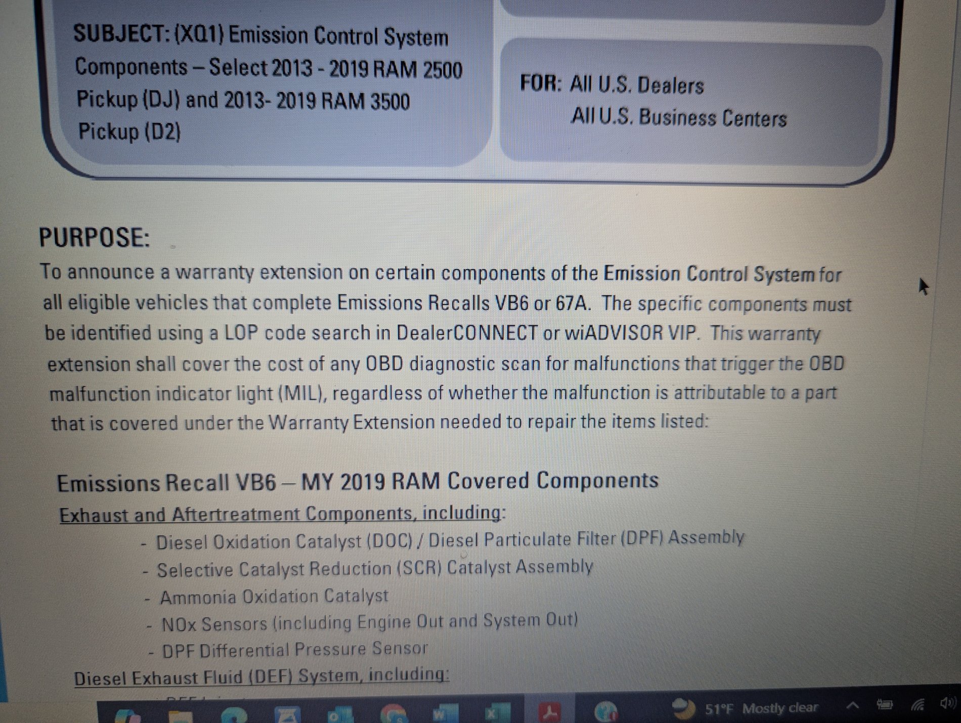

your vehicle is probably subject to recall... its worth taking it to the dealer to see if it is. I do recall Mopar Cummins did have to repair/replace some SCr units back in that time frame..
https://www.epa.gov/enforcement/cummins-settlement-nationwide-recall-program-overview
https://www.cnet.com/roadshow/news/epa-cummins-emissions-control-systems-recall/
The S87 was done in February 2017 at Ferman CDJR, the 67A was done in January 2024 at Victory CDJR, so you have an extended warranty on many of the SCR parts under the XQ1 extended warranty.
With having the 67A extended warranty, let the dealer get it figured out. I just hope that if it's the SCR, you won't have to wait 30+ days for repairs to be completed. They replaced the forward NOX and SCR on mine after the 67A recall was done. Call your dealer to get it scheduled. Good luck getting it figured out.
