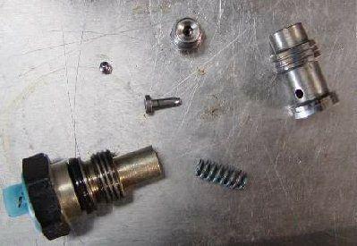

Ok, So I have the dead steering at a stop and at slow travel as is backing up a trailer. I tried opening the I. D. of the main fitting and nothing. Tried streaching the spring again nothing. Then I used a washer, thinner then a #4 not sure if it was a 3mm or not. This reduced the effort required to turn the wheel but far from the one finger lock to lock. I was able to turn the wheel at idle about 3/4 turn, If i reved it up to about 1500-1800 rpm I had the one finger. If I reveded it over 2200 rpm effort was all most non existent. Once the revs came down I would loose steering for about 5 min. The fluid would become arriated
This worked until I need to back my trailer and the pump made a screeching pop noise and I lost steering and brakes. So I replaced the pump and I am back to square one.
The pump I have is an Autozone pump with the lifetime warranty So I am willing to try again.
Could some one tell me what each mod does?
streaching the spring would?
Increasing the I. D of the main fitting would?
Adding a washer to the regulator would?
Thank You
Brian
The original pictures are bmp and won't load. This is one that will. Hope it helps.
Thank you. I'd also like to know if this is possible on the third gens aswell? Do the 3rd gens even have a screen in them?
