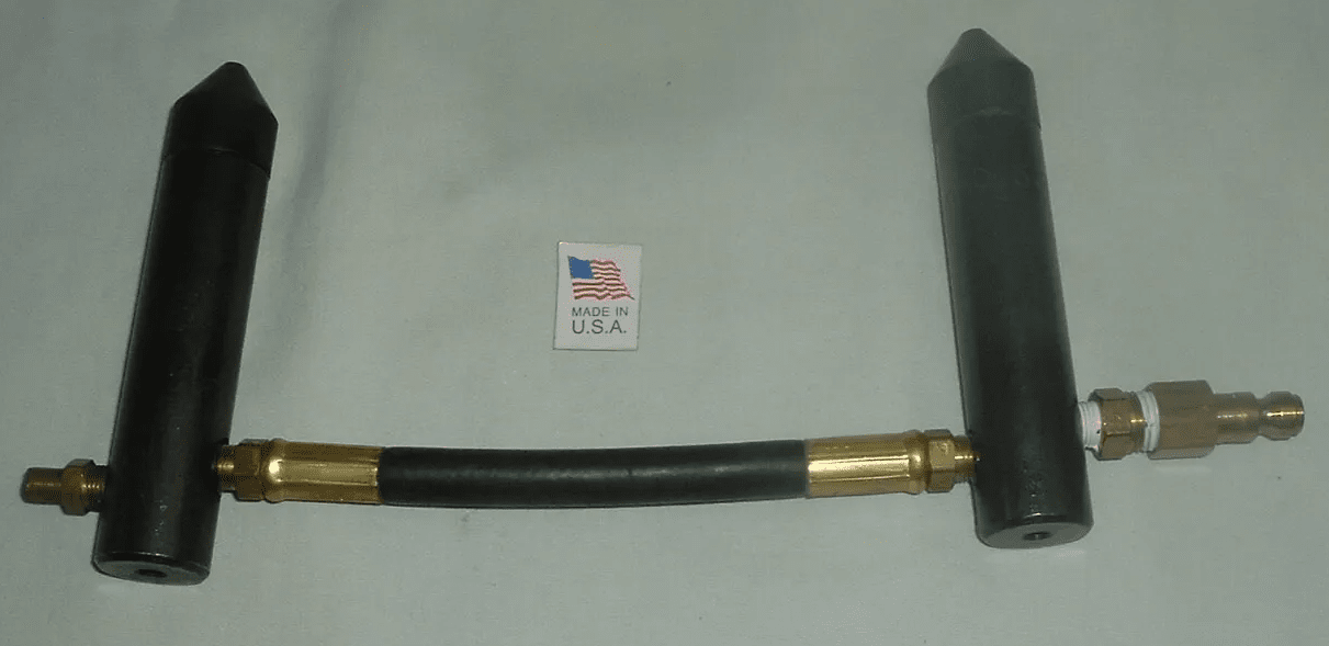

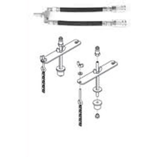

I also used to use a second person to pump the brake pedal. That was usually my wife, with the instruction to not push all the way to the floor, while I manipulated the bleeder screw with a wrench. My retired neighbor took pity on me in 1978 and lent me his pressure bleeder that had been purpose-built for when he worked at a Cadillac & LaSalle dealer in the 1940s. It was basically a steel canister into which we poured about a quart of brake fluid. We used shop air to keep it pressurized using an on-board gauge to about 10 PSI. The brake fluid line fed a circular screw-on master cylinder adapter that was commonly used for single-cylinder master cylinders of the 1940s to the 1960s. (I inherited it when he died and still use it, with suitable maintenance.)
I needed to adapt it to the Delco (GM) style rectangular style reservoirs that were introduced in the 1960s. Regardless of their price, I could never, ever get the flat plate adapters to seal. They would leak air and brake fluid al over the place. The mess was astounding. Even now, I still have that problem. So I found a twin-post kind with rubber seals that jam into each of the twin cylinder's feed ports. It would adjust to any spacing. That worked great. It looks something like this Branick G310, but what I have is a K-D 3353. I still use it. Since that time, I bought brake fluid reservoir caps for different cars and affixed quick connect fittings to them, by drilling holes and using O rings.
Edit: What I bought was this model 3353 from K-D tools, although it was complete. This image is from an eBay listing, current as of today.
