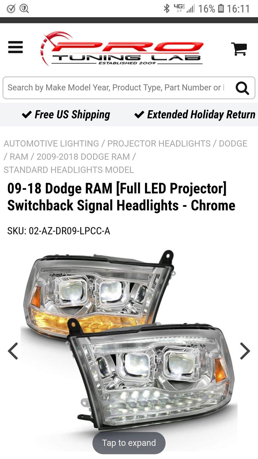

Ron that pic you posted looks like a Morimoto knock off
Yes Sir, my thinking too. Just for whiz bangz, I searched cost of 19+ OEM housings and priced out around $650ish EACH. That kinda becomes the price point.
