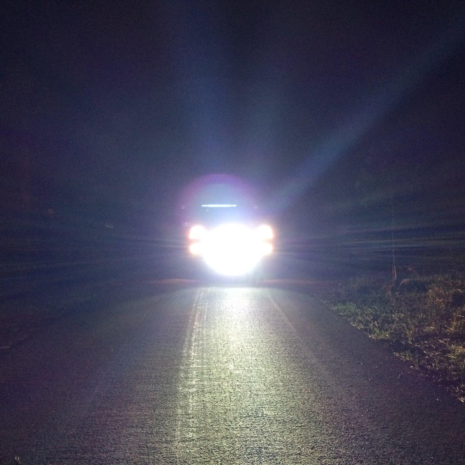

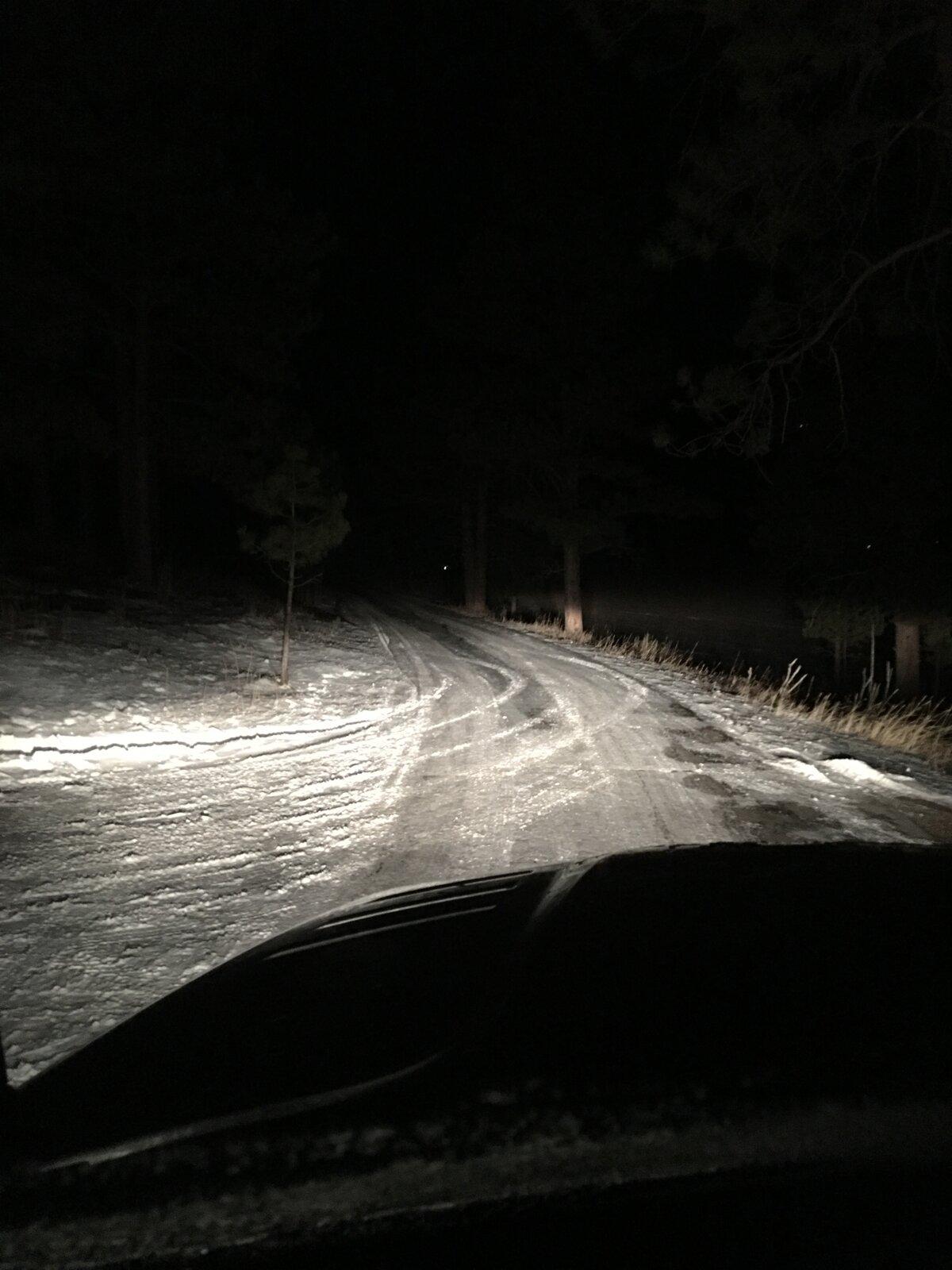

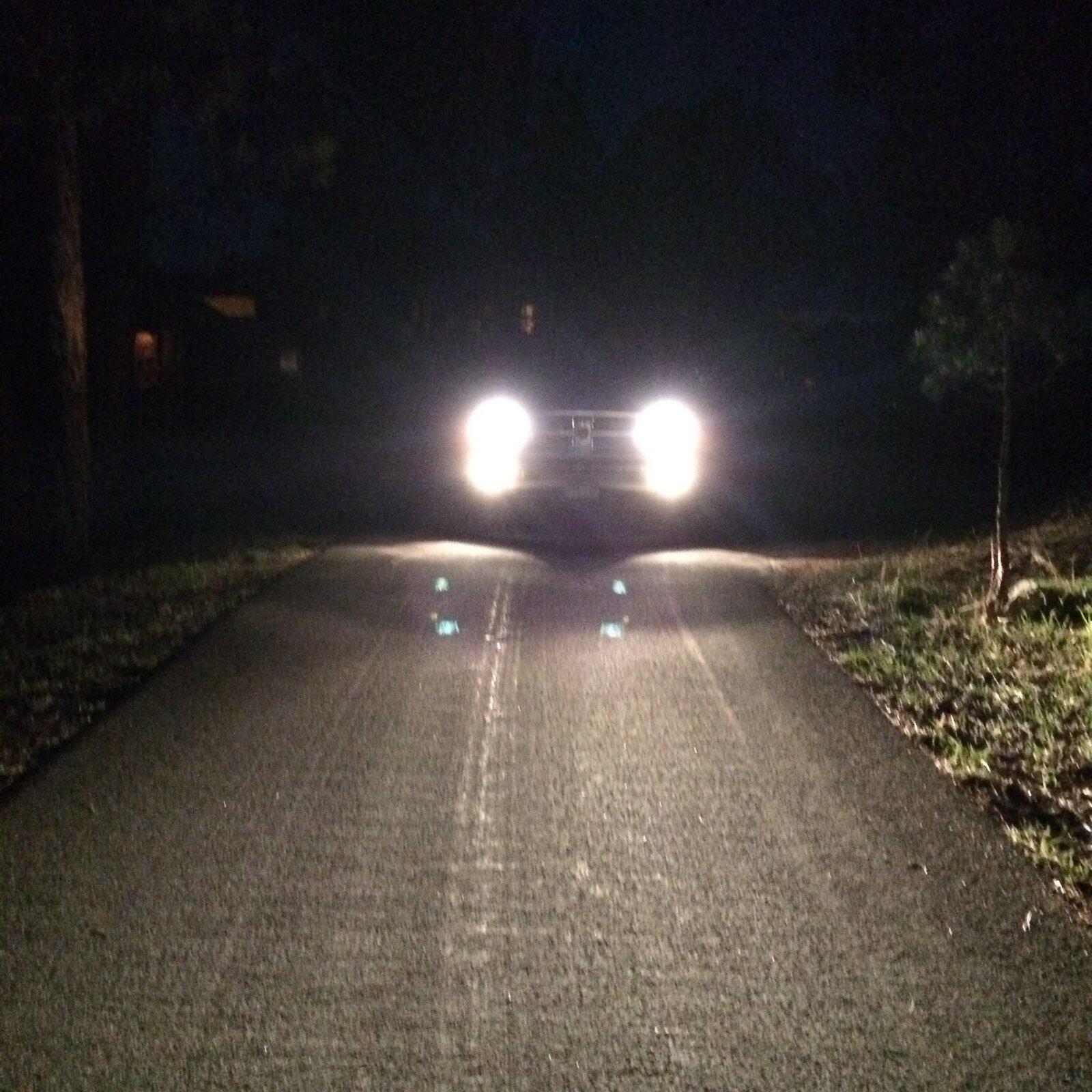

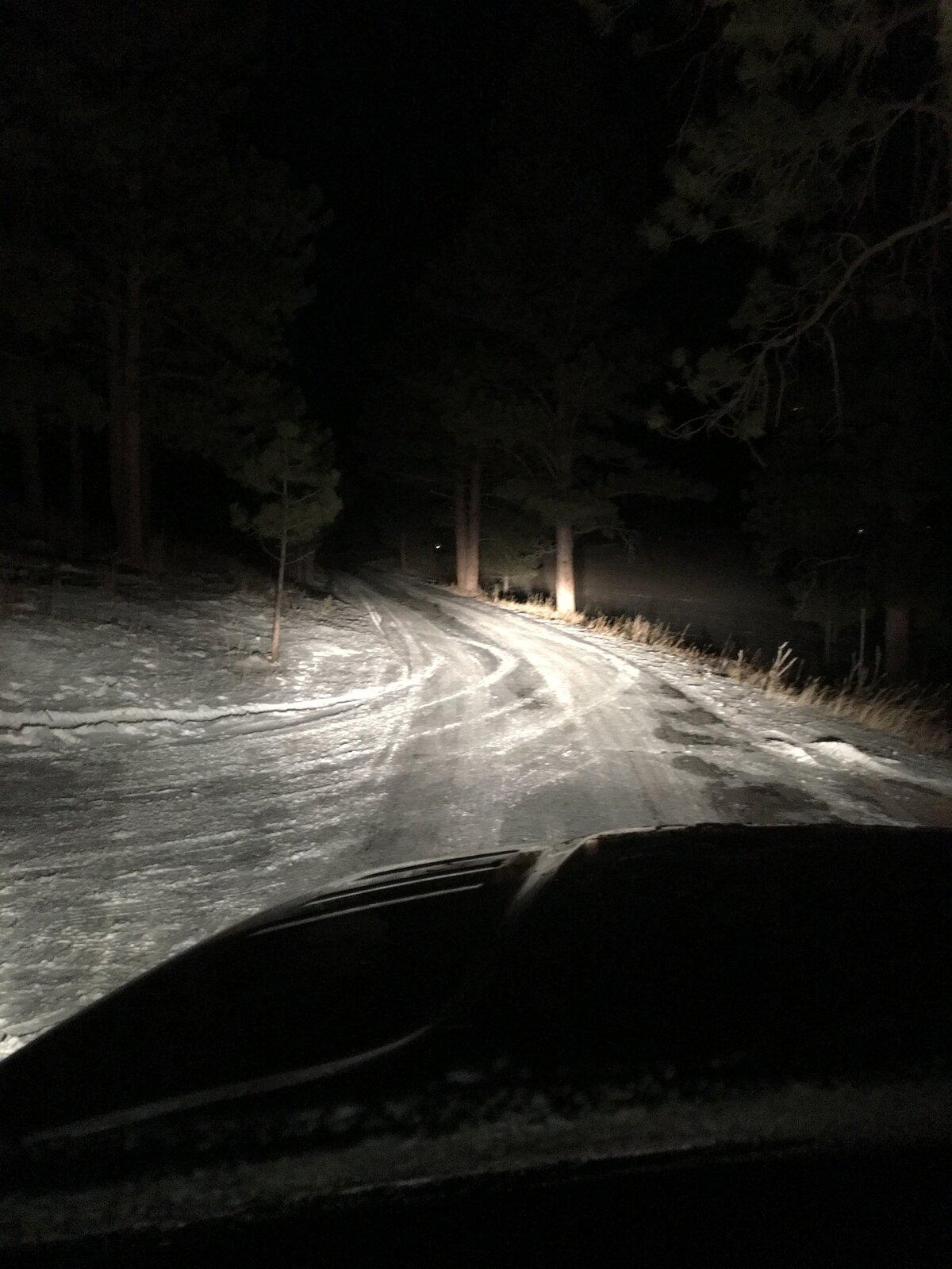

Here is a comparison between my 2012 high beam at around 150/200 ft and the Rigid SR30...Obviously the light bar will outperform the any stock beam pattern...I am very happy with the set up, solved the dim beam problem for where I drive...which is very rural for the most part

BY request for AH64ID and anyone else:
2012 headlight Comparison:
Shot 1 Low
Shot 2: high
Shot 3: Rigid LB
The Phone lens cant pull the distance...but figure LB to the tree 75 ft....the Rigid goes across the field
