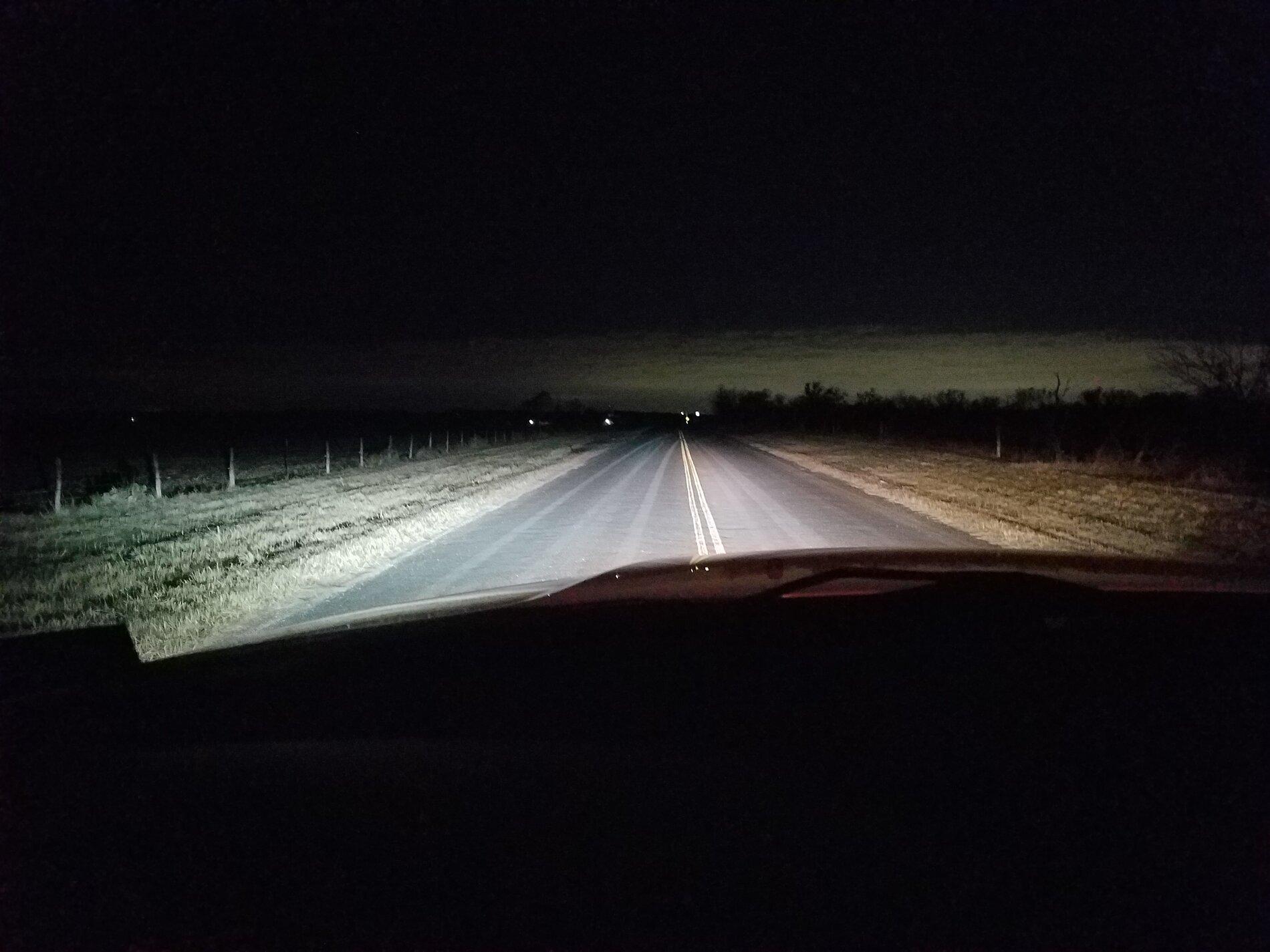

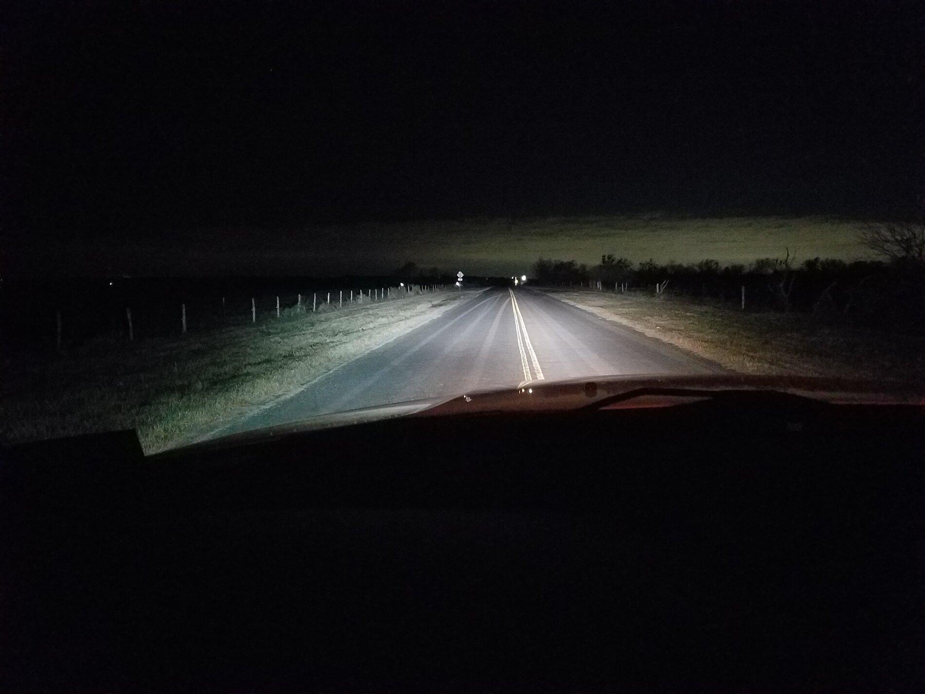

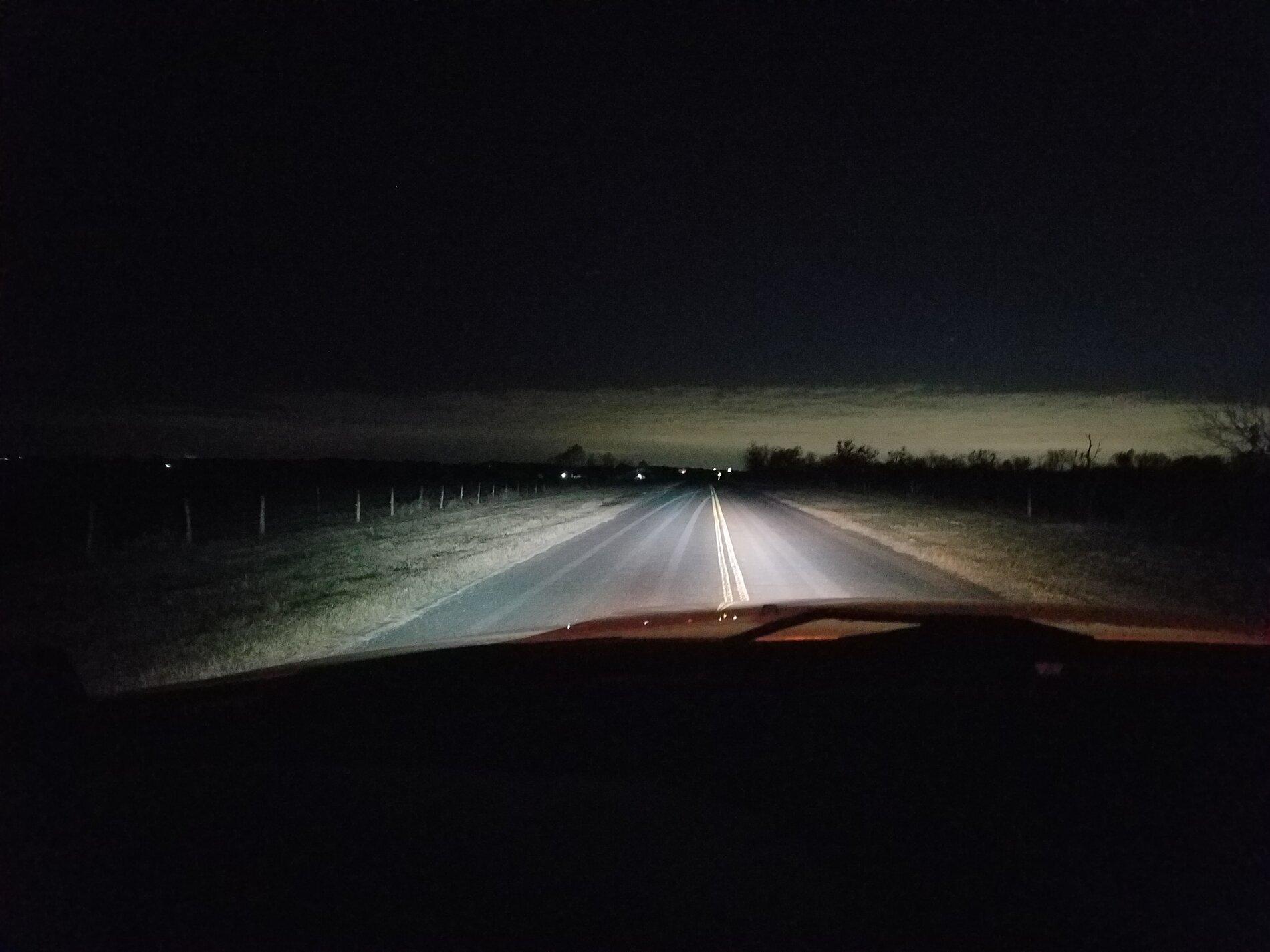

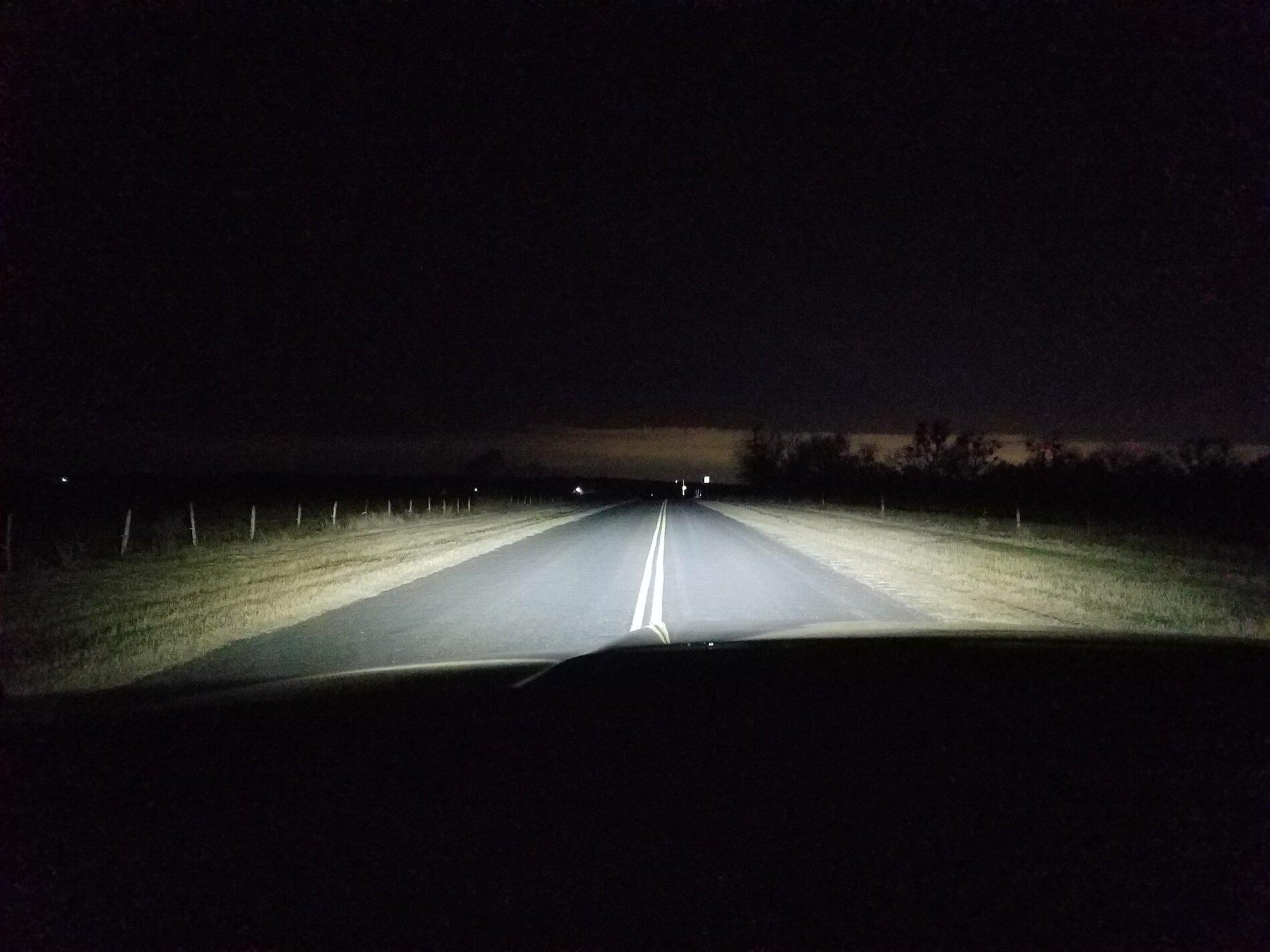

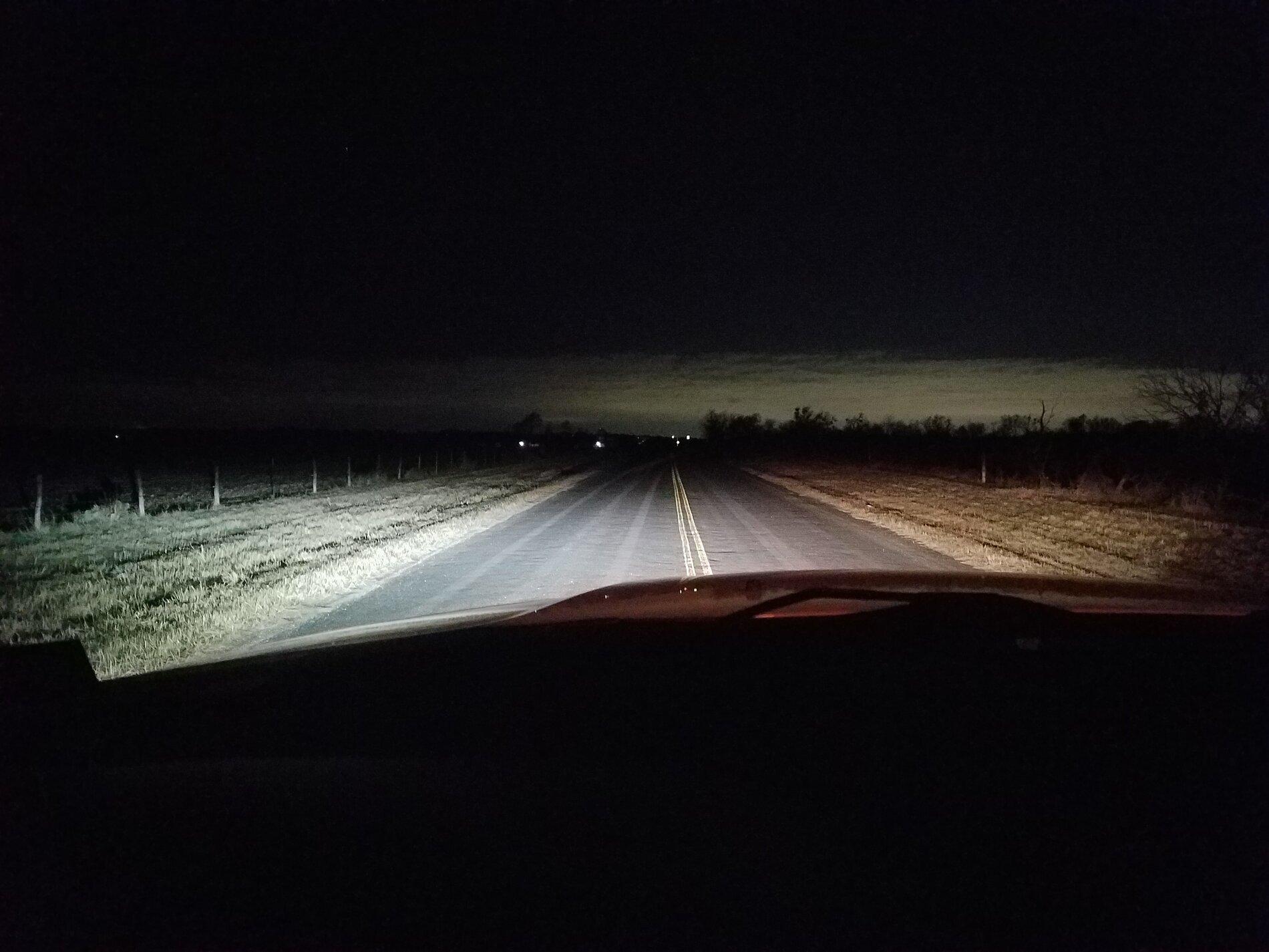

Friends,

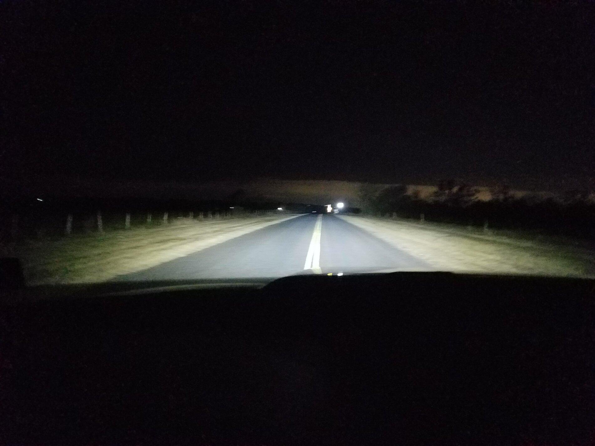

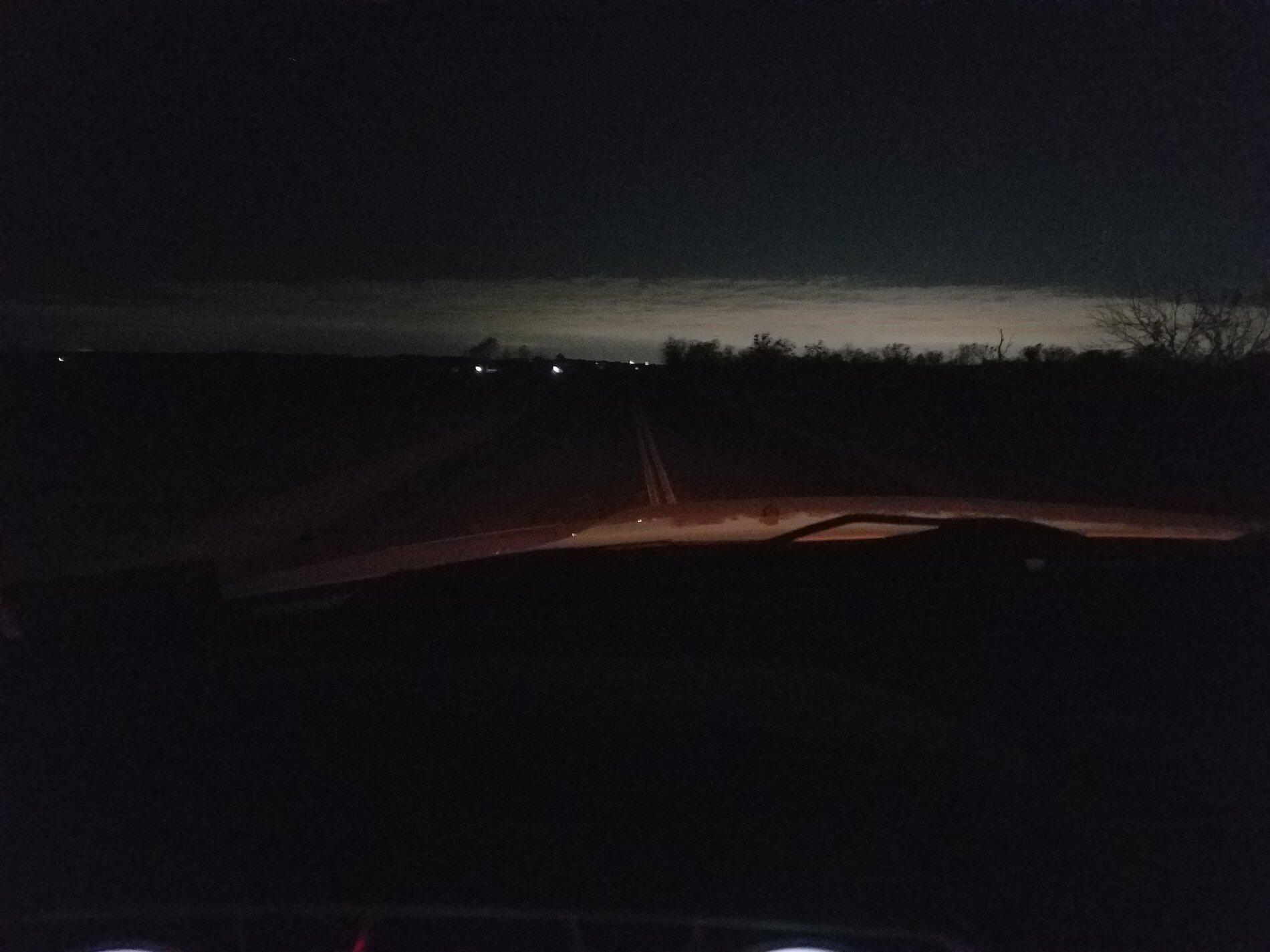

I received the GTR 9005 Mini LEDs today and installed them properly clocked today on the drivers side only. See results on dark road:
DRLs only
Fogs only
Low beams
High beams
Low Beams and Fogs
Wifes 2019 Ram 1500 with factory LEDs
Fogs
low beams
high beams
Sorry, didnt get lows and fogs on wifes truck, Car turned onto road 1/8 mile behind me so left the scene.
On my 5500, I'll have to come back to tell you I think the left LEDs are $435 better than the right factory halogens. Passed traffic and didn't get flashed, which is why I installed them on the drivers side. Tomorrow night, going on longer drive in the country and some Interstate and will come back afterwards with my impression.
EDIT: I reviewed larger photos and am convinced these LEDs ARE better! Not so easy to discern them on my Smart Phone. I'm a happy camper.

Hi Ron-
Thanks for posting the pictures! Just want to clarify where you put the GTR’s, in the low beam or fogs?
Thanks - Marty
Marty,
I installed them in the LB, HB and Fogs on the left (driver's side only) all GTR 9005s. The projectors LBs, and HBs have to be clocked (rotated) to be vertical and the fogs didn't require clocking. These are pricey, but the best thing short of a factory LED, which I also showed. Compare my pics to Morimoto website for $1630~ and I think you'll agree this is great. The GTRs can be clocked (rotated) with a small hex screw.

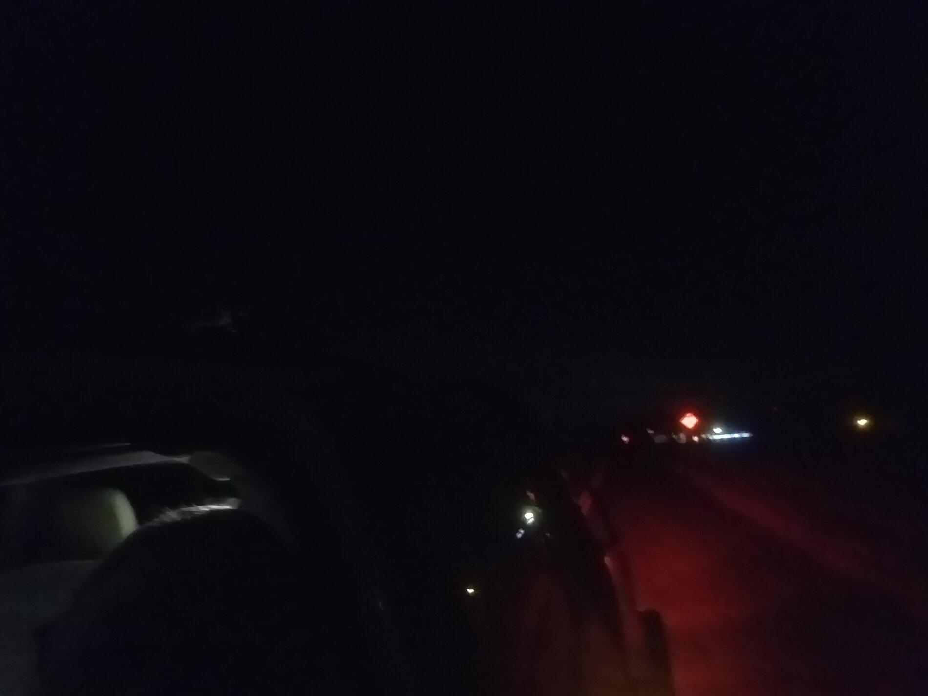

Friends,
Just got done installing the last three LEDs and buttoning up. Last night also took pic of LED stop lights that came with the CM bed ... You can see reflection in stop sign about 1/8 mile down the road and a yellow road sign about half way.
LEDs are great...
