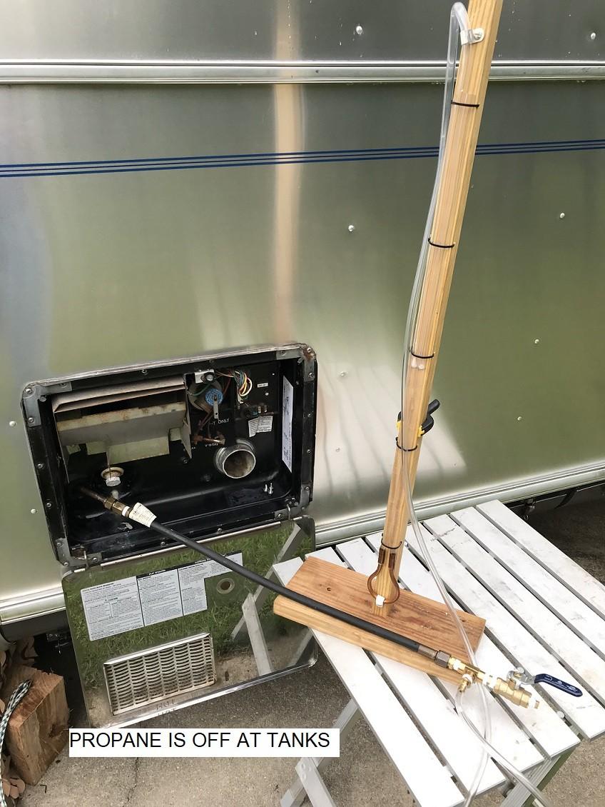

I was intrigued by Darren’s My RV Works video on testing your propane system so I made my own test rig. I chose to remove the WH burner to make attaching the test rig easier. The locked PSI and loaded testing went well but the leak down, not so good.
During the leak down test, I could watch the pressure slowly drop, now time to find the leak. I soap bubbled from the tanks, regulator, hose, copper line and all fittings including the stove.
No bubbles found and I had no know propane leak symptoms.
Next, I decided to disconnect each appliance service line and plug the line. Re-pressurize and leak down test for each of them. Stove and refrigerator, no change and the WH burner was already disconnected. That left the furnace.

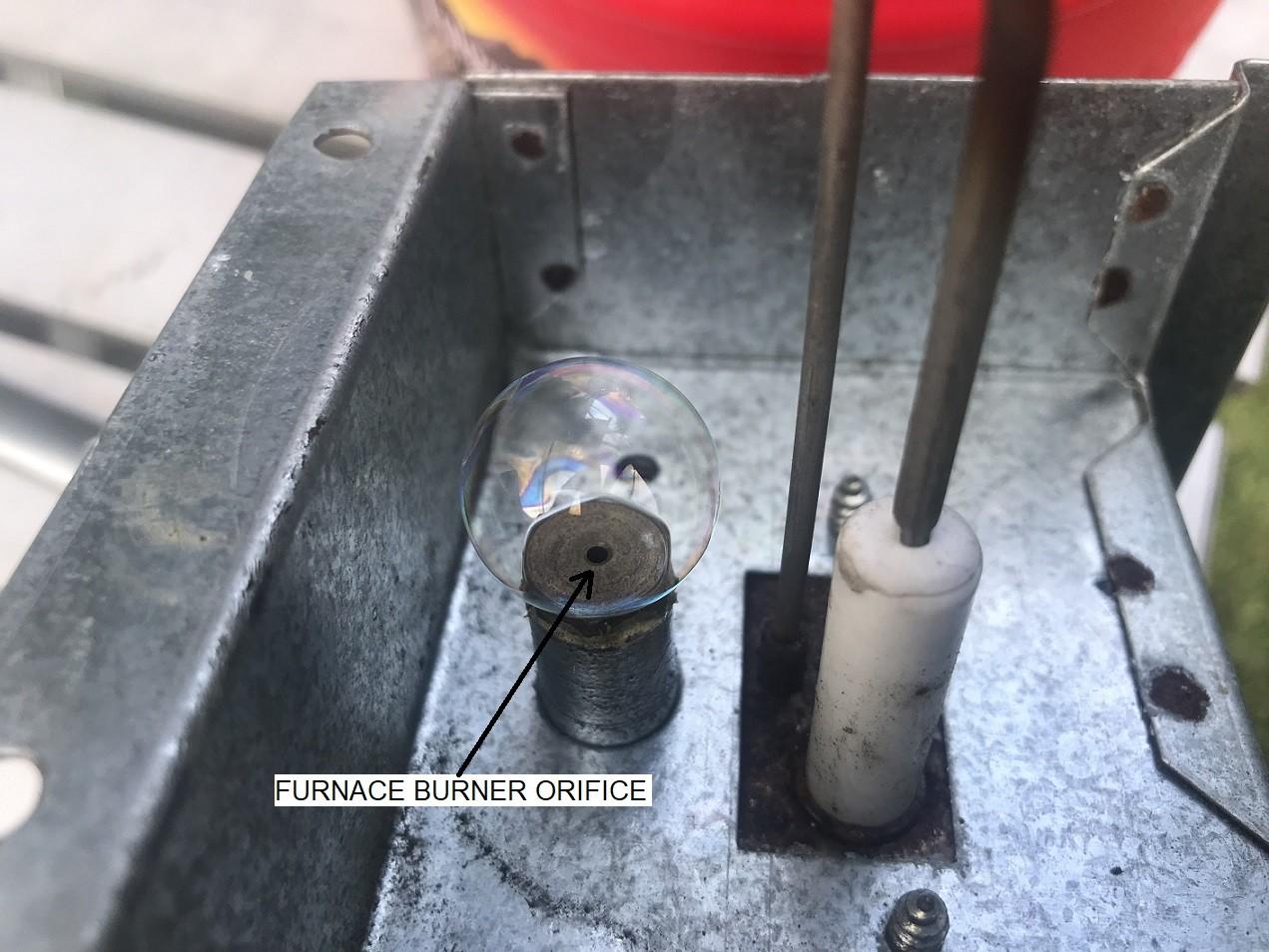

I’ve had the furnace burner out for service, not difficult to do. Then I capped the furnace line and leak tested. No more leak down pressure loss.
Next, I attached the burner and valve to my test line and turned on the propane. With soapy water on my finger tip the burner orifice blew bubbles. Order new valve, transfer the old parts to new valve, install and test. The leak down test was easily passed with the new valve.
If you’ve never had your rigs propane system leak down tested, might want to consider it as a maintenance item.
Please be careful if you decide to try working on your own propane system might be time to have your shop do this test.
Gary

Thanks. My goal was not a tutorial on how to do it rather just raise a little awareness about it.
After initial testing I verified a Marsh inches of water gauge to the U tube changed to Marsh and now it’s a portable tool.
Gary

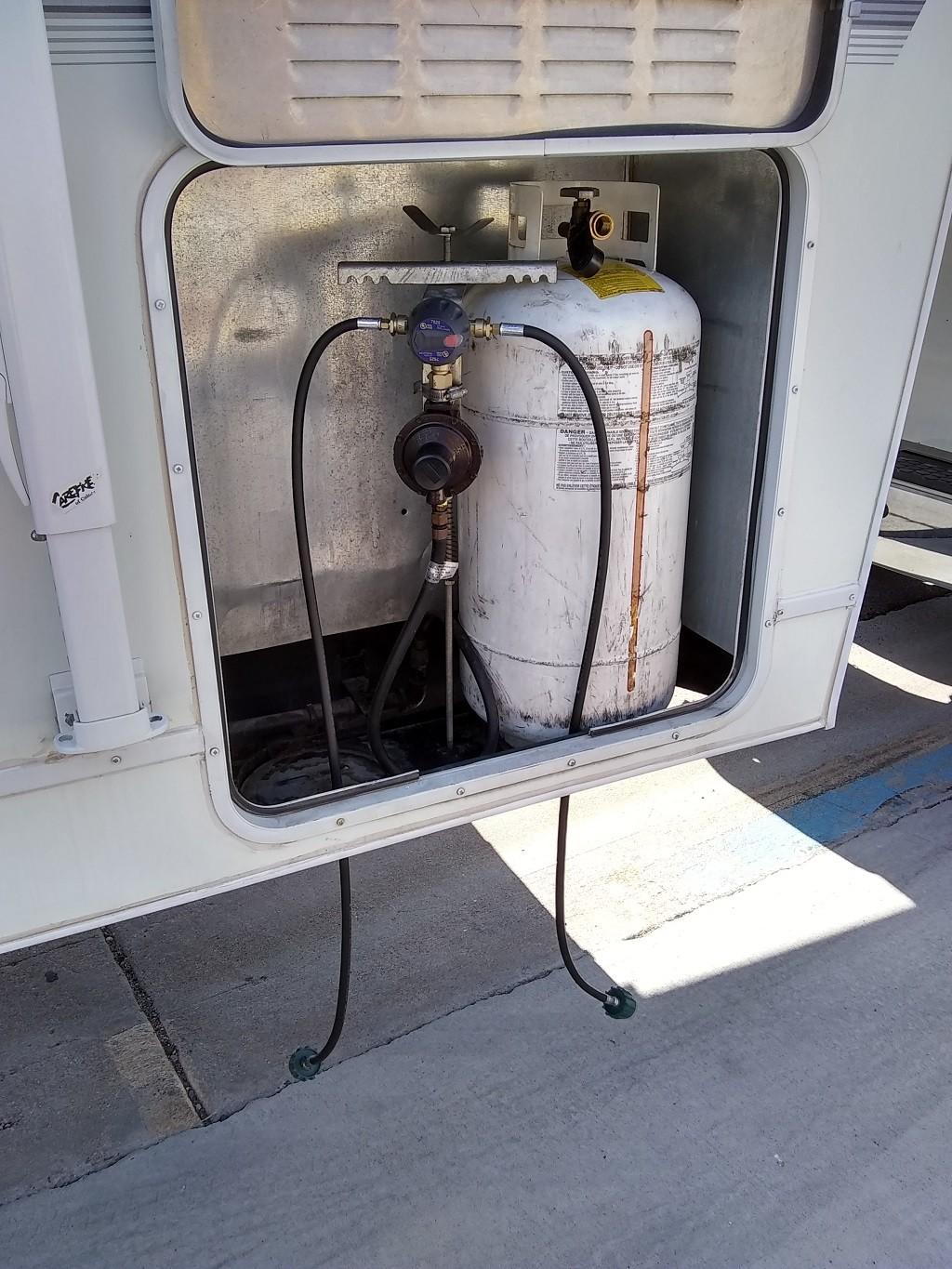

I had a leaking hose off a tank I could not find with soap bubbles but could smell. So I had the local propane outfit adjust the twin tank Rego regulator after finding and fixing the leak.
I grow tired of the troublesome non-adjustable China regulators starving the generator for fuel when they fail and got a USA made Rego unit. Your propane supplier can get the Rego stuff as it's not at the local RV shop/store. (The propane outfit reached for the Cheap China stuff till I made them order a Rego in.) The Rego on my RV been working fine since 2016. You can also get Made In USA Teeco hoses for the tanks as well.

Another maintenance item: these tanks (pictured) need to be re-certified after 12 years and then every 5 years. Shop around as some places require a new valve ~$50 and it's almost cheaper to go new esp. for 12 year vs. 5 year cert life. (One valve on my tank was leaking when turning on/off so it's not just a cash grab.)
