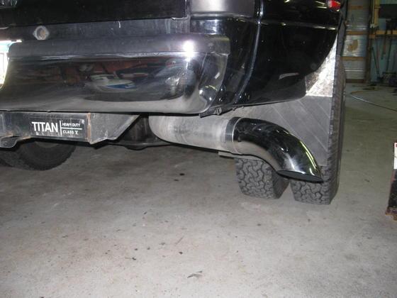

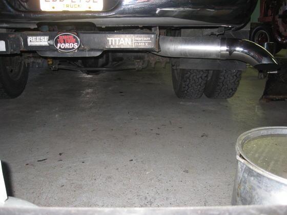

The Edge Juice w Attitude makes good power especially if you tap the pump. The exhaust wont increase power but does drop egt's quicker. If your planning on going with injectors eventually, an exhaust would be a good idea. Not neccessary with a programmer. Actually I know someone who retained the factory exhaust but removed the muffler and converter and installed a clear thru resonator. Hes running an Edge with rv 275 injectors and doesnt have any issues with egt's.
My '01 is set up just like the above truck, dyno's 335/852 with no EGT issues. In '03 the factory used 3. 5" then in '04. 5 went to 4" exhaust systems. I think 4" for higher HP is a good all around size.
