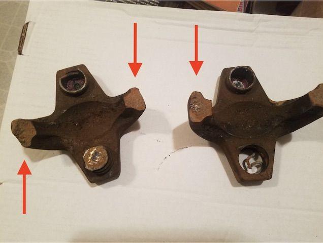

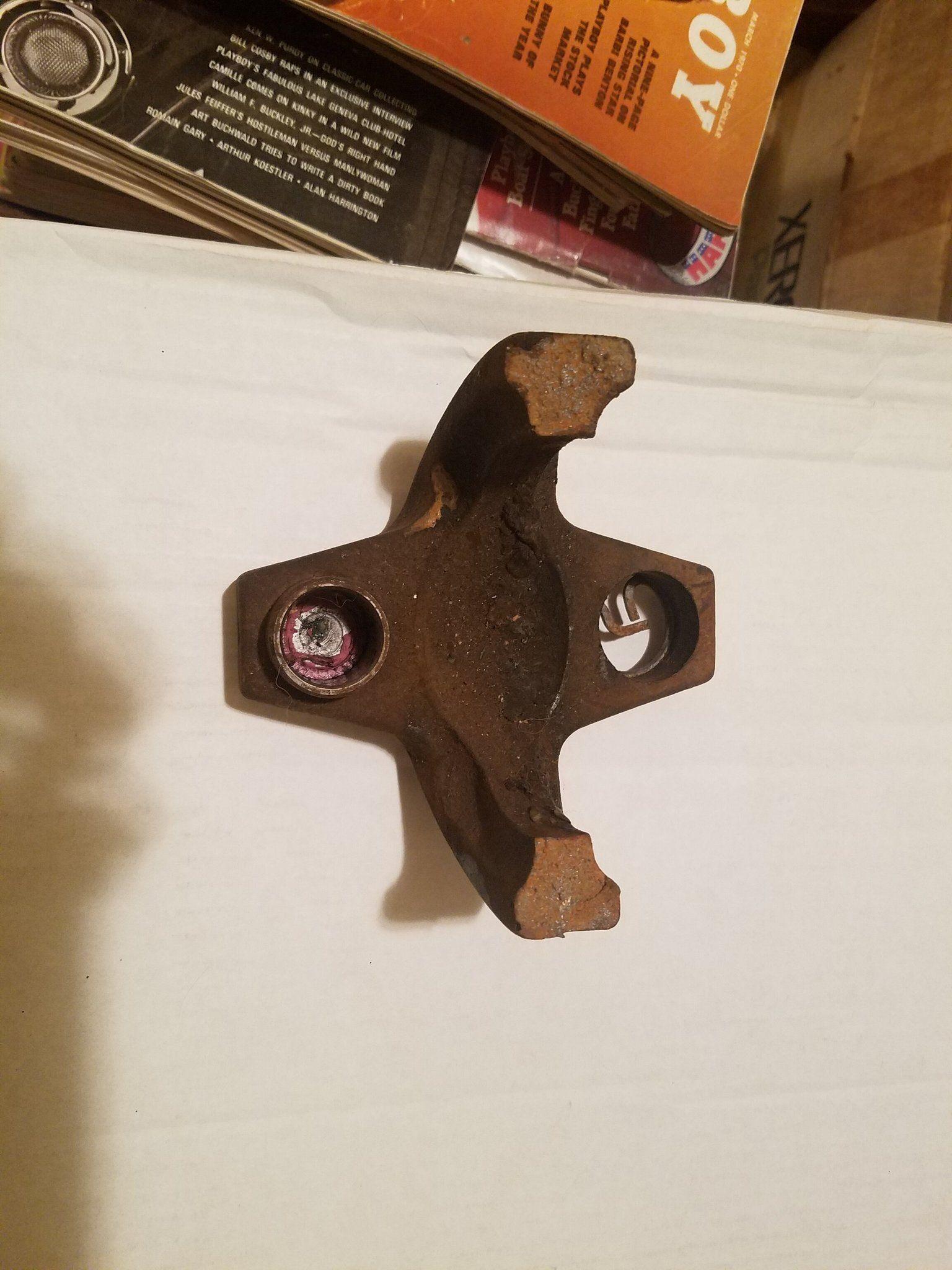

I notice that the breaks have rusted over really soon. A small amount of sheen is visible on the right portion of the joint but everything else looks like it's been sitting out in the elements for a while.

I would guess, yes. Probably was a few days after, before the pictures. That was some type of impact break. Either a joint failed and caused the bind or like OZ said the center pin broke and allowed the joints to lock up and snap. Or the OP hit a big ole rock...

The parts sat in the snow for about an hour or so. When I found them I just tossed them in the bed with my wet gloves and the factory jack I was using to try and extricate the truck from the rock it was wedged against.
That joint is immediately behind the transmission cross member; It could not be impacted by a rock.
The Yoke failed, (Snapped) BC the U-Joint Failed, it stressed the Yoke beyond its strength when trying to get it un-stuck. The U-joint failed because of corrosion to the cup bearings allowing movement and BOOM to the Joint ,Followed by BOOM to the YOKE, all this mostly happened in less than 1 Second.

You keep talking about corrosion, I don't see it. I can't tell by the pictures the sequence of events. It would help if we had all the pieces to look at. It appears the u-joint still had grease. Why did it fail? Especially in snow?
If you save the picture to PC, you will see the rust on the needle bearing surfaces, and that pink color has no value its cake hard, the chemicals suck all its lubricating value.
