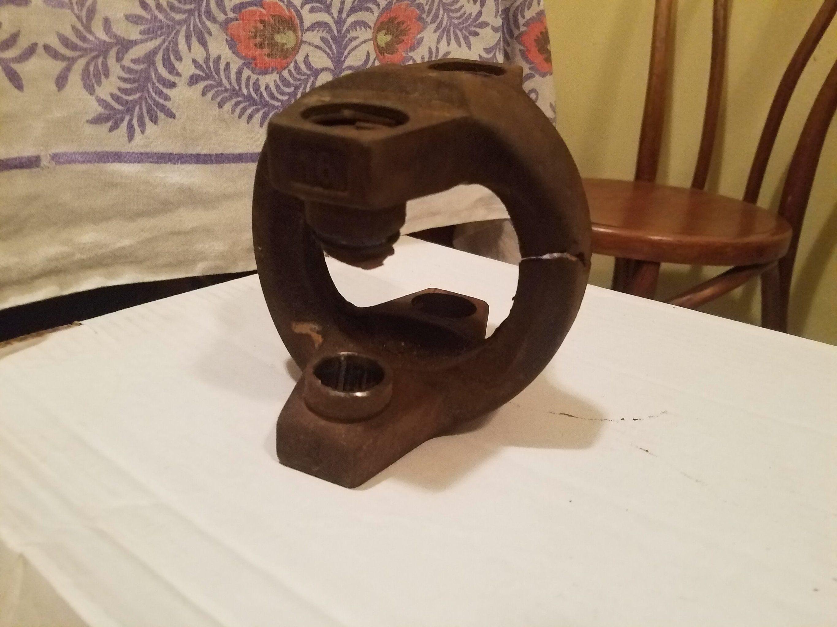

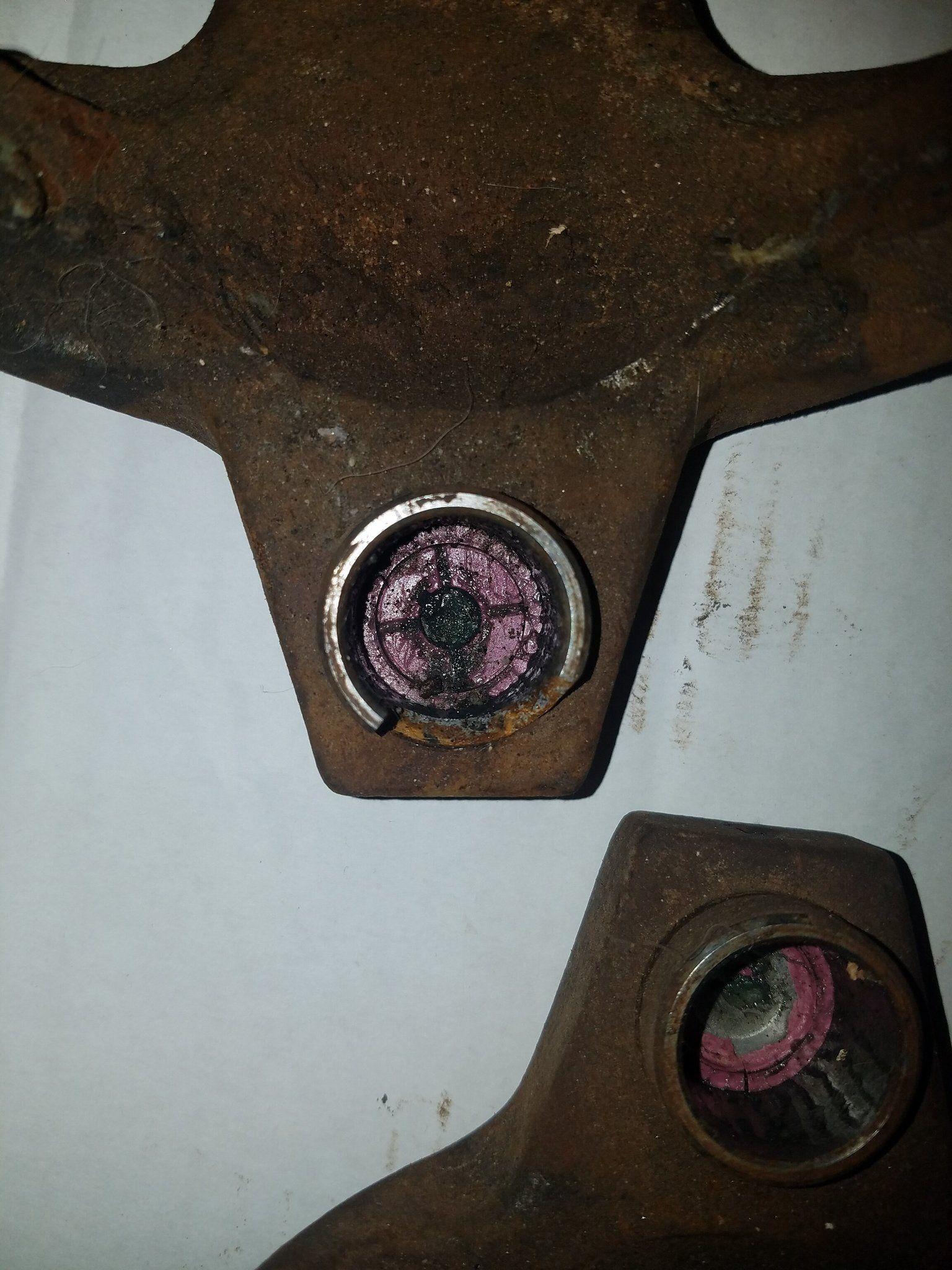

If you save the picture to PC, you will see the rust on the needle bearing surfaces, and that pink color has no value its cake hard, the chemicals suck all its lubricating value.
I think the rust is from the parts being in the snow and the back of his pickup for a few days. I would like to see the drive shaft and the u-joints. I don't know what year the truck is but only 30k miles....seems crazy....
Hopefully the OP will post MORE pictures.

The orginal owner took delivery of the truck 12/21/16 at a dealership in Utah. He traded or sold the truck to a Ford dealership in the same town on 12/13/17. I purchased the truck from that dealership on 1/17/18. I have added about 18K (trouble free) miles since I've owned it. The truck has been to dealerships for routine service 3 times (plus the tire shop for some better rubber a few months ago) while under my ownership. Maintainince is by the book. Rust did not cause this failure. The rust on broken portion is flash from being in a moist environment. The superficial oxidation on the cast surfaces of the part is not much different than black oxide. The failure was caused by inadequate design, a defective component, poor manufacturing processes, or insufficient maintenance practices. It was snowing a reasonable amount the previous evening and I drove at least 50 miles in 4 hi with no issues: the truck was smooth, no shaking, no vibration. I personally don't feel the truck was being worked hard or pushed. I had posted some more pictures of the broken components in an earlier post....I can add some more though. For the record this is not my first 4WD vehicle, doesn't mean I am an off-road master; just means I'm not a novice.
Corbet, when you get time, could you post pictures of the drive shaft and 4 bolt t-case flange? They should both still have the broken u-joints on them.

The truck, nor the driveshaft parts are not in my possession. I dropped the truck off last Wednesday. The images are ones I took before I dropped it off for what I assumed would be a easy repair.

There is no reason a driveline component should snap like that when in 4wd hi or low going over a snow-covered road, especially on a 2-3 year old truck.
I don't know much about driveline components. Is this a high fail part on Rams? Do we know what company manufactures them? Is this the first year this spec part is manufactured or is this a standard part used for multiple years. Just want to understand if there is a broad issue here. Thanks. Ron
The American Axle Mfg shaft and axle package showed up in the HD 3 gen trucks in 2003, and AFAIK, stands unchanged today. This double cardan joint has been used for decades in sealed and greasable versions from a few manufacturers. Regarding this application, I haven’t heard many complaints about the 3 gen front shaft on the TDR until recently.
I do recall problems in the distant past with weekend warrior off road guys fiddling with the double cardan but never exploding like this.
FWIW, Ford uses the same design, different mfr, in their F 250-550’s and I’ve seen F550 driveline abuse resulting in front axle damage and that double cardan lived to turn another day.
