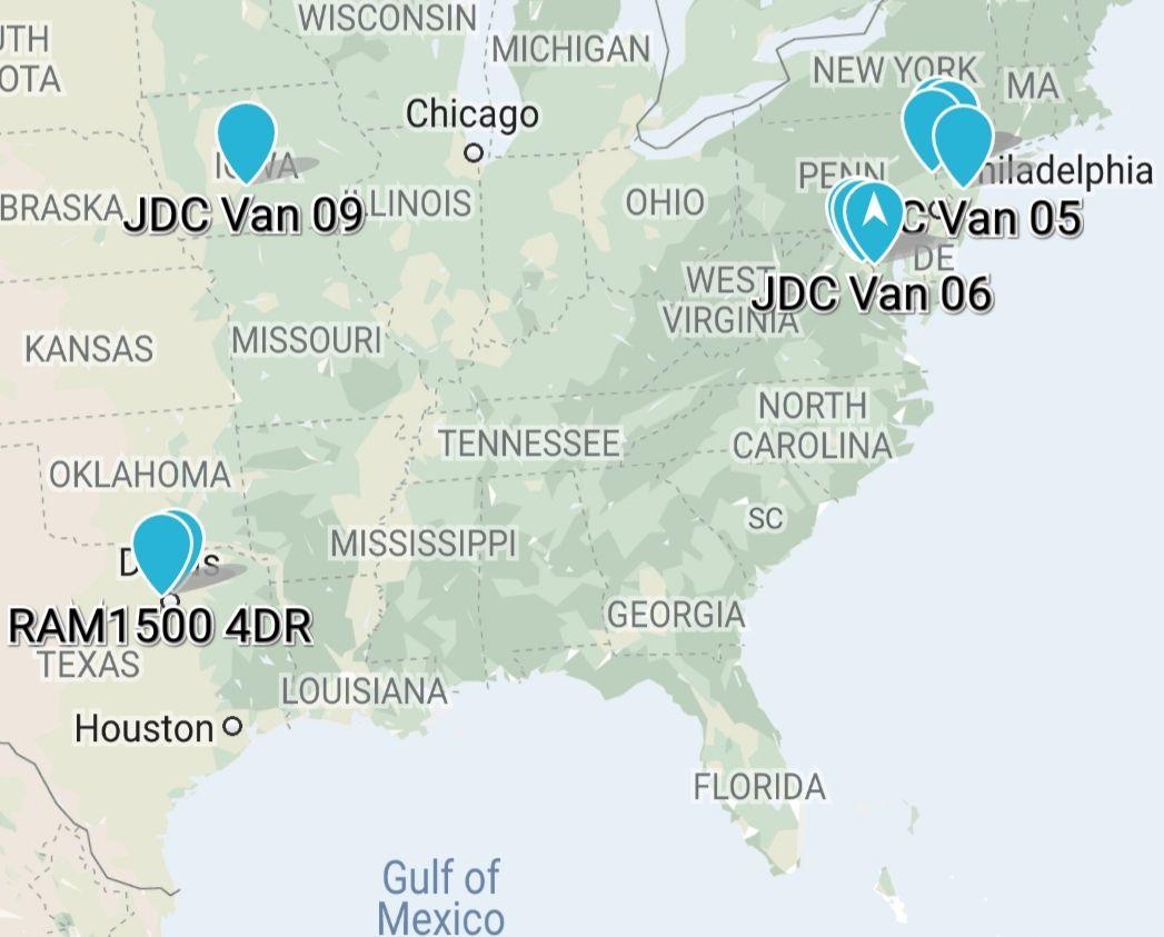

I have general tracking OBD2 cell service GPS in all my vehicles 14 total, its the same service Progressive Snap Shot is based on, it can not be used for any offical purpose, the service does own all the data and the sort, it records hard brakes, fast accellatration, top speed, maintenance, codes, diagonistic issues, so I'm all in on data recorders good or bad. The T&C of that service are pretty clearly written how its a complete invasion of privacy and if you dont like it dont buy it.
