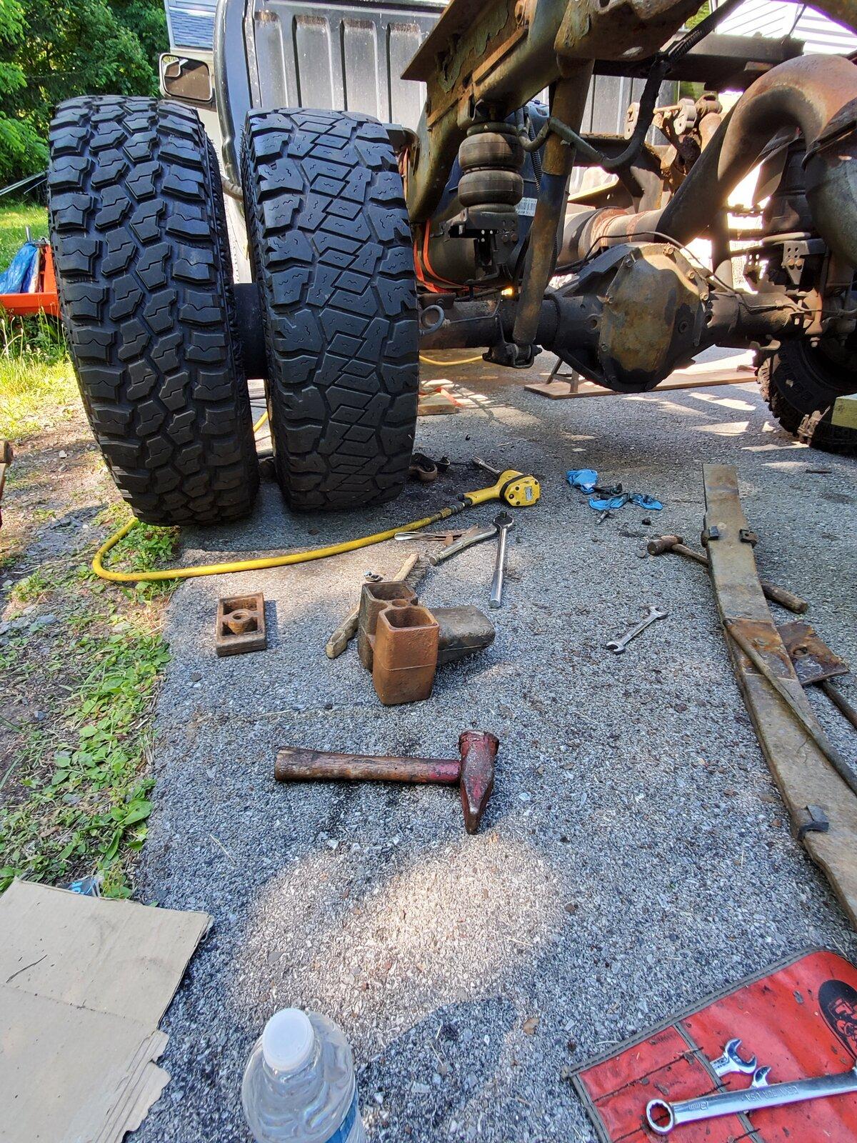

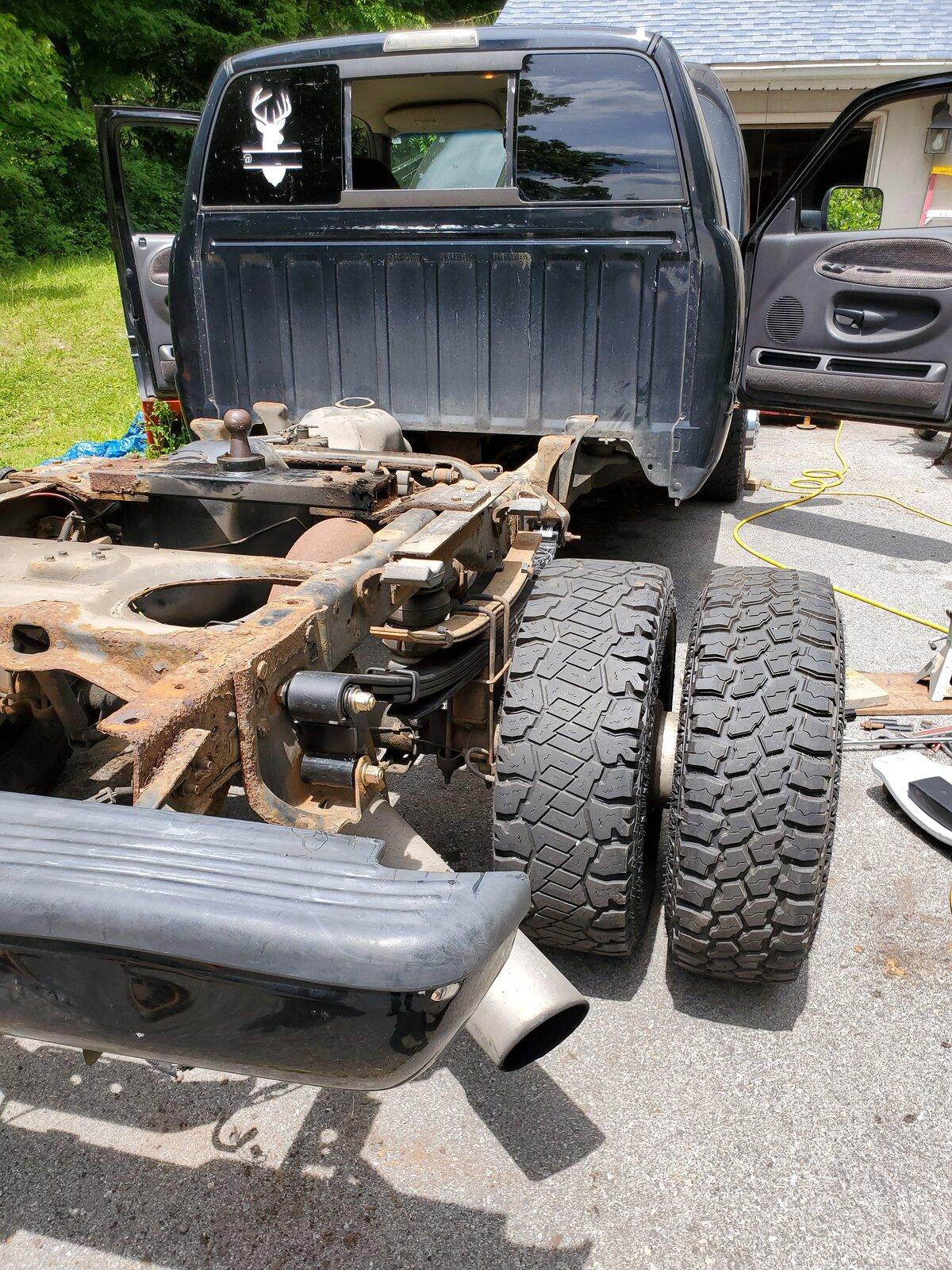

There!! Now you can get at things far
easier!!
Don’t forget to inspect your fuel lines and the rear brake line especially where it runs behind the fuel tank..

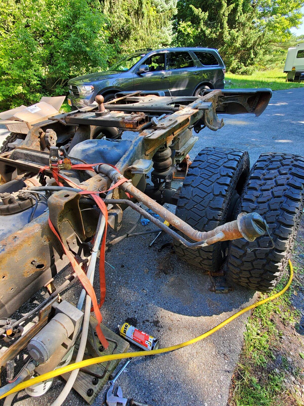

easier!!
Thanks, I will.

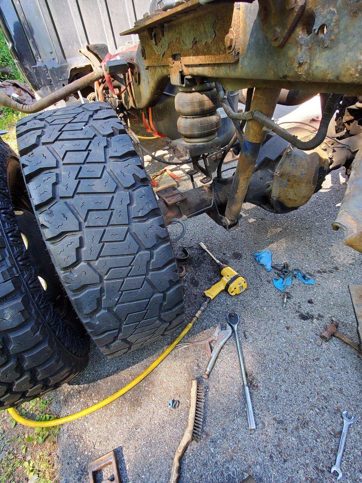

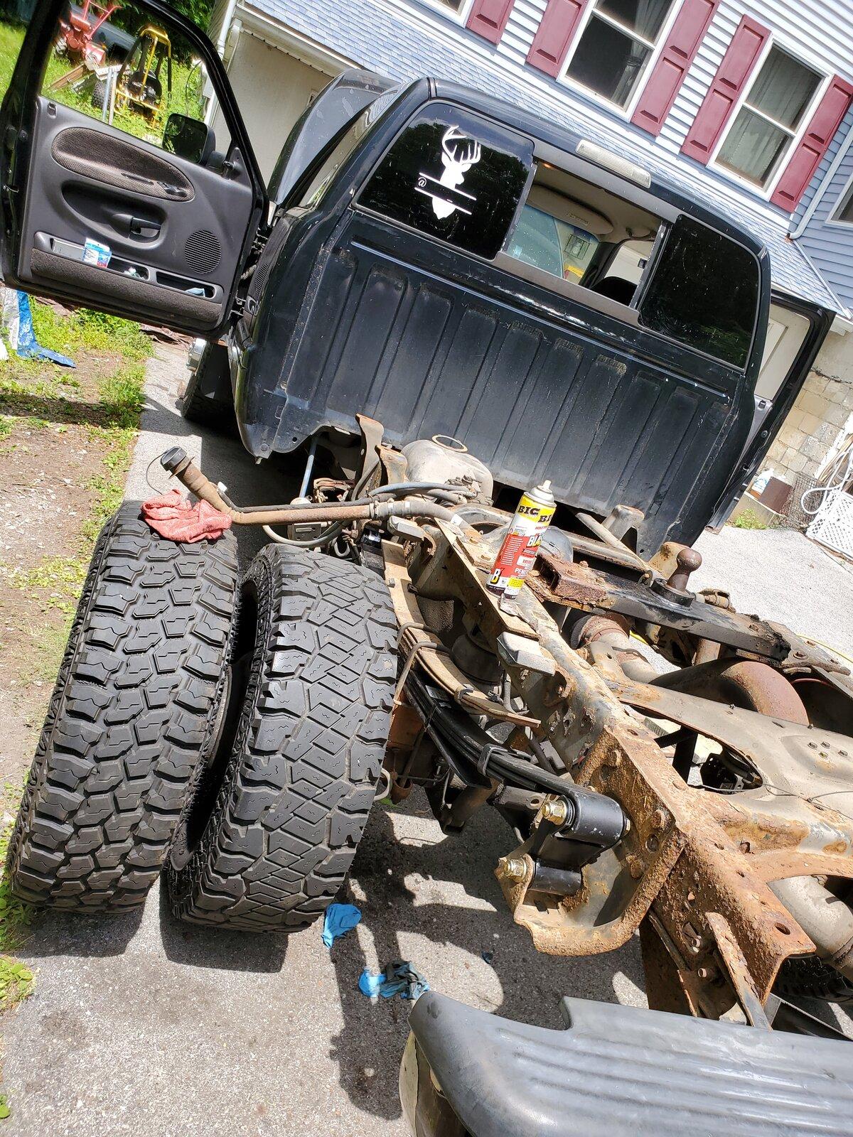

One, spring is totally off . Broke a carriage bolt for the air bags.
Looks like a war zone :D. It's always amazing how much crap you get out to do a job, then you get to put it all away.

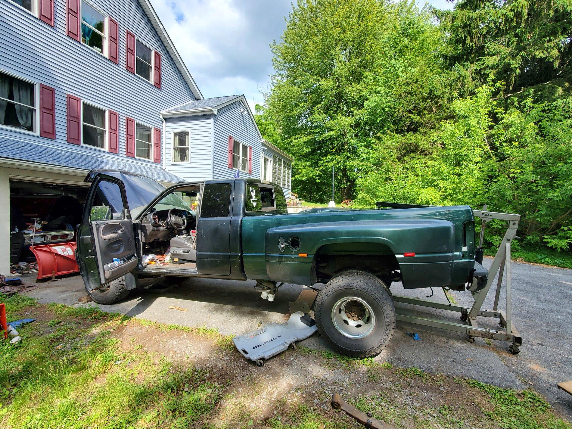

All back together now.
Thanks for the help.
Bed doesn't match now but its almost rust free.
Biggest problem I think was trying to get the blue ox goose neck ball out of the hitch mount.

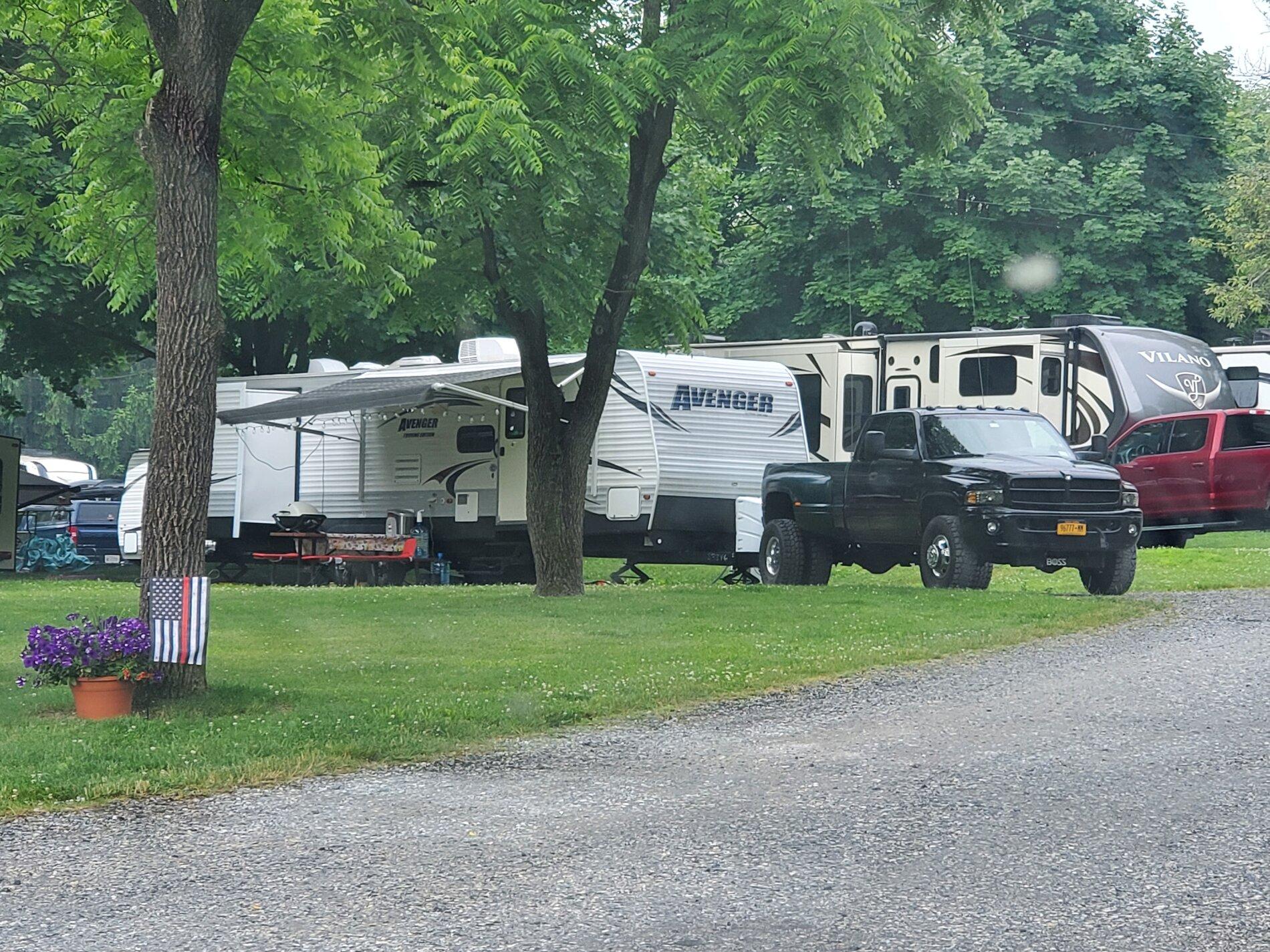

Wife would be real upset if I couldn't pull the camper.
We have had to ,or had to many things canceled this year due to covid.
This will be the first time pulling this camper, and first time pulling with this truck.
Since it's your 1st time pulling with this truck don't forget to pay close attention to your fuel psi, egts, and trans temp (if auto, I forget) for a while till you're sure all is good. Enjoy.
