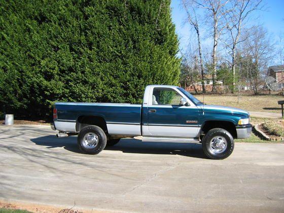

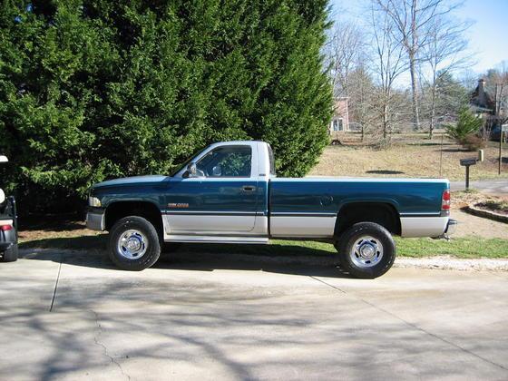

Nice paint, by the way. Clean looking ride. I like it... .
