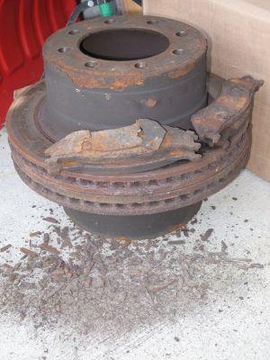

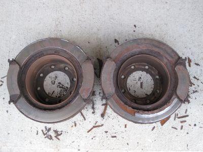

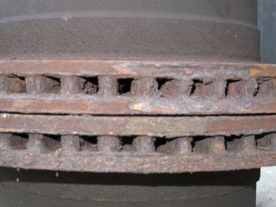

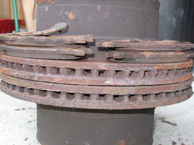

Here in Ottawa, Canada, our cars have to suffer through 4 months of road salt every winter. The life of brake parts may be more determined by corrosion than wear. As depicted in the photos below, both the OEM rear rotors and pads were severely corroded. I recently replaced them with Centric high carbon rotors and EBC Greenstuff 6000 pads. I had to use a small sledge hammer to get the rotors off. The pounding created piles of rusty flakes. The Centric rotors have an E-coating on all non-friction surfaces. I’ll see how they hold up to salt in the upcoming winters. If your rotor’s friction surfaces have continuous rust, the calipers are probably no longer sliding on the sleeves. I’ve learned over the years to clean and re-grease the front sleeves every two years and the rear sleeves every year.

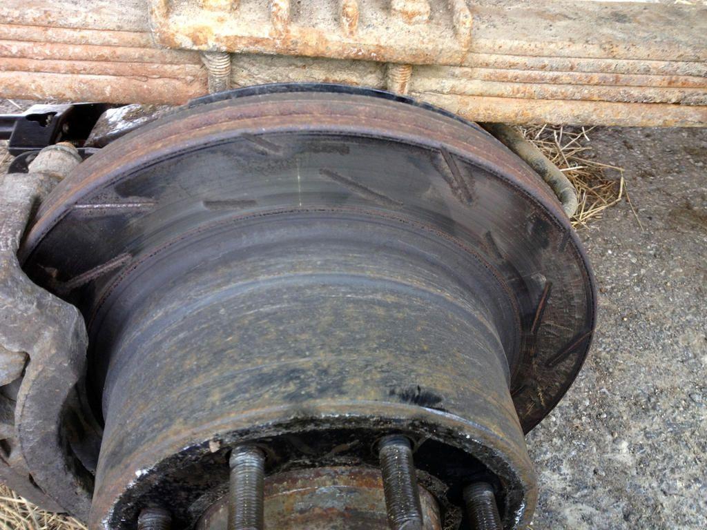

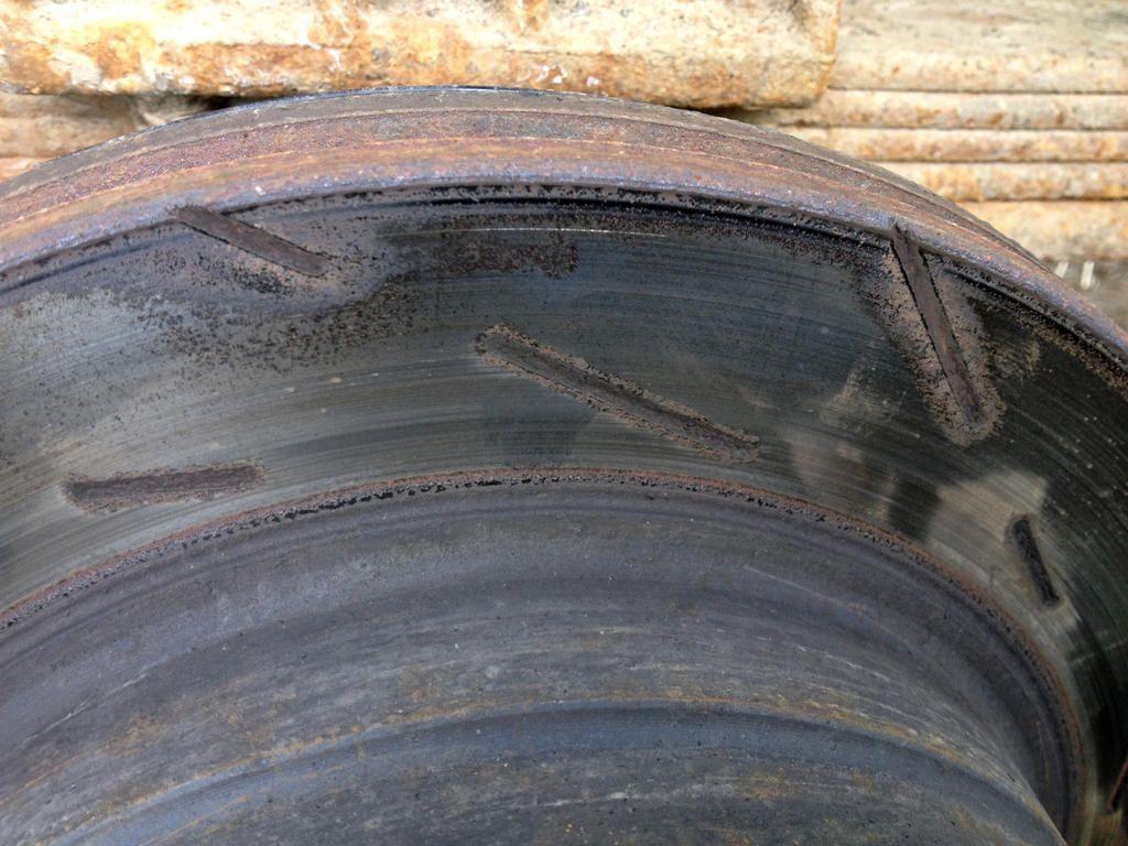

Update: When changing out my studded mud tires this week, I figured I would take some pictures of how my EBC rotors are doing. No rust scale yet, but there is some rust around all the slots. Maybe it will come off with harder brake use and more driving? These pictures were taken on April 18, 2016. The rotors were installed August 1, 2015. Less than a year and they have some rust. Not real impressed considering they are almost twice the money. Even the black coating down the centers is starting to rust.
