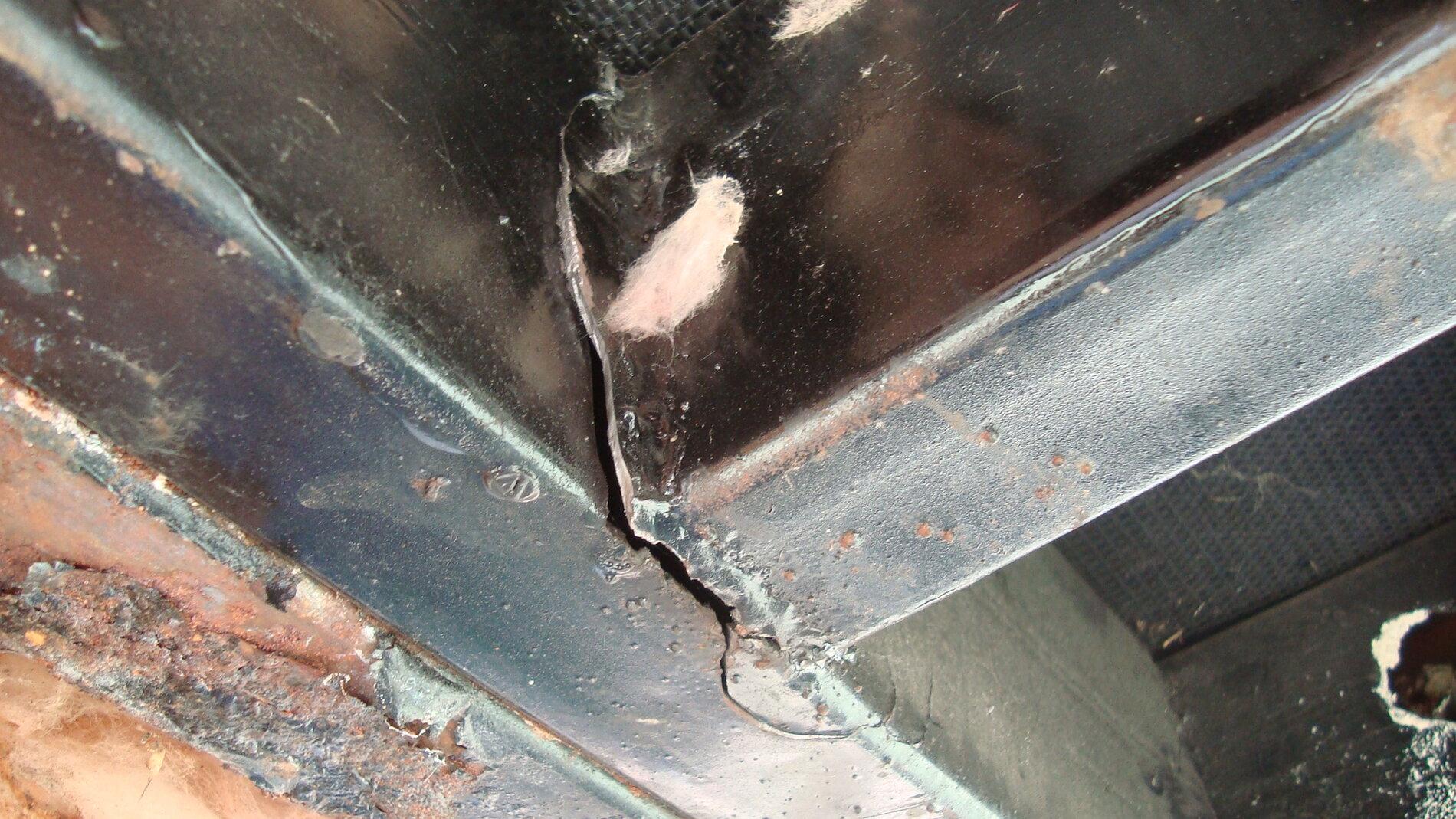

go over my ownership story too. It is because of Games reply with his experience with his 5th wheel frame fiasco that I am replying

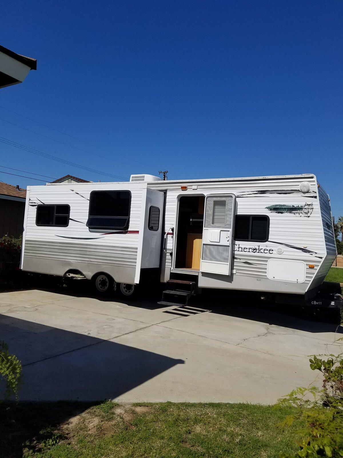

Ram 2500 2WD 5.7. Towed directly on the ball hitch. After the 5th season we found that the floor dry rotted. Next, bought a used 2008
Forest River Cherokee 25KS double slide in 2009. The tongue weight was a heavy 1200 lbs. It was a perfect match for our new 2008 CTD.
The next nine seasons had no issues except for the early "China Bomb" blowouts. Everything worked fine. Nice and solid towing.

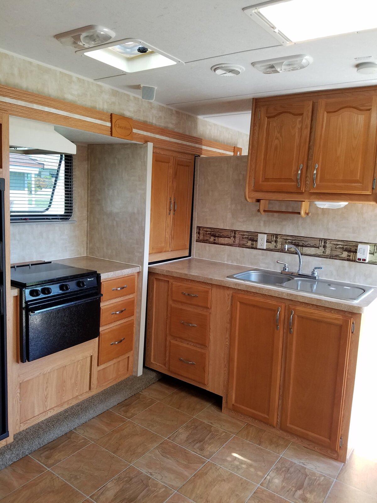

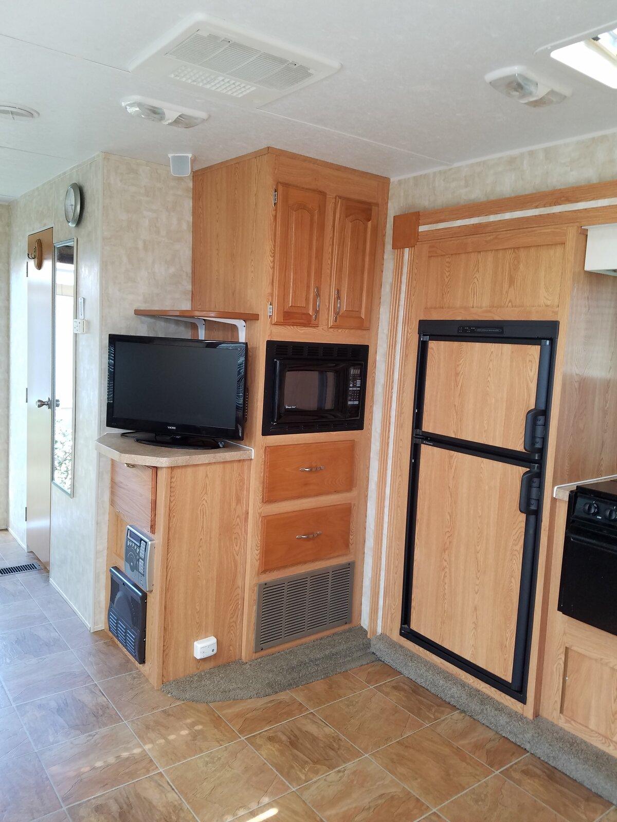

It was time to plan retiring and to keep the shop open long enough to finance one last trailer. We were real picky shopping and we
found a trailer with a floorplan and features better that our elegant Cherokee. We then bought a 2018 Winnebago 27RBDS. We
didn't buy because of the name brand but only because of the floorplan and features. Towing home from the dealer revealed the first issue.

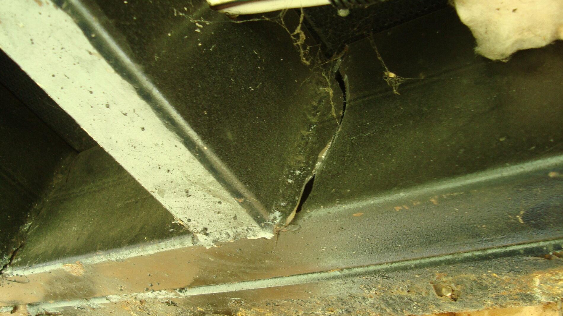

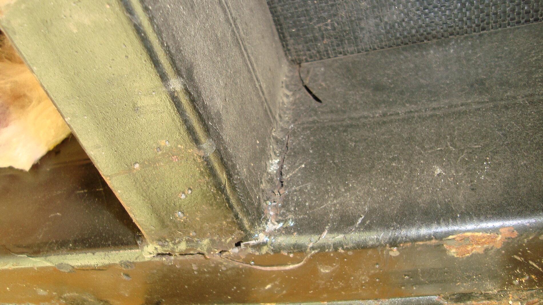

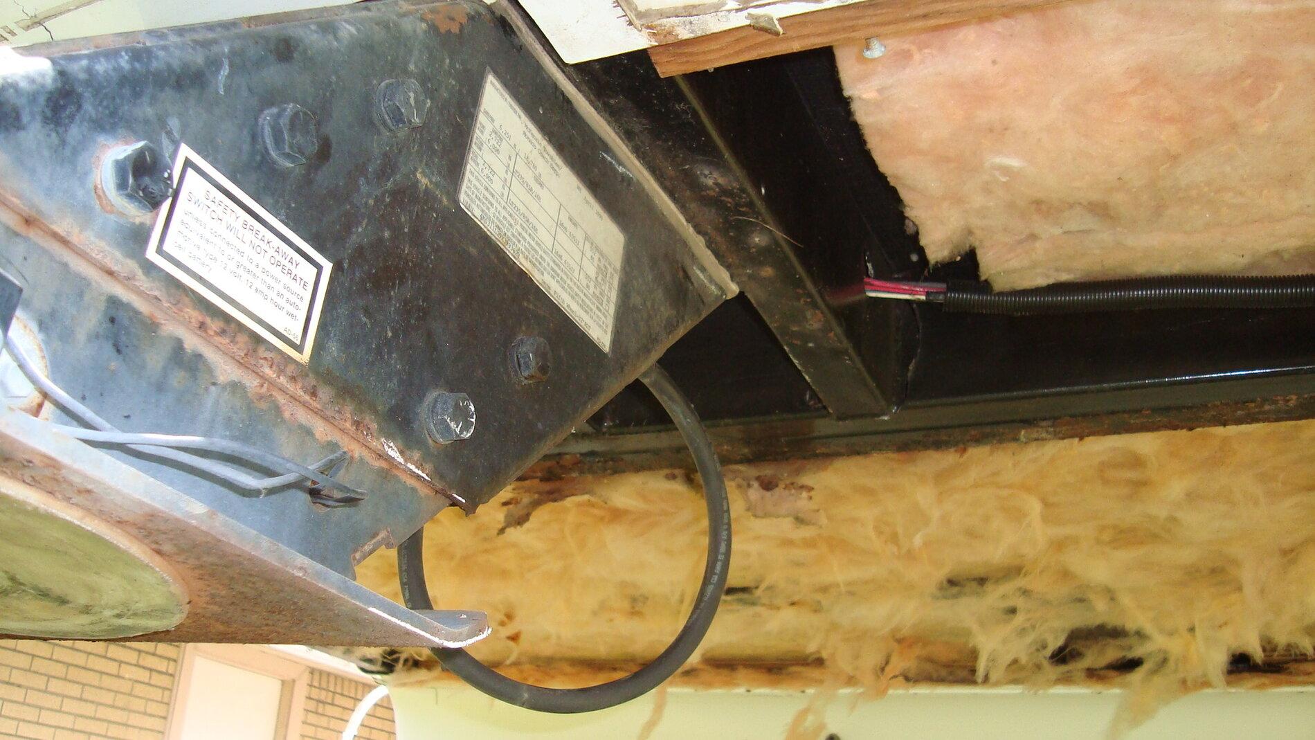

The first towing season traveling over rough roads caused the A frame to bend up about 1.5". We would arrive at the campsite
with the range hood partially hanging down, window valence screws pulled out, under sink drain plumbing loose and window
blinds coming loose. This is from the A frame acting like a spring and porpoiseing. Winnebago said it was from road hazard
and denied warranty. I never thought to look for frame integrity when shopping. I assumed all trailers had frames designed
to compliment the trailer. The Cherokee had a 2X8 A frame and the Winnebago has a 2X5 A frame made by BAL from Norco
Industries. We are looking to still have the A frame reinforced some time to control the bobbing up and down.
