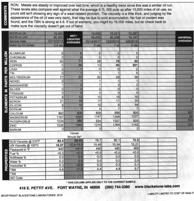

I used to do this till the "on sale" Royal Purple spiked the copper so high on the UOA it wasn't funny. Your engine gets used to an additive package so it's best to stock up when the oil of your choice goes on sale. Oils may be "all good" on their own, but, mixing them up all the time sure messes with UOA results. YMMV if it makes 10 miles of extra engine life or not.

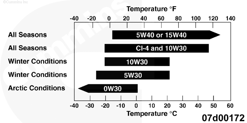

Cummins, not Ram/FCA/Dodge, has allowed a 10w-30 in the ISB for at least a decade. I can't tell you about earlier as I've only had my truck 11 years and it's been allowed the whole time. The kicker is that it must have a High-Temp/High-Sheer of 3.5 cSt if it's CI-4 or newer, unless it's only used in the winter... so it's much easier for OEM's to just allow 15w-40 and 5w-40 than to say 5w-30 is okay with certain parameters which generally aren't published on the bottle.
Remember 10w-30 was around as winter oil before 5w-40 was.
This is from the ISB service and maintenance manual found on quickserve.

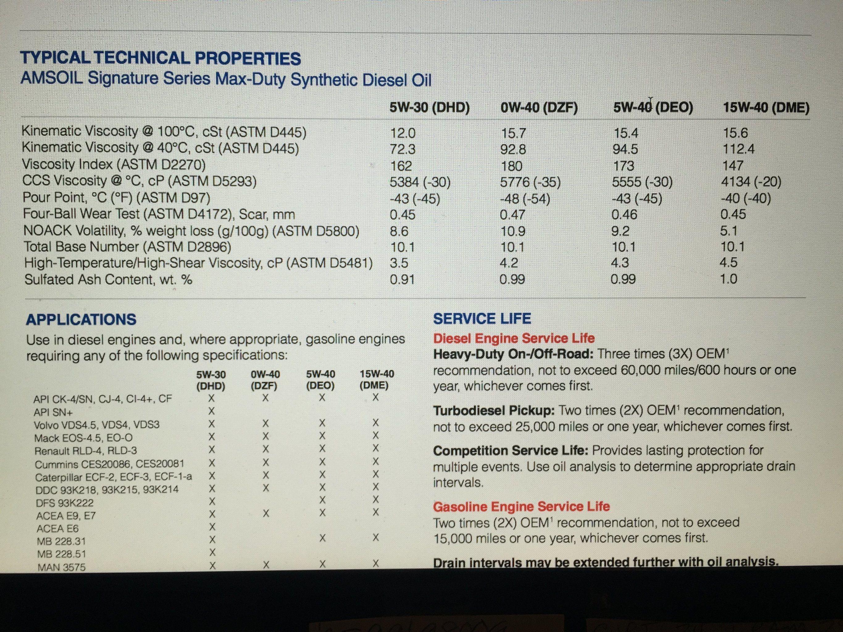

I usually run Amsoil HDD 5w30 after initial oil analysis came back as excellent; doesn't do as well as AME 15w40 in some engines though.
Finally decided to try some CK4 oil last month, been running the 0w40 DZF for the past several weeks.
