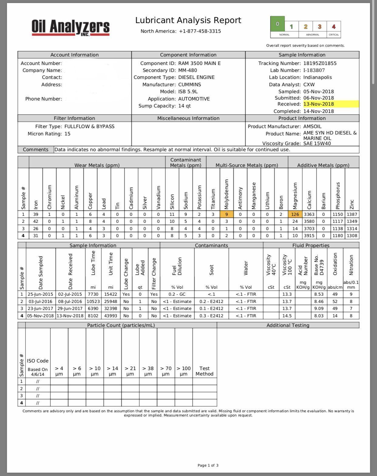

I am more than happy with my FULL 15k oil reports. AMZ/OIL 15-40 FULL Synthetic.
I just switched to DME 15w-40 from AME 15w-40. I like some of the DME specs better, but going away from CI was not an easy choice.
Your UOA’s did help the decision, despite my dislike of black stone
