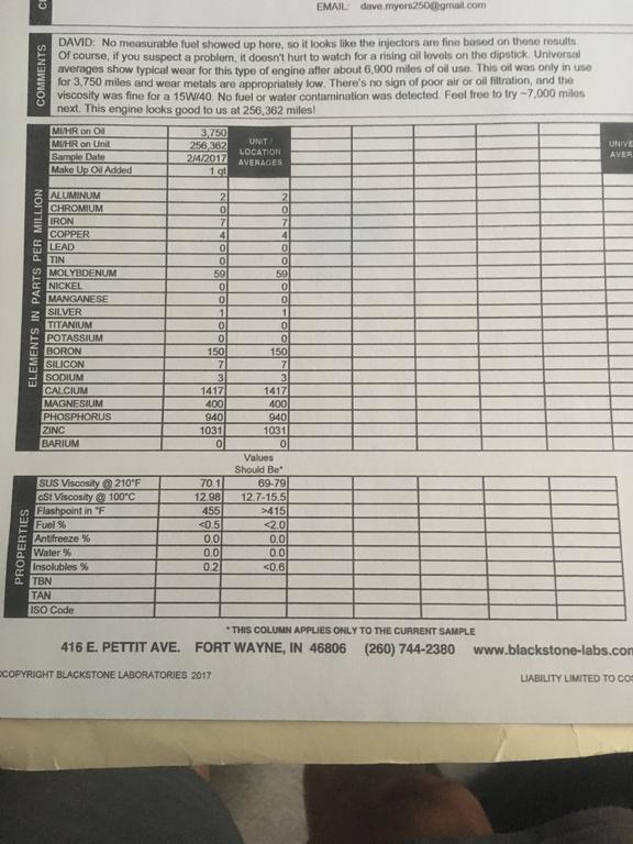

Here was my last Blackstone oil analysis at ~256,000mi just for comparison.

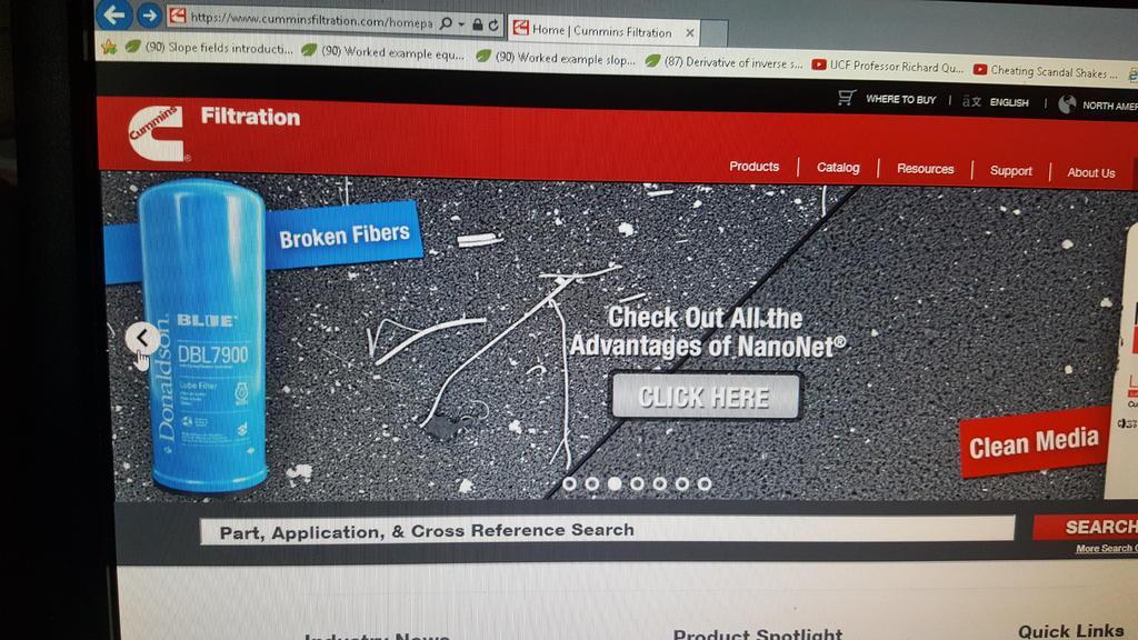

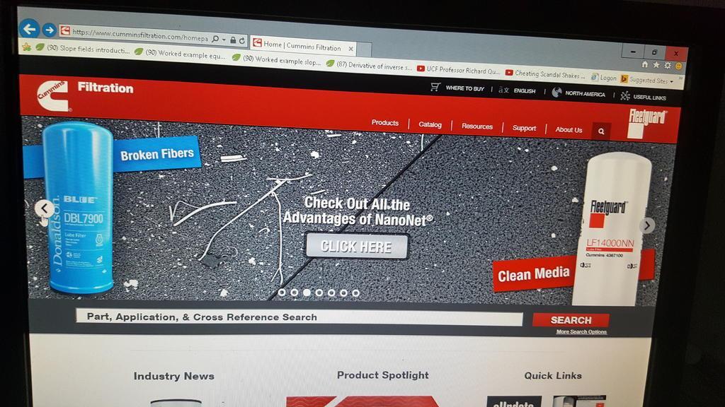

I don't know if it's accurate. But see this graphic on the cummins filtration website. Use the filter that doesn't void warranty while on warranty.
Better safe than sorry.
