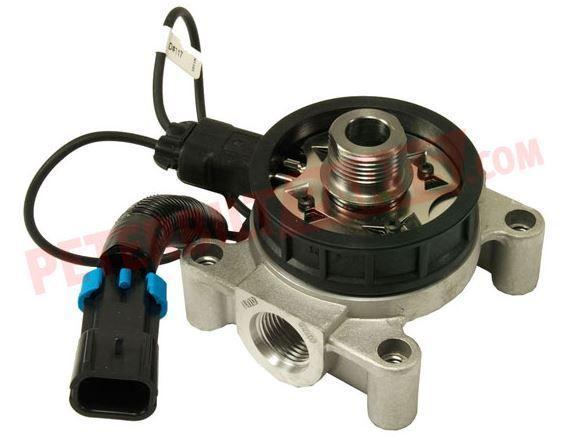

Hmm... I was hoping that was the case. The stock sensor in the canister will set off the WIF light if your B20 is enabled, but that's not your problem.
You just raised another question because they said that the B 20 was enabled but my stock sensor is back in. So my water in fuel light should be on right now with the stock sensor if the B 20 is actually enabled. I'm thinking I should call the dealership back and have them do a little bit of homework.
I understand the latest revision to this kit requires a special filter. I think Fleetguard head w/heater #3930335S is a 1-14 thread head that should provide flexibility with filters, and quite sure the mounting pattern fits.
