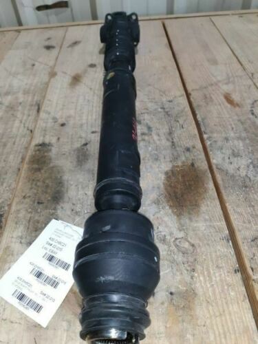

My 22 does not have the standard double cardan, just a flexible rubber boot, like on a c/v joint. Probably does the same thing.
It does turn by hand with the truck stationary. When it was turning with the truck moving, it was less than 5 mph. Must have been trying to overcome the drag in the system, most likely will quite turning at higher speeds.
There should be a flexible rubber boot on the axle end to allow the shaft to change size with suspension articulation. Is that the boot you’re talking about?

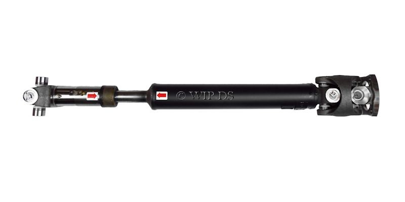

I think he was talking about this type front drive shaft on the t-case end. Not the boot covered, splined, slider end at the dif.
Not this type.
Correct, mine looks like the one in the picture on the top. Not sure what type of joint the boot is covering. Anyone know if it is a c/v type joint?
Absolutely, it's a normal CV joint for high RPM applications.

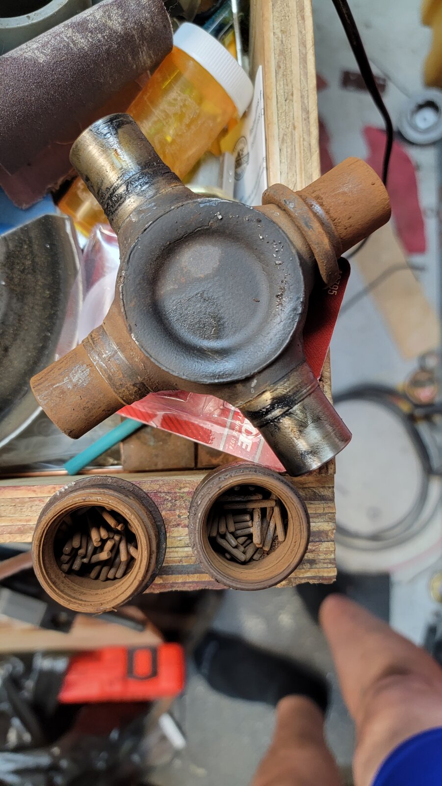

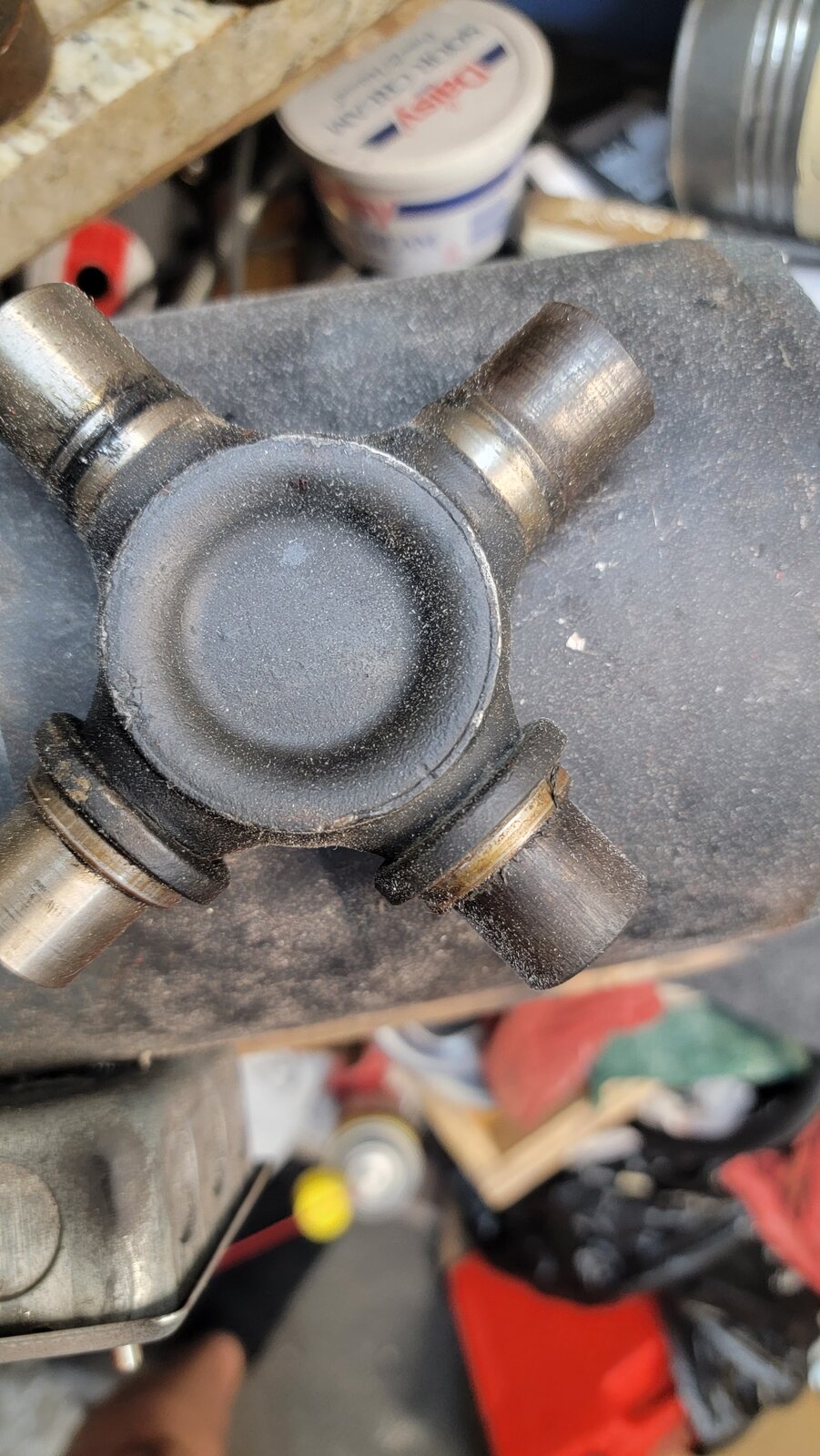

Pictures of the u-joints. Worst side was on the passengers side! I was shocked about the passengers side @ 163K! Should be the last time for those! :D
the rusty side got water in there some how. wonder if the seals were bad from the get go. ive seen brand new sealed joints bad on a couple fords. if theres any greasr flinging out then somethings wrong at the seal. 163k still aint bad
