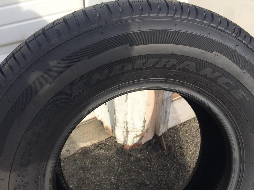

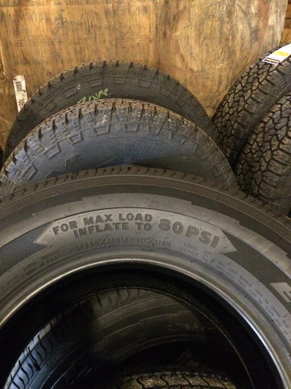

I've got a set of the Marathon 15" Load Range "E" tires coming this afternoon. Will take a look, post a few pictures, etc....Still undecided.
The beauty of working at a place where tires are sold, I can send them back if I don't like them.....:D
They are here. Walked all the way out there and left my phone on the desk....
I'll get pictures later today.....They are stamped "Made In USA" and "Load Range E".....
