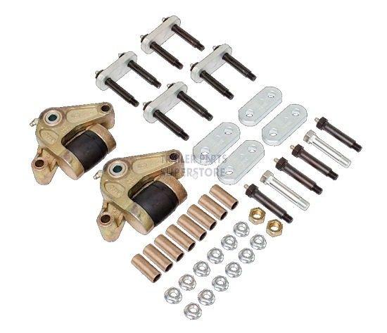

I did this kit on my last trailer and never had to deal with elongated holes in the little flatbar hangers, bolt wear, stupid little plastic bushings etc. for the life of the trailer. I just greased them twice a year or so and never did anything else. Just installed the same system on my trailer that I bought last year this spring when I added the third axle to it. I can't testify to what ride difference the trailer gets, but the lack of wear on bushings and bolts etc. is worth every penny to me.

One more thing, my friend had the eqalizers with the rubber shock absorber in it, installed on his trailer and seems to think that the trailer runs smoother, now. He mentioned that the canned goods and other things have not moved around the cabinets like they normally would have on the same trip. He also had new shocks installed so, that may have had some effect, also. He has the same equalizer's that are in the picture's posted on this link. He felt the money was well spent & worthwhile.
