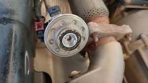

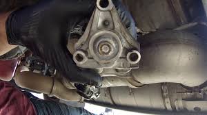

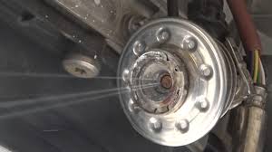

The crystals you see there are more than likely caused by the DEF evaporating as it left the injector, or dribbling out of the injector when the engine was shut off and the water evaporated in the heat of the SCR CAT. The other cause could be debris stuck in the injector and then it clogs and the spray pattern is not correct. That in turn leads to more crystallization as the water evaporates and more crystals are left behind. But even debris in the system should be trapped by the filters and screens.
If it was caused by the Urea falling out of solution, it should be caught by one of the filters or screens before it reaches the injector.
All of the situations shown could be cleaned up by soaking in water if someone took the time to do it. The injectors can also be cleaned by soaking in water, but most dealers/shops will just want to throw parts at it. See the TDR issue 102 page 104 for some additional background on DEF faults.
