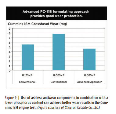

Illustration above from Chevron (Delo) website demonstrating phos content related to wear. .12%, .08% (max allowable to carry API SN) and .08% phos content combined with ashless (non phos) antiwear components.

I should have better clarified this chart.
Phos is the main element limited by API in zddp. It has long been proven that above 1500 ppm (.015%) zddp becomes corrosive in the long term so 1200 ppm give or take has generally been the cutoff for oil manufacturers (excluding break in oils). This goes all the way back to API SH early 1990's. As Chevron has proved with their testing engineers have been able to produce better AW additives that offer better protection than the .12% limit that has been in oil formulas for the last 25+ years.

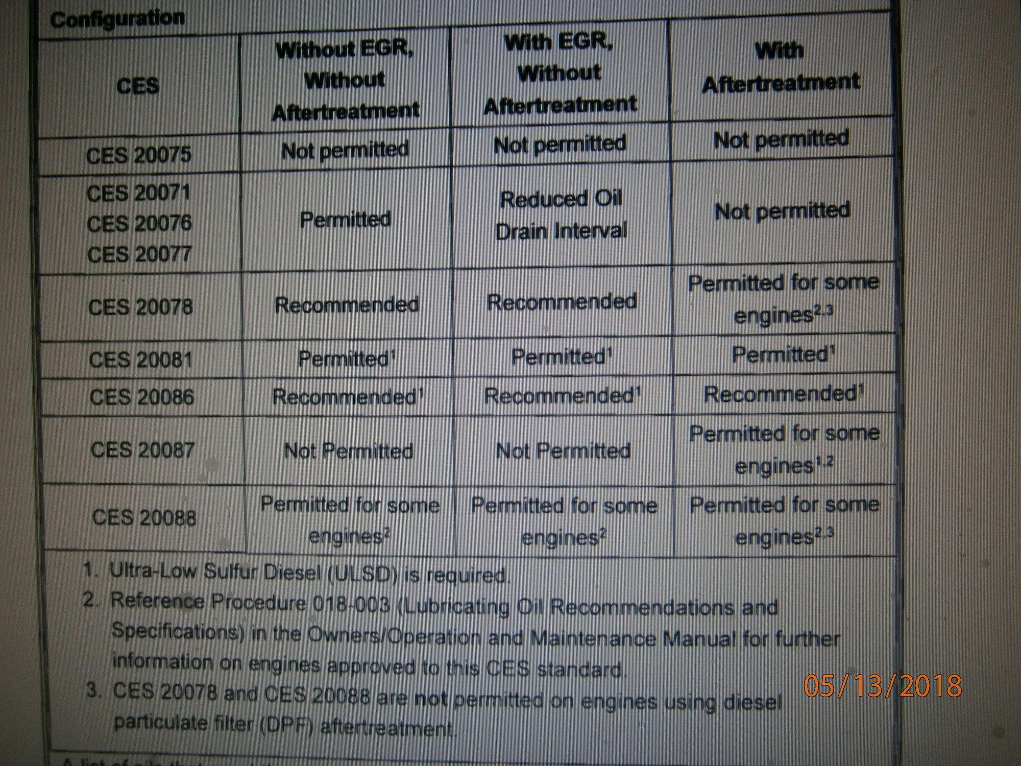

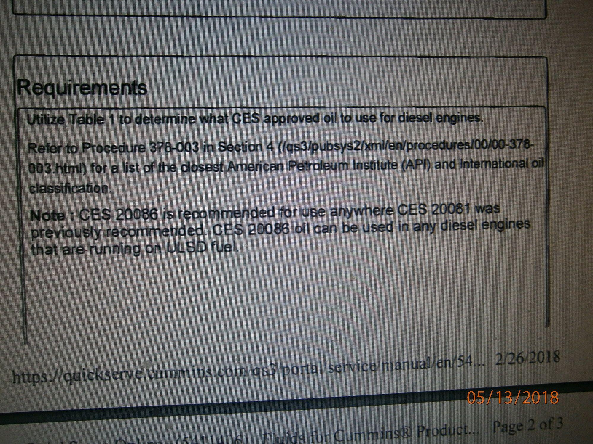

Cummins now recommends CK4 in place of CI4 for the older engines. see if you can read this.. from Quickserve Fluids for Cummins Products
