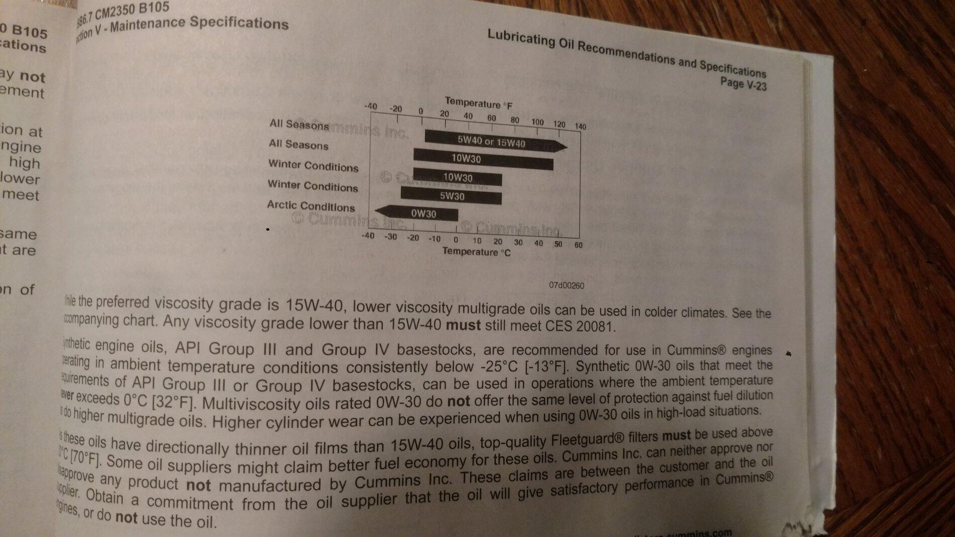

Rams recommendations come from Cummins.
After posting this I started second guessing myself, so I dug out my 2017 ISB/QSB6.7 manual. The temperature/viscosity recommendations are indeed a little different. I'm pretty sure i posted this on here when I first got it but haven't looked at it in some time and it had slipped my mind. Notice it says synthetic is recommended if ambient temperature is CONSISTENTLY below -13*F.
