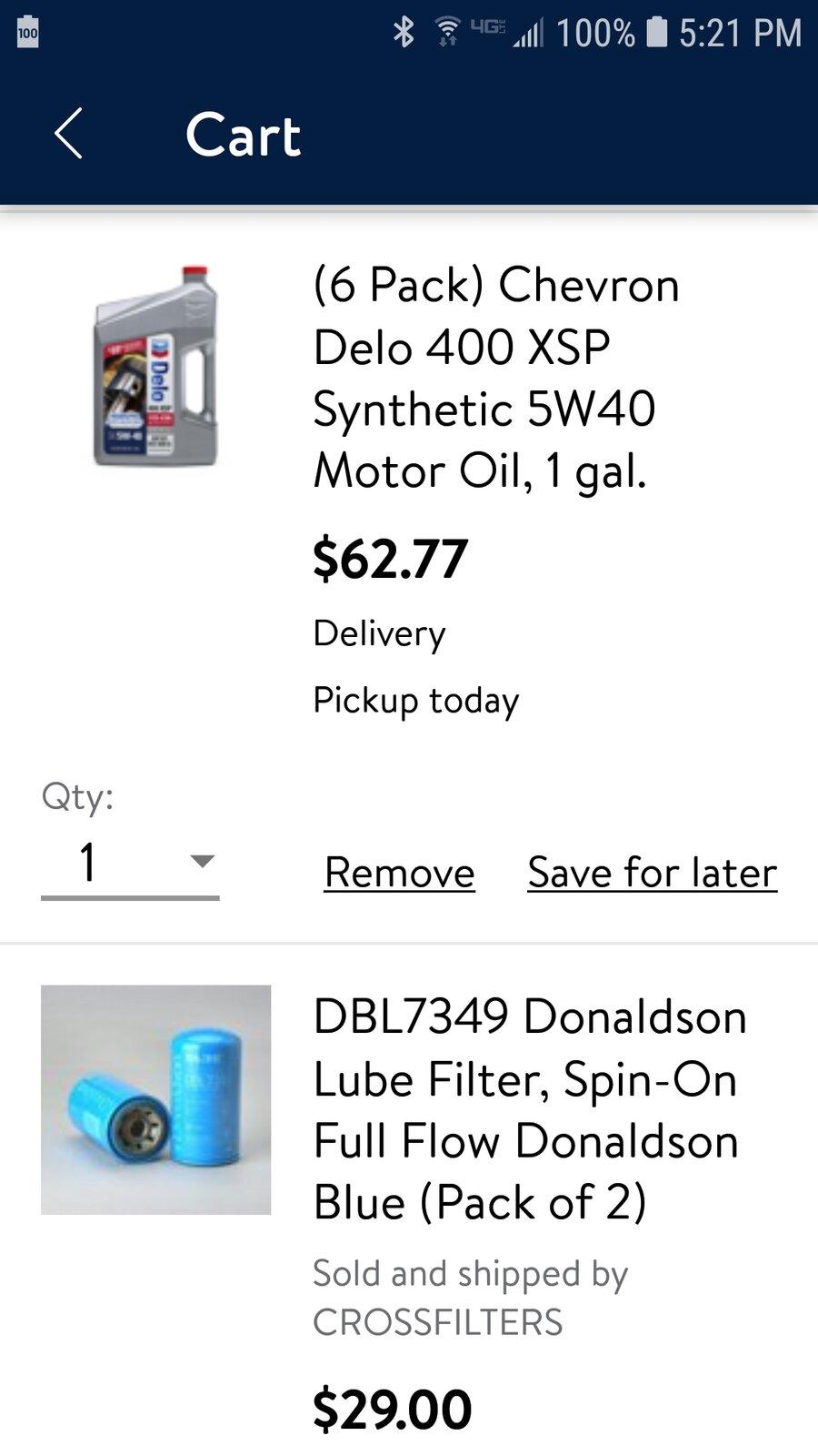

Holy snapping arseholes batman, one gallon cost more than my whole oil change!!!
Me bad, minus the filter. But I still have $57.00 left over compared to scamsoil and a filter oil change. LOLUsing public school math and your published photo your oil change is not less than one gallon of DME.
But, but but, if you're not spending roughly $111.00 per oil change your not allowed to play. LOL.But mine is

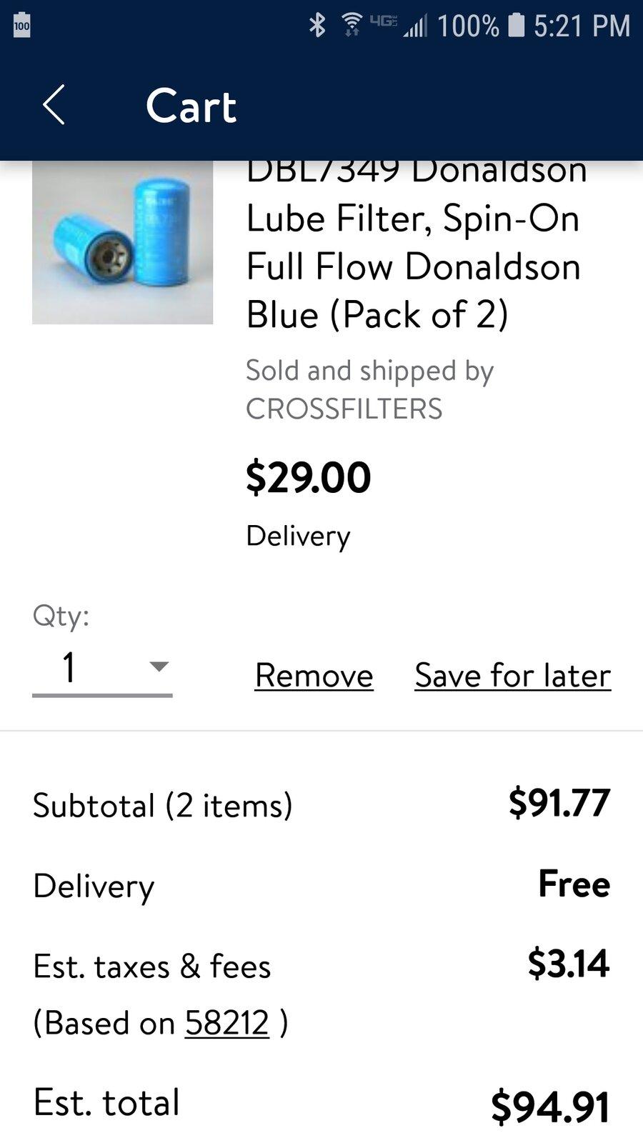

I showed them for your pleasure and your comparison.I thought the cellulose filters were fine??? Why spend your hard earned money on the Donaldson Blue?
But you get yours at a discount from your sons business. So not really a creditable post from you, honest yes, but sneaky.If I did the 10-40 and AMZ/OIL filter it would cost me around $96 without tax.
