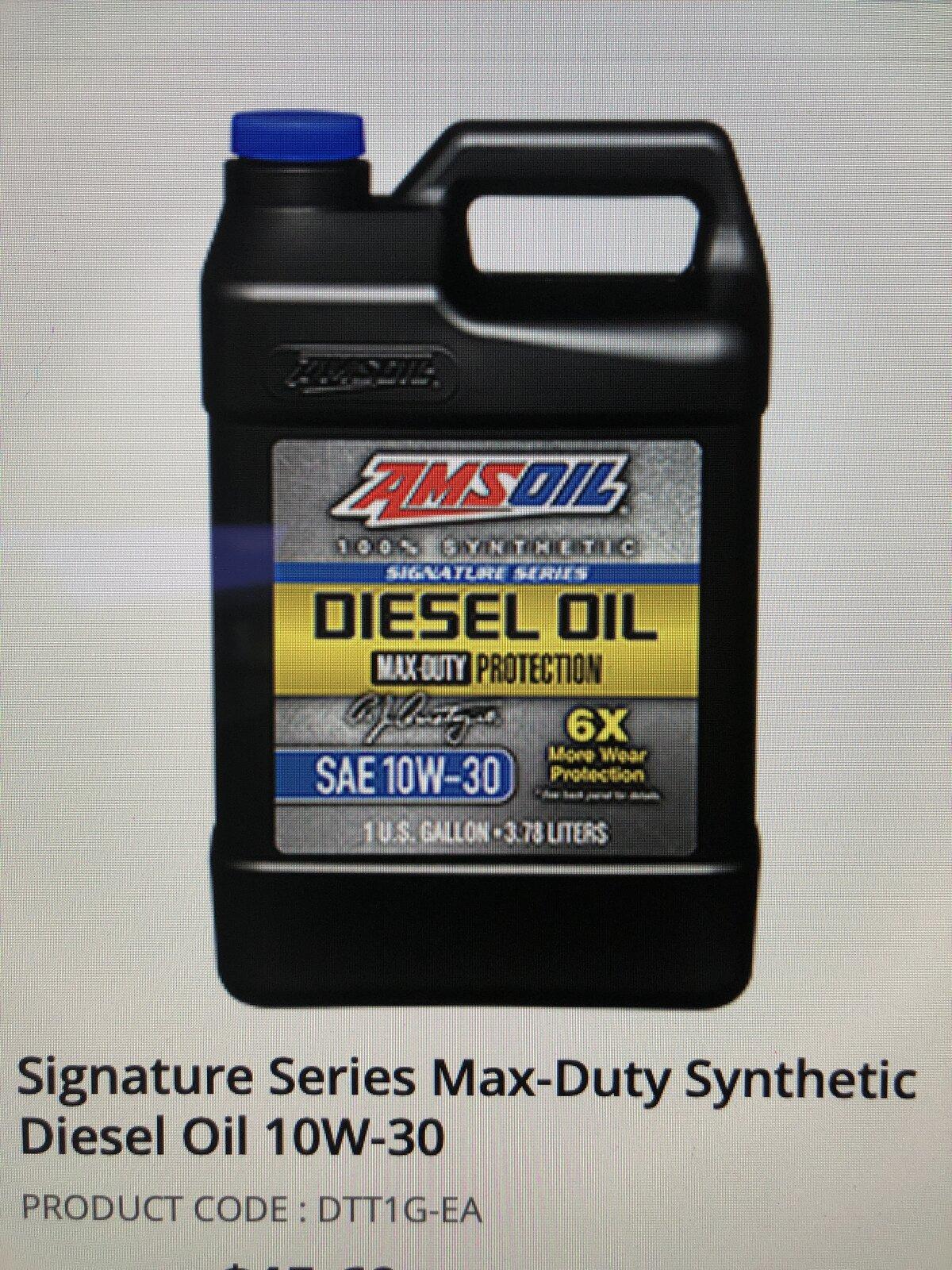

$10 Delivery makes is 31.99 for one and about $76 or $27/gal for 3 assuming it isn't $10/gallon shipping. Decent price but not $22/gal.
They sell it in the store for the same price....$22/gallon. Wife bought it for me on the last oil change as I refuse to go to WM. LOL
I also have bought it in Walmart off the shelf. It is not always there but when I start getting close to oil change time within a few k miles when I am in I look for it. I have been able to get it but not always on the first try. Not that I have searched everywhere for it but Walmart is the only place locally that I have ever found it on the shelf.
order from Walmart and have it delivered...pretty simple...same price as in store...or at least it was on my last purchase.
But 10w-30 is. Makes me wonder if it’s emissions/economy based or if the redesigned motor really doesn’t need a 40wt.
The low temp recommendation is still 5w-40 thou.
My pure speculation with a smidgeon of mechanical knowledge is because of the faster pump up of the hydraulic lifters. Which would also play into the 5w for cold weather startups.
What's not speculation is a 15w40 or 5w40 is not as robust as a 10w30 and will shear down to 30w. The more polymers in an oil the less robust to stay in weight.
Somewhere around 2000-2004 and newer cummins engines did just fine on 10w30. International/navistar not so much.
The 40w since around 2004 in my opinion is still just a left over from years past when the only widely available diesel engine oil was 40w.
I'd wager a big part of why the ISB specd 15w40 for so long was due to the lube boundary requirements of the flat tappets. Alot of their larger engines have been running 10w30 for around a decade now, I'd not be concerned about running it if they recommend it.
